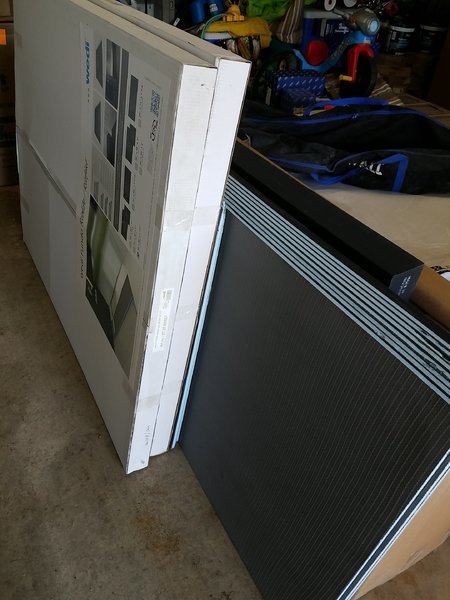

    Yeah we don't do much over any decking, so no where to seal, it's insulation then metal in commercial.
    And I fing love wedi right now

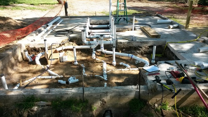

    Had to do some cheating due to depth.
    Did combination waste/vent for showers.
