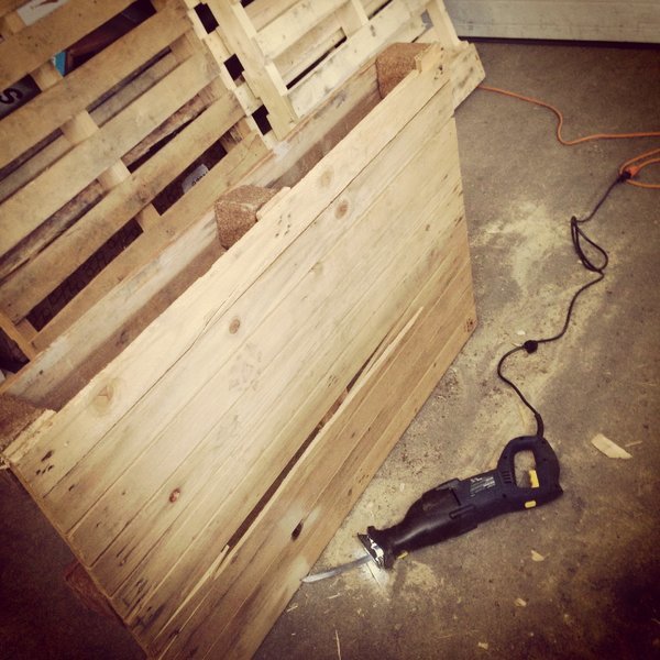

    You sir, do amazing work! The wall is absolutely awesome, and the windows are a great piece. I like the old with the new look, no sense in trashing something prefectly good. I have a queation though, how do you tear apart the pallets? They are such a PITA, and sawzall blades aren't cheap.

    Since I like to keep the look of the nails in the wood, best way to tear down pallets I've found is to stand it on end, with the boards running parallel and the 2x4 vertical to the ground and start from the top with a sawzall demo blade. I can tear a pallet down in 1 minute. Ive also used the same blade for probably 50 pallets.

    Swazall, keep the nails depending on the project! The wall we did wouldn't look the same without them.
