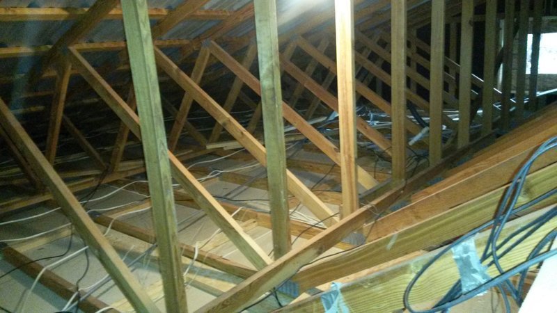

    Attic guy finished cleaning.
    Electrician found more damaged wires in attic.
    Called one last local ac company for estimate. Surprised to see a female show up. Glad I called. She knew more than the guys from 2 previous companies that gave estimate. She drew up the house with windows, foam attic, true north, etc etc. Even pointed out not enough intake. Only half.
    Look forward to estimate next week.

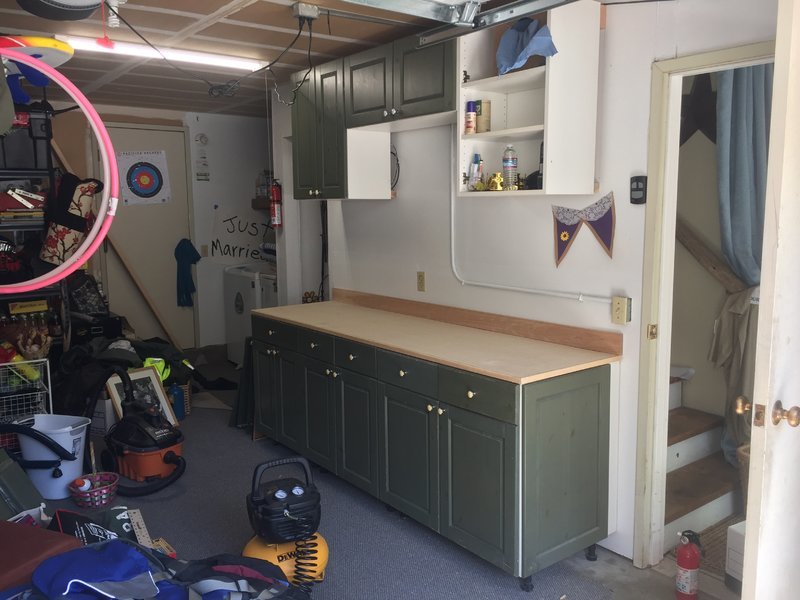

    Upgraded the man/toy/tool/kid/hangout/hideout/project/storage.... oh wait, I mean GARAGE! First time hanging/installing cabinets. Made the birch counter top myself. Pretty stoked.IMG_5443.jpg

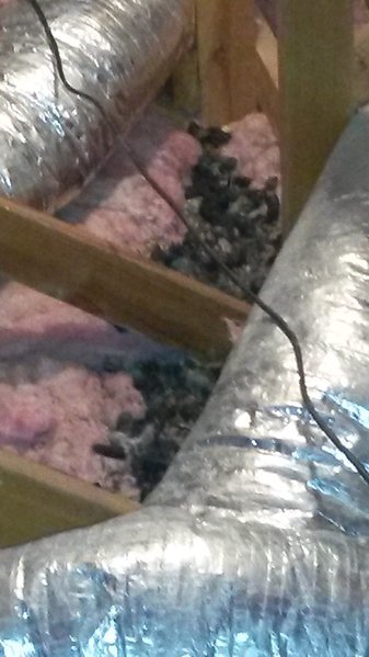

    Okay. Imagine an attic with fiberglass batt insulation with coon shit and piss all over. Ac ducts tore out etc.
    And now....
