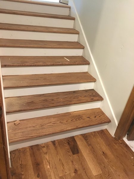

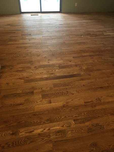

    Update on our floor progress. Lower level is stained, main floor and upstairs being stained today. Then the seal coats go on this weekend. Color is Duraseal Early American (red oak floors). For the sealer we are using Glitsa Conversion Varnish.
