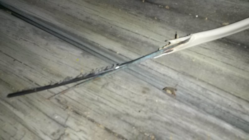

    I hate raccoons:annoyed:
    :infantry:

    I didn't have electrical issues with coons... but this weekend one fat mother hauled off with a brand new full loaf of sourdough bread and I was less than 5, FIVE! feet away. Bastard was in stealth mode, snuck up and ran like hell.

    Well if mom would've moved into house she bought more than 10 years ago she would've heard the coons partying with the local slutty possums and squirrels in the attic.
