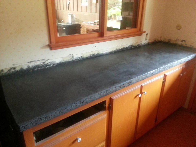

    They are remote shut offs for the water lines in the laundry box

    i'd wager that weighs quite a bit! ...do you do any reinforcement to the cabinetry?

    Not much more than stone

    It was just shy of 4 80lbs bags of concrete. I'd guess around 275-300 lbs. Works out to about 21 lbs per square foot. It's a solid cabinet. 3cm granite is about 20 lbs per square foot.

    That's thinking. I hate having to pull a washer cause ya can't see behind it. I plumbed my wash box higher than washer.

    This is a fairly standard rough in kit meant for when you put a side by side W/D under a countertop , can't remember the brand name off hand , if I do I'll post it up
