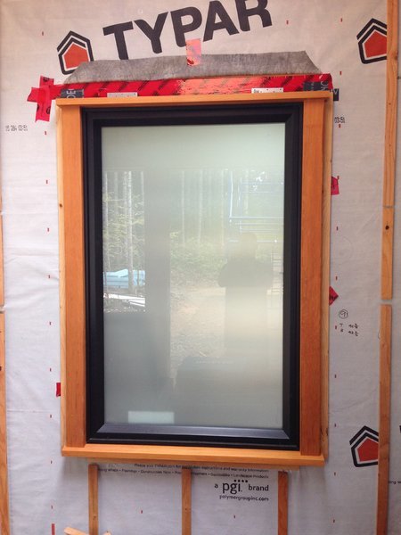

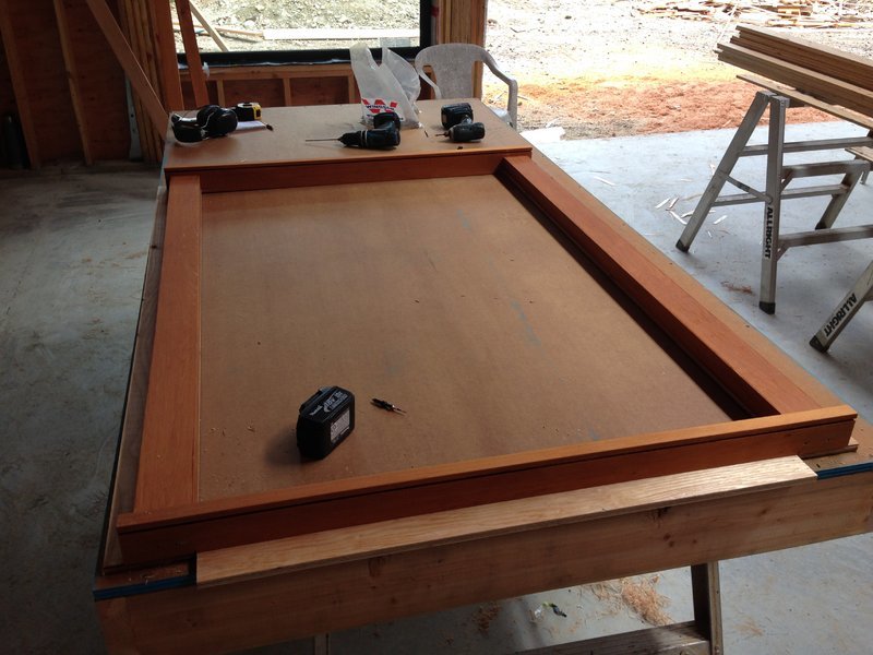

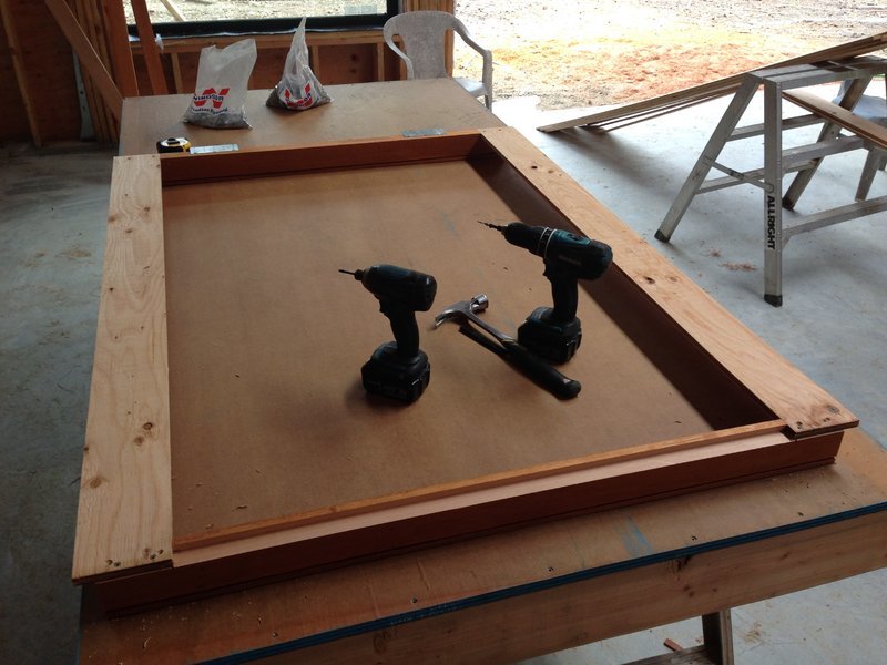

    Started to install exterior window trims today
    Decided to make them up as units for each window on an assembly table and then fix them to the wall around their respective locations
    I wanted to avoid any visible fasteners so this is the system I came up with
    When we applied the rainscreen strips we intentionally left them back on the sides and bottom of each window rough opening to accomodate this trim installation method
    After the top and bottom trims were cut to length , we rabbeted the bottom trim to accept a piece of 1/2" plywood so it could be screwed flush to the back of the trim , and it would protrude about 2" below the underside of the trim
    We also notched the horns of the top and bottom trims that project beyond the window unit to accept a 1/2" plywood strip . The top and bottom window trims extend 3 1/2" beyond the width of the window .
    We ripped 1/2" plywood for the sides at 4 1/2" and I cut them to length for each window by measuring the window unit height and adding 3 1/8" ( window unit height + 1 9/16" (top trim thickness) + 1 9/16" (bottom trim thickness)
    We screwed the 4 1/2" side plywood pieces in flush to the tops and bottoms and tight to the 3 1/2" notches in the horns
    So what we end up with is a trim box that is the correct height to push over the window with 4 1/2" plywood strips set to the width of the window opening
    Back side (bottom plywood strip not applied into rabbet yet)
    We could then test fit the trim box onto the window itself and make any adjustments if necessary
    When a good fit was confirmed , we set the trim box right side up on the table and could then simply mark our side trims for length directly off the top and bottom trims
    Once cut , we installed the side trims by running 3" stainless trim head screws through the top and bottom trims into the sides and then flipped the trim box back over and shot 1 1/4" stainless crown staples through the side plywood and into the side trims
    Completed on the table
    To install the window box we could now run screws through the protruding plywood into the wall framing , drawing the trim box in tight to the wall sheeting and the plywood then also became our rainscreen plane backing for the siding
    No visible fasteners

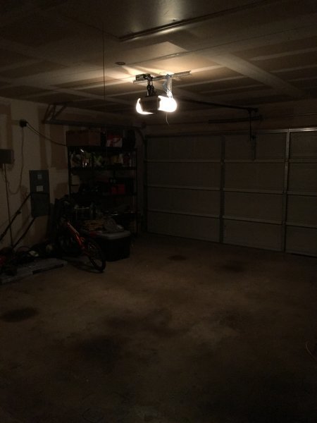

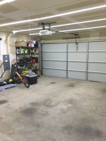

    I put this on another thread already, but didn't see this thread.
    Total budget was $211 (including WAY too much romex, so it easily could have gotten below $200). I wired the existing light box into a junction, ran wire from it to two new junctions, then hard wired the D.C. inverters for the LED light strips into those junction boxes.
    The before and after was dramatic. I locked the ISO, white balance, and exposure on the picture so it really is this drastic.

    Cool. I was thinking about strips instead of fixed lights so I get a more even spread. Can you tell me about the strips? I have strips in my gun safe but I don't think they will be bright enough for the garage.

    I used 16.4' strips off of eBay. The strips, with power inverter, were only like $16 a piece. 4 was probably the minimum for my garage, but it is bright enough I have almost not adjustment time after walking in from outside. It used to take 10 minutes for my eyes to let me see anything it used to be so dark.

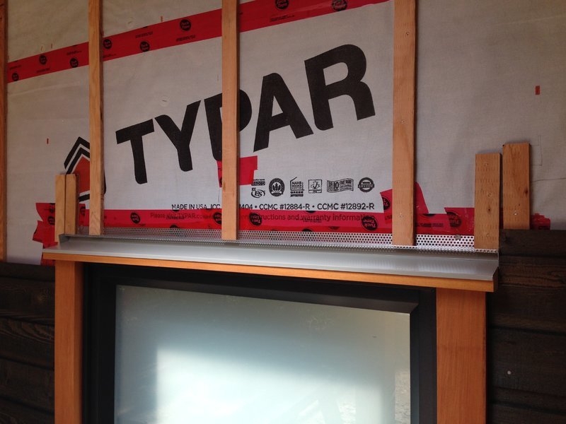

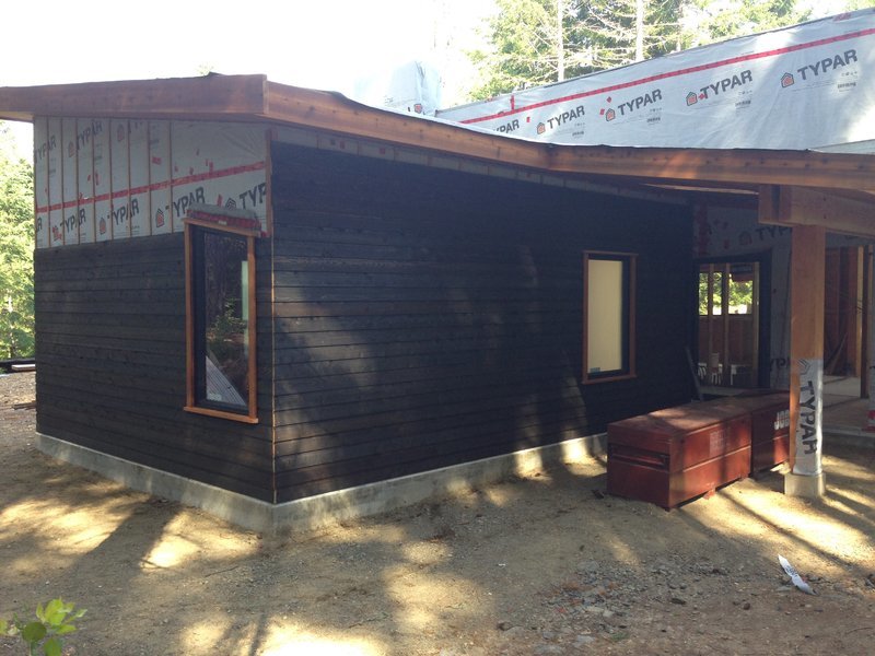

    We carried on with siding today
    To finish up the rainscreen discussion this is the detail at the tops of windows and doors , head flashing over the top trim that laps behind the housewrap and is taped to it , 1" end dams on the head flashing and a perforated J to allow for a drainage path
    Charcoal 1x6 Channel Siding
