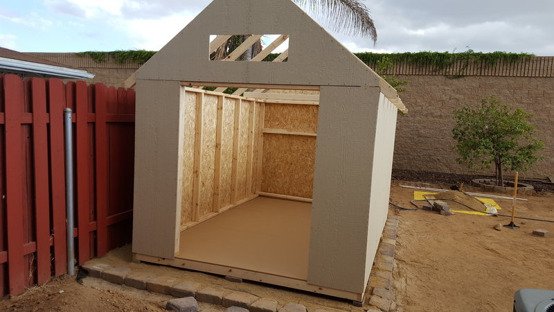

    New shed

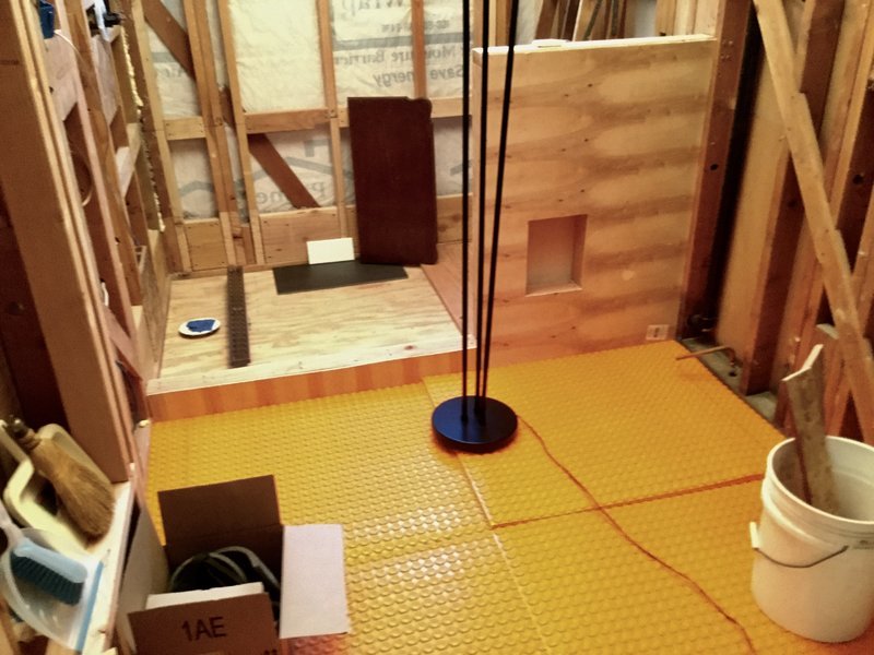

    Ditra Heat mat arrived today so I set it in place (roughly) to make sure I had enough and to let it flatten a bit more. I sheathed the shower 1/2 wall and did a few other things to prep for the hot mop guy. If I could just get him to call me back...
    :annoyed:
    I'm moving the shower slot drain as it was too close to the wall. The old location is where the white drain is, new location will be close to where the slot drain is sitting. I just didn't have time to cut a new hole today.

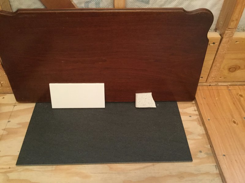

    Our floor tile arrived today so we picked it up. Floors will be that dark grey, shower walls medium sized white subway, counter top and shower threshold horizontal surfaces will be the white quartz and the vanity will be a walnut type wood (wood in pick is reddish and is just scrap - actual wood will be not be reddish).

    What do you mean by hot mop guy ?

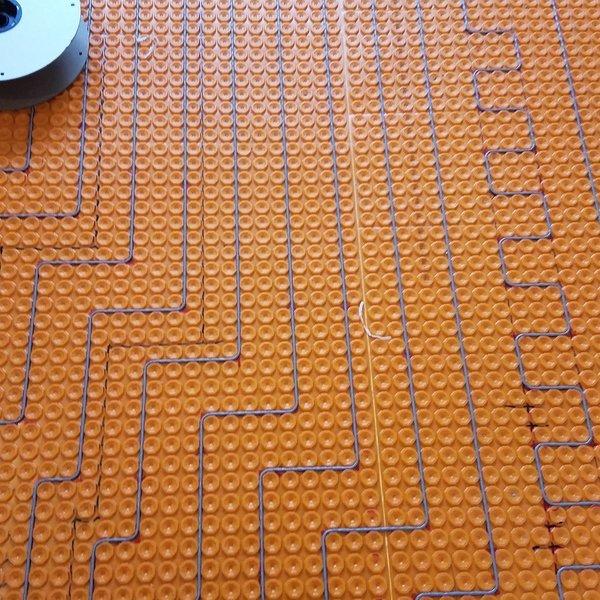

    Love ditra heat. Did a bunch if it recently,
    Between that and wedi I can't complain.

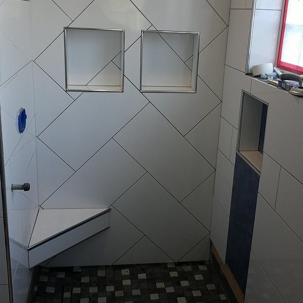

    One of three

    Nice tile seam alignment! Are you getting a lot of customers requesting those recessed spaces? I have seen this on about 4 bathroom remodels in the last year, and I would think they would be terribly troublesome for mold and mildew.

    I have 2 niches in my shower , no issues
    If they get waterproofed the same as the rest of the shower , in my case with Schluter board and kerdi , there is no reason why there should be more of an issue with mould than anywhere else in the shower

    Did a little research and found that hot mop shower pans are a West coast thing. Didn't realize. My understanding is it's basically the same as hot mop flat roofs but done for the shower pan.

    Any reason you're not just using a dry mortar pack and Schluter Kerdi ?

    I like the niche better than shelves personally and with wedi they are so easy to add or change it's ridiculous
