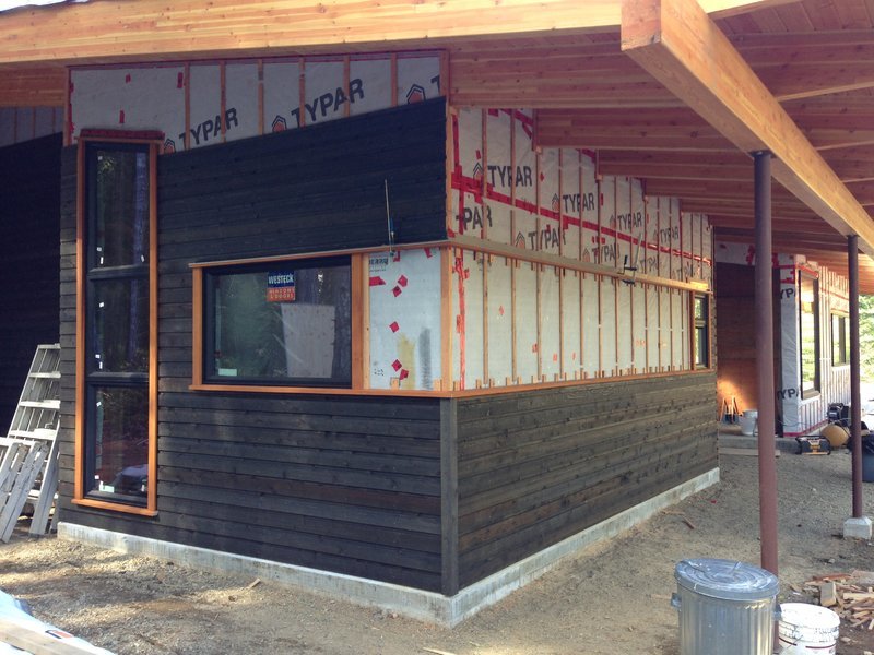

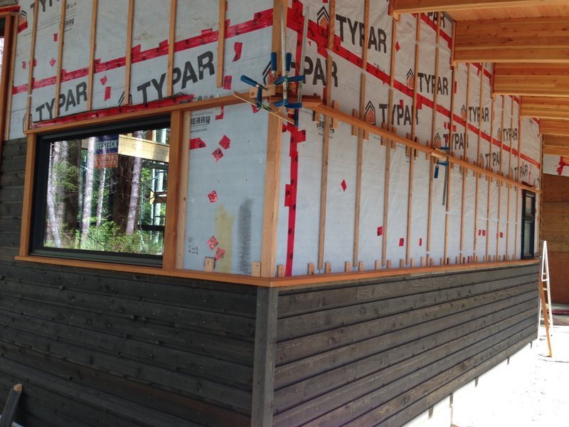

    More siding progress
    A bit of dicking around today with the area that will have the clear cedar 1x6 feature panel
    Continuous grain wrapped top and bottom trims applied and flashed , rainscreen drain applied above window as required
    Vertical cedar goes in the panel between the windows / continuous trims , our regular charcoal horizontal 1x6 channel will go above and below
    * note OSHA / WCB compliant fall arrest gear for all clamps involved

    Holy Shit, that's impressive.
