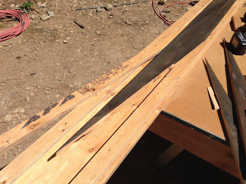

    More siding fun
    We had a change of plans that eliminated the top trim I intended to use at the top of the channel siding where it meets the 2x6 fir t&g roof decking
    I intended to use a rabbeted trim to hide any imperfections in the upper edge of the siding to get a consistent 1/4" reveal between the trim and the roof decking
    This 1/4" gap acts as our upper vent for the rainscreen system and is the exit point for the drying convection current that will exist behind the siding in the rainscreen cavity
    The owner liked the way we had tightly notched the siding around the glulam rafters and wanted a similar look at the siding to decking transition
    Thats not really a problem where the siding meets the decking at a level condition but becomes more difficult to acheive up the rake walls especially with the low pitch
    The 2 in 12 roof pitch is 9.5 degrees , therefore we needed to cut our siding at 80.5 degrees

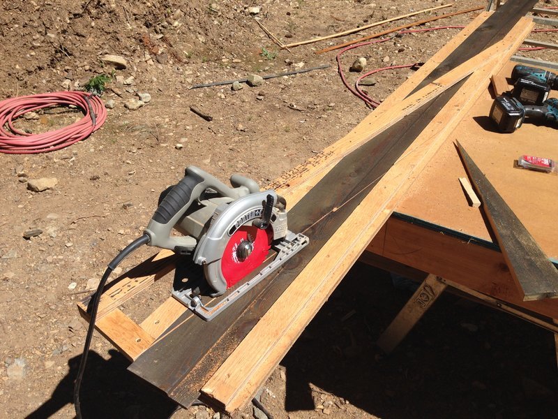

    Very sharp and very hard to make a consistent reveal if cut by hand , so with quite a few cuts like that I rigged up a shooting board to cut that angle consistently the same
    I built a jig out of plywood that captures the siding with a stop on either side , and a fence set at the prescribed angle of 80.5 (2 in 12)
    Now all I had to do to get accurate cuts was slide a piece of siding into the jig and run the table of my circular saw with a 40 tooth finishing blade tight to the fence for consistently accurate cuts

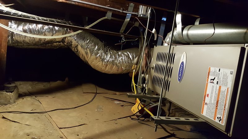

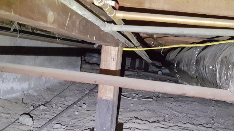

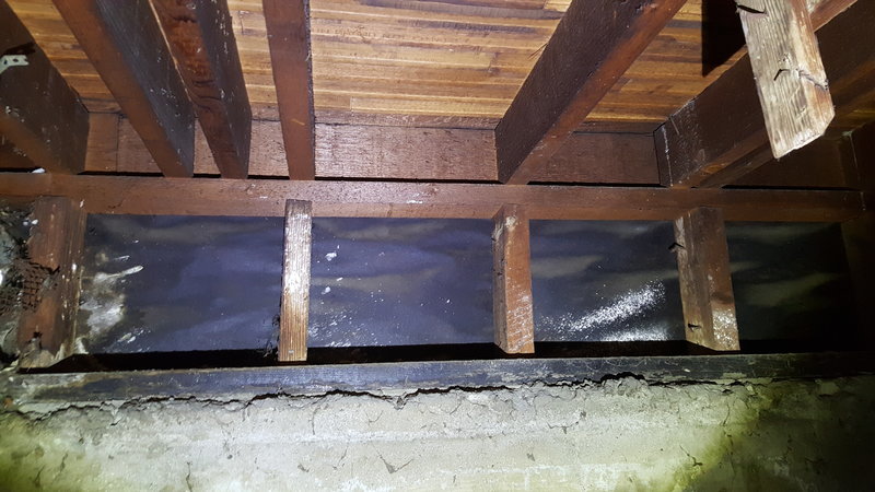

    OK, i went down and took some pics and to see how the foggers did. I saw a couple dead roaches, no spiders. I guess thats a good sign? I have not gone all the way to the front of the building, only as far as i can go without getting on my belly.
    Here is what the edge of the wall looks like. The third pic is how far i need to go, the place where the cables would be fished from is about half way between the concrete patio foundation and the far wall.
    Nice thing about this apartment, even though being from the 1920's, they upgraded the kitchen and added central air. I found a 18v Dewalt battery down there if anyone wants it.

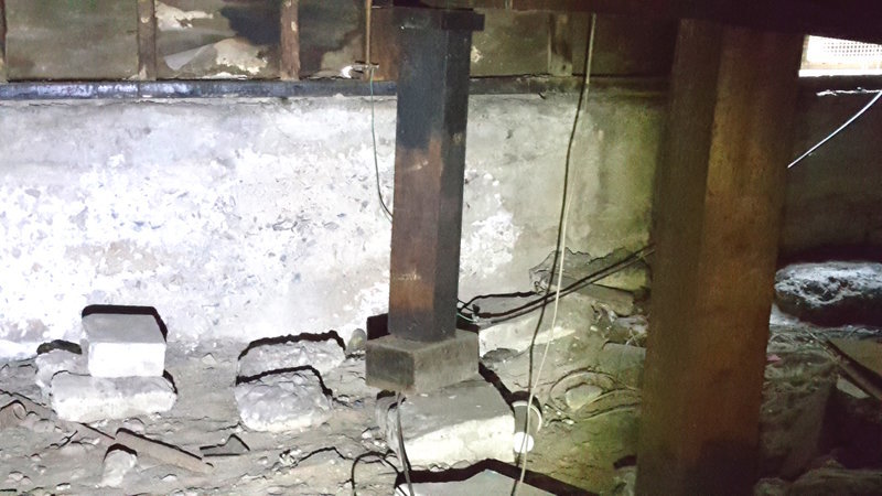

    @OZ-T This is the piling right underneath my bed. Should I be concerned? It like half off the concrete.
  16. Jun 23, 2017 at 7:47 PM
    OZ-T
    OZ-T I hate my neighbour
    Dec 15, 2009
    #27584
    50,587
    Peter North
    British Columbia
    Is your framing all redwood ?
  17. Jun 23, 2017 at 7:50 PM
    Caligula
    Caligula Well-Known Member
    Sep 14, 2010
    #43228
    2,108
    Los Angeles, CA
    2000 Ext. Cab Prerunner 2.7L
    Yes, it appears so. Its an old four-plex north of downtown LA, circa 1920's. Ive told the Korean landlord, she had a glazed over look when i tried to explain it. :rolleyes:
  18. Jun 23, 2017 at 7:58 PM
    Justified
    Justified Well-Known Member
    May 16, 2015
    #155392
    407
    Wayne
    Nevada
    2023 MGM 4x4 TRD Off Road
    That doesn't look good and given your location would be bad during an earthquake which would explain why it currently looks like that.
    Your framing and stem wall are similar to what I posted above. Drill up next to the vertical piece of wood. That's the rim joist and you will pop up in a stud bay if you measure correctly.
