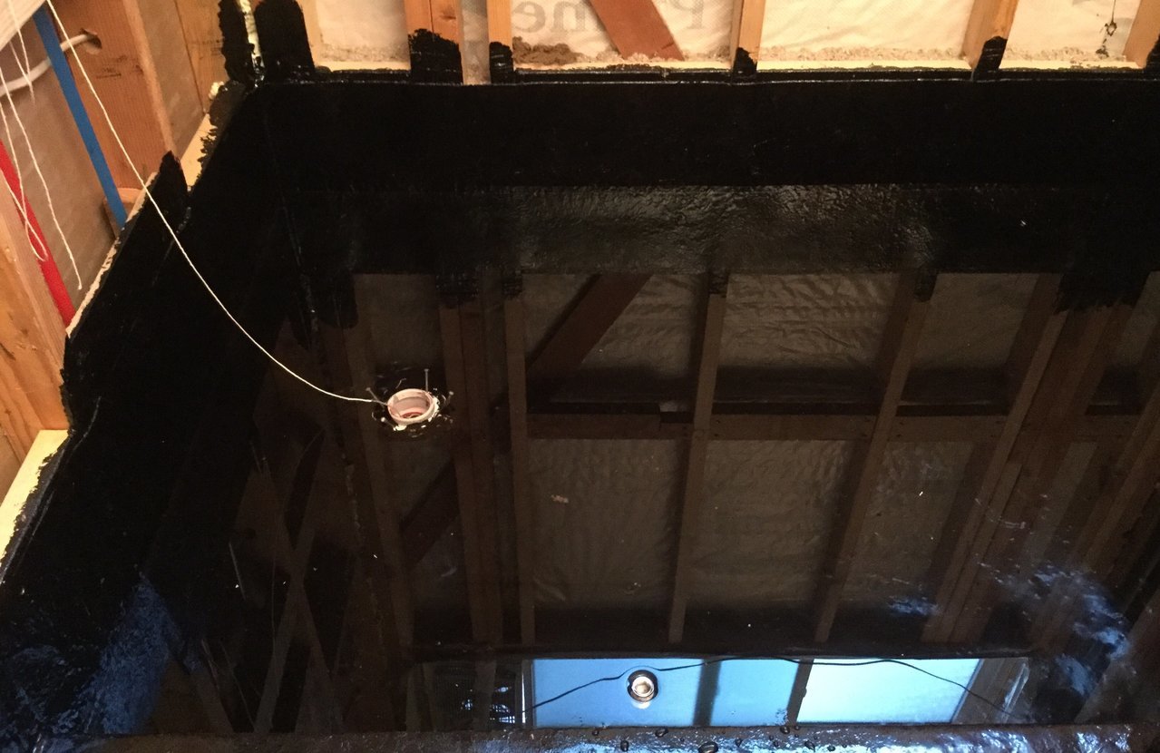

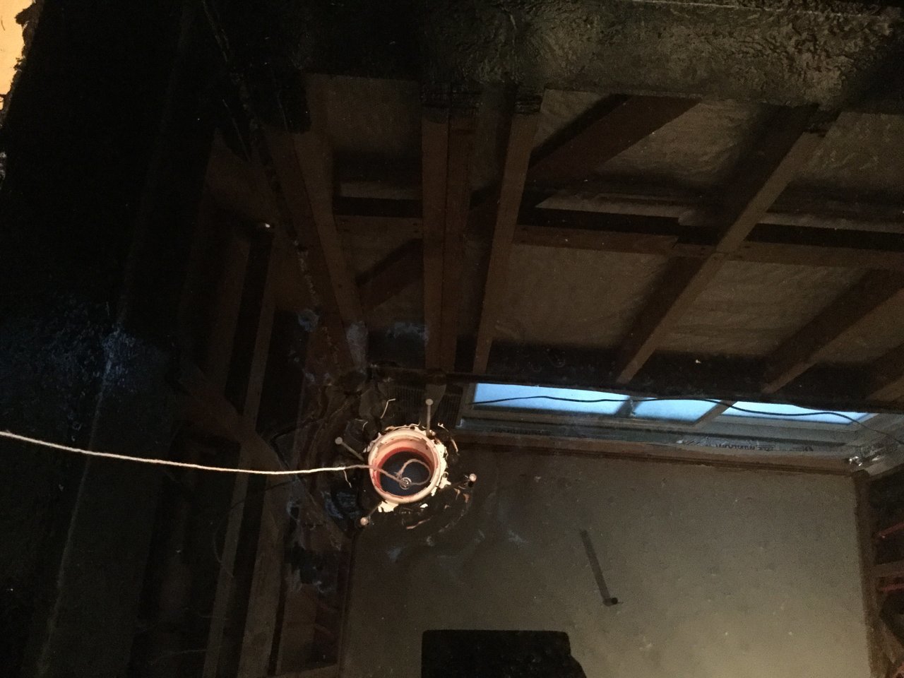

    Water testing the hot mop shower pan...
    Didn't want to pay $50 for a pneumatic plug (drain has weep holes so regular plug wouldn't work), so I improvised. Racquet ball, anyone?

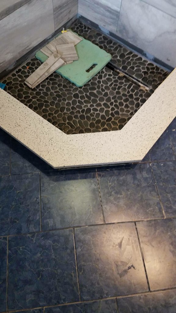

    Shower sills got installed today and omthat one was immidetily ripped out as it was the wrong color. I like when customers handle the material.

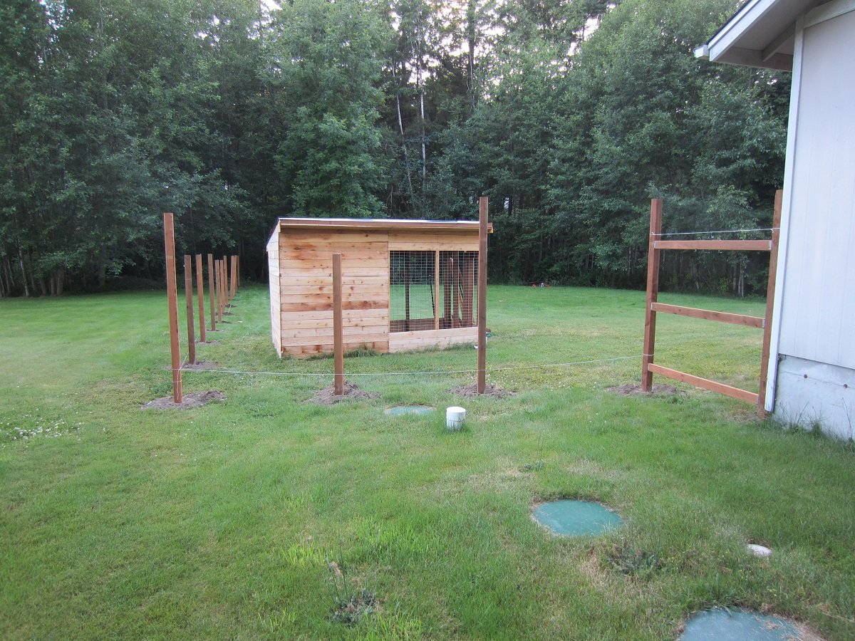

    Well after the pup got a taste of getting to go in and out of the house on his own (into a fenced yard) at the gf's place, I could tell he missed that at my place. So begins phase 1 of fencing the yard in. Phase 1 will be the portion you see now. Phase 1.5 will be a temporary weld wire fence along the back. Phase 2 will replace weld wire with more cedar fencing. So got all the holes dug and all but 3 of the posts cemented in. Only stopped cause i ran out of concrete and didnt want to run to get more when Ill be going tomorrow anyways.
    Dont mind the different sizes....all will be trimmed to the same height (had some 10' 4x4's i got of craigslist for cheap that i used up first)
    The dog enjoyed being out with me (on his 60' long lead) by constantly walking off with tools :)

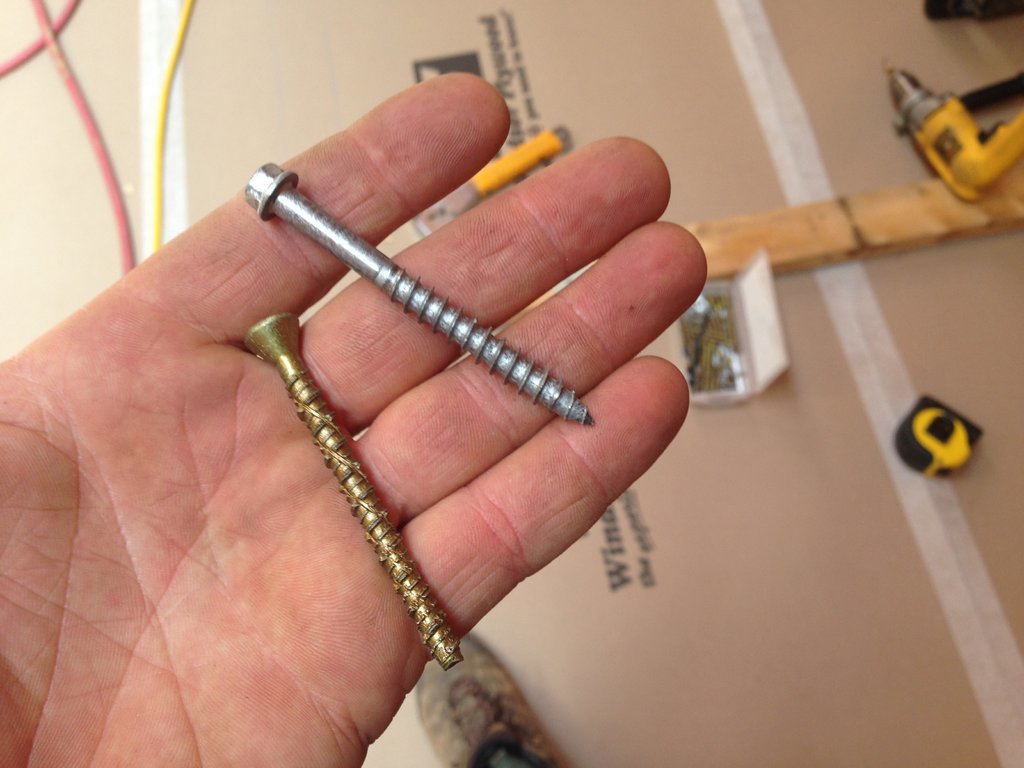

    As a side note , product review
    Concrete screws , GRK on the left , Hilti on the right
    GRK is awesome , Hilti is garbage

    I have to agree with you on GRK screws. I've used a few different types and they have all be amazing. Never knew how different screws could be. They are well worth the extra money.

    If it's stupid, but it works......

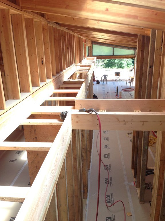

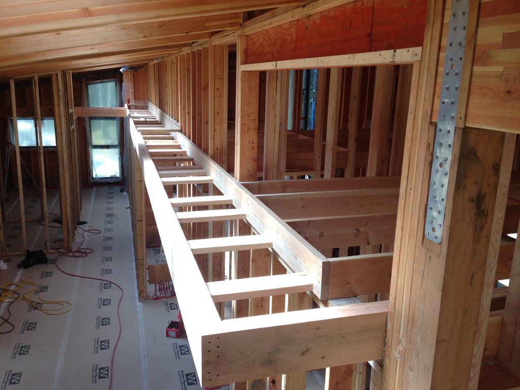

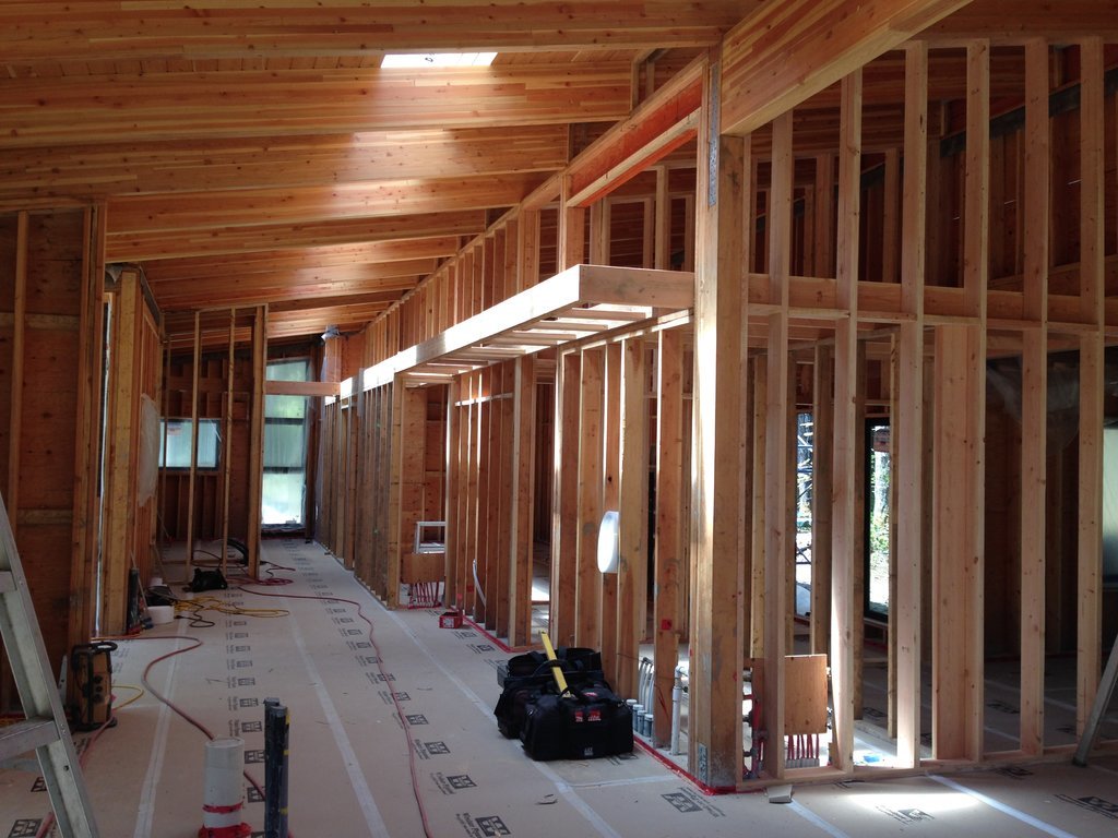

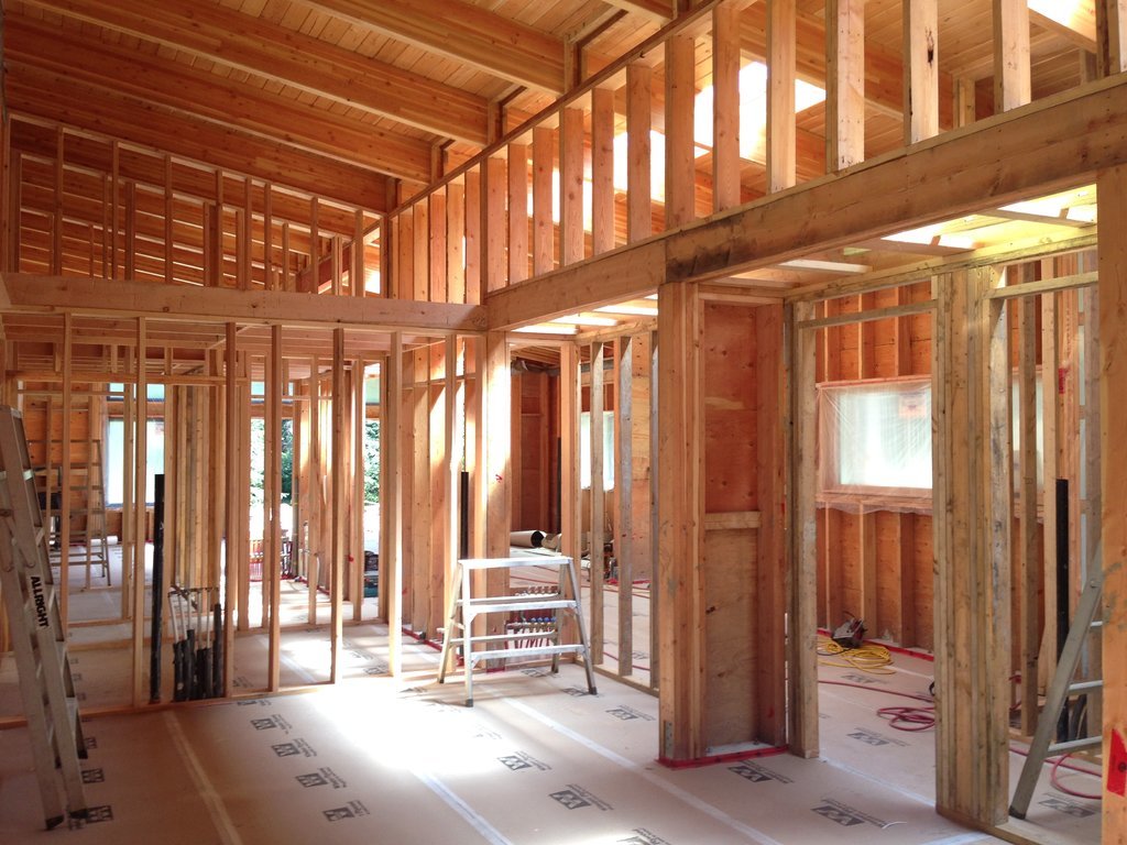

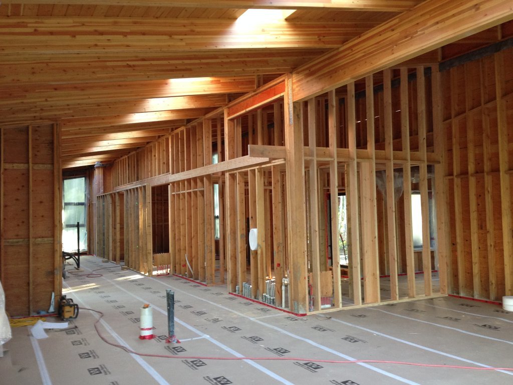

    I guess I was a bit optimistic thinking I would be done all my framing yesterday because I worked there for 10 hours today too and still have to go back tomorrow lol
    Just about there though , mostly just finishing up drywall backing , fire blocking etc
    Here you can see how we used a decorative "shelf" detail to our advantage for services . Early on in the plan review I suggested we use this element as a chase for our HRV/ERV ductwork as well as plumbing supplies and electrical
    The shelf is framed to be a continuous void for ease of duct runs from the upper area above the mechanical room where the HRV and make up air unit will live through the building down to the far bedrooms and bathroom
    The bottom will be drywalled , the top will get plywood screwed down on top so the services will be accessible if needed at a future date

    Nice work as always. How are you handling fire blocking the mechanical chase?

    We'll probably do some Roxul where required
