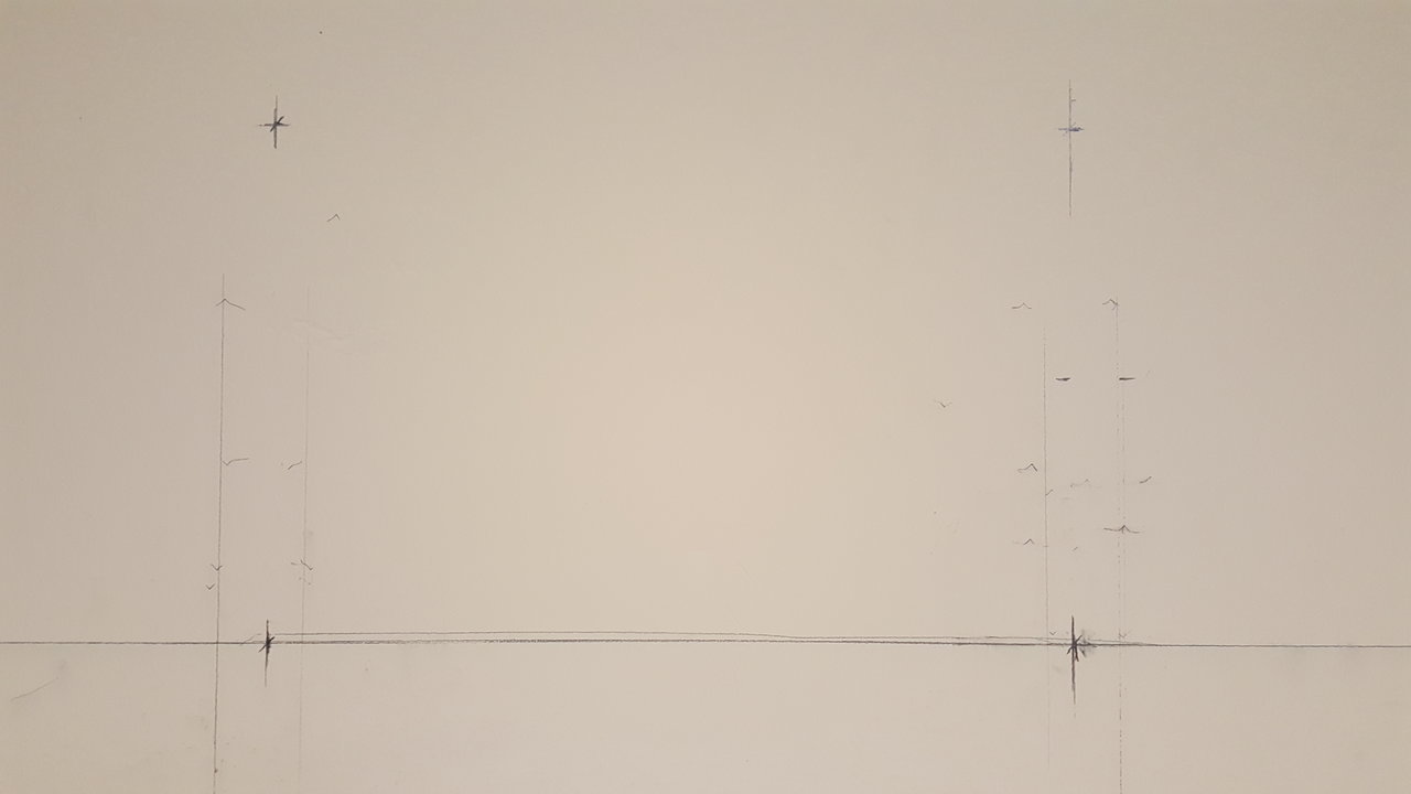

    Can anyone recommend a stud finder that works well with lath and plaster walls? I have this Zircon E50, and it seems to be almost useless with these walls. I have found where the studs are by knocking, though I would prefer to find the exact center to drill into.
    Here is what I have so far. My best estimates are more like 17" on center.

    Can the stud finder you have adjust for wall thickness ?

    It has a deep scan switch, though that doesn't help, it will just go off on spots where I know there is not a stud. When in regular mode I've been able to mark some spots on the wall where the stud generally is, through its not very accurate or consistent with the edge finding. The drill marks I've made are a best guess based on 16" spacing.

    Lath and plaster can be hard to get a good reading through because of the irregularity in densities of materials
    You could try one of those cheapo magnet stud finders , theoretically all the lath nails should be in studs
