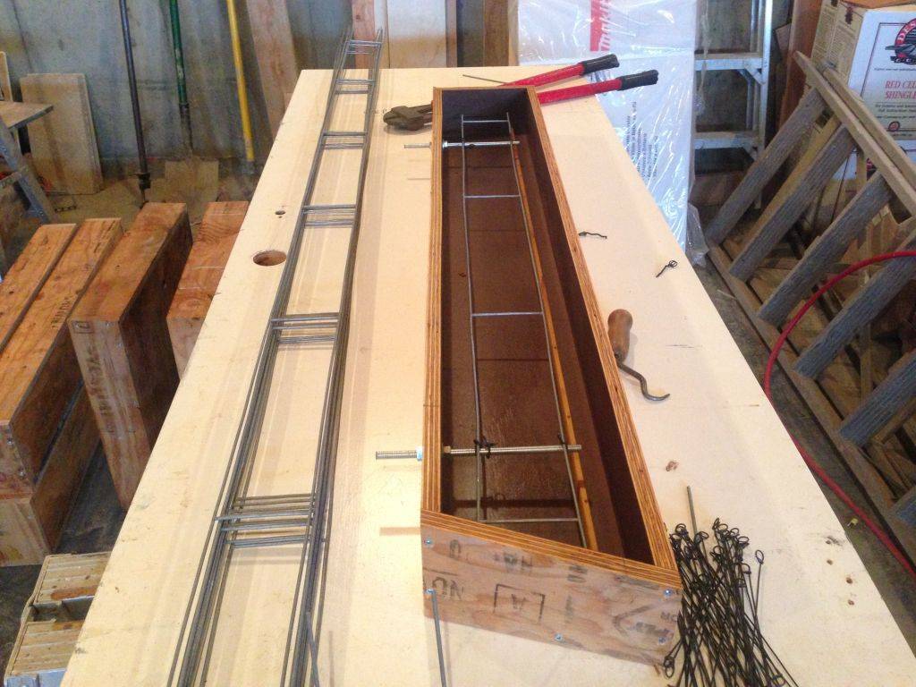

    Doing some cast concrete sills that will wrap around the foundation of the house I am working on and serve as the transistion between the siding above and 5" natural stove veneer below
    Typical form with drip edge , 3/8" redi rod pins that will later be epoxied into holes in the foundation and block lock reinforcing mesh
    30MPa 10mm aggregate mix

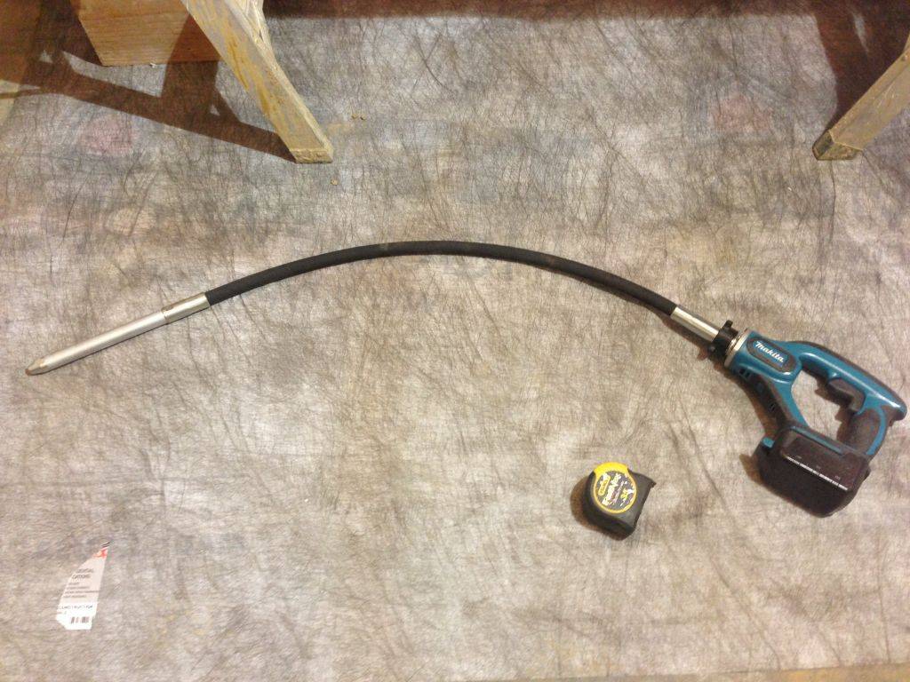

    Got to use my new 18V Makita 4' wand cordless BGR
    Filled , vibrated and rough leveled

    What is the brown coating on the forms? Is it just an oil based paint to help with mould release?

    The brown colour is the paper , I use paper faced form plywood , there is a form release coating painted on as well but it is pretty much colourless
