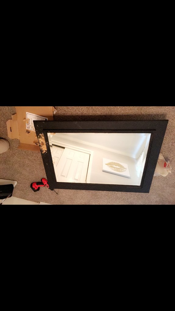

    Working on mirror for my wife's studio

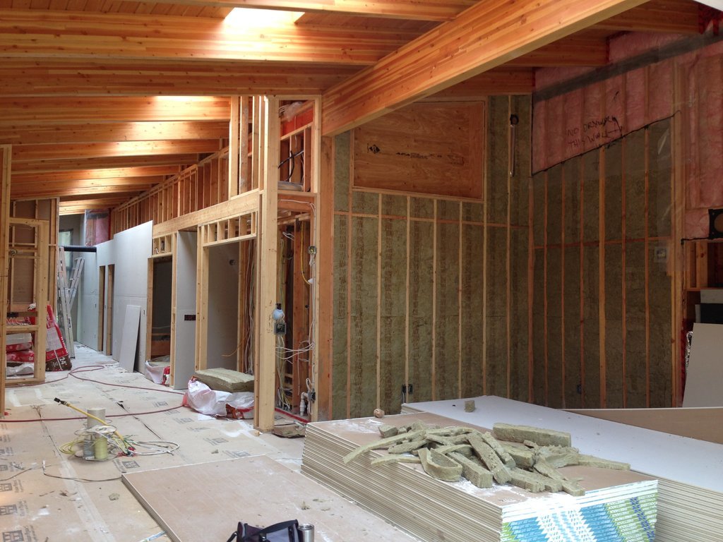

    Been a while since I posted any progress pics , rough in plumbing and electrical is done with the exception of the service panel , insulation and vapour barrier done and boarders have 1/2 the house drywalled
    We did a bit of Roxul Safe'nSound insulation today around the master and laundry room

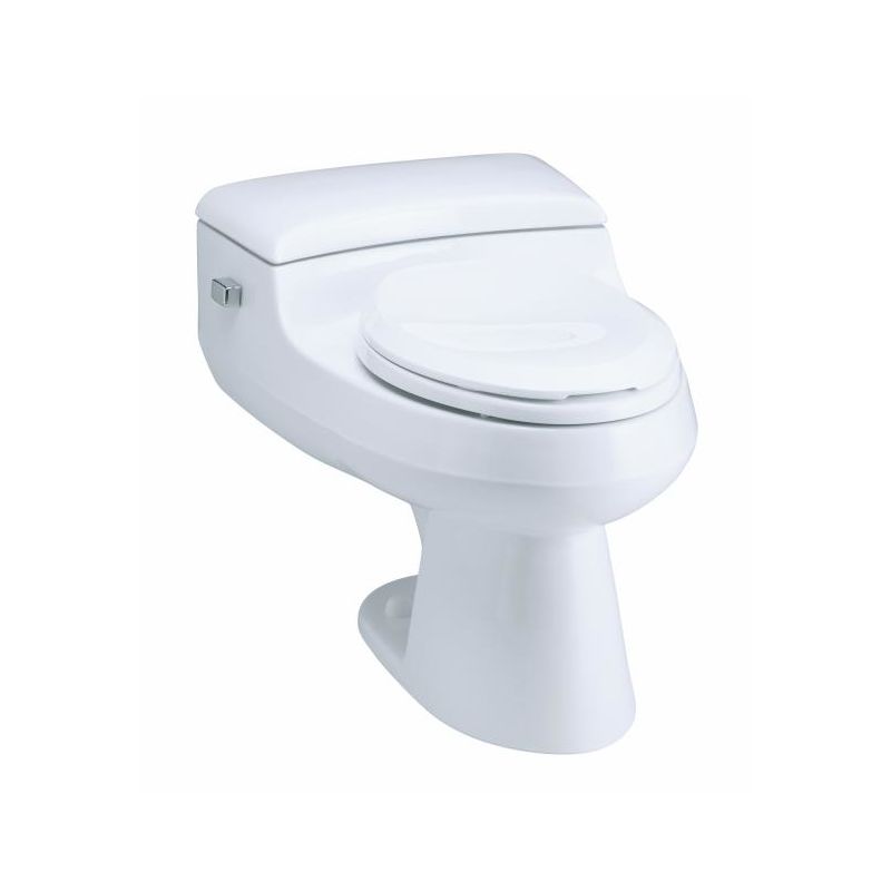

    When you say the toilets were super low to the ground, it sounds that you have a proper toilet. There is a reason the Squatty Potty is so popular, you're supposed to have to squat when on the can.

    I mean the whole thing, tank and all. I kept a lower bowl design mainly for the kids benefit, but the integral tank on the old one was so low there was absolutely no flush pressure. Looked similar to this:

    Quick question.
    These wire nuts pissed me off so I just used electrical tape on the connections instead of the wire nuts. It is small lamp wire that I used and the wire nuts would not catch. The mirror will not be plugged in 24/7 and prob only be on an hour a day. Will this be alright? It's a high quality tape not the cheap stuff.

    I would say NO! twist the wires together first clockwise with a pair of pliers and the wire nuts will lock on easier. There are different sizes for the number of wires you are tying together and gauge.
