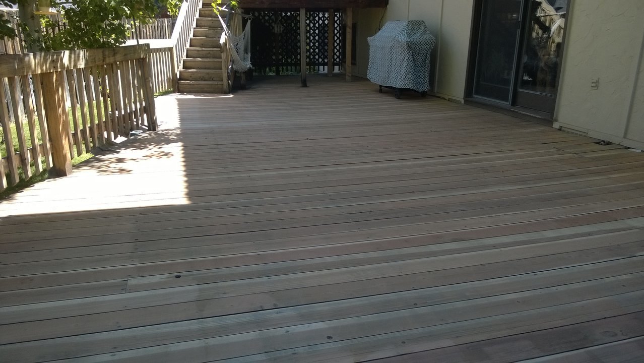

    I'm sanding my deck for a redo. What a crappy thing to have to do.

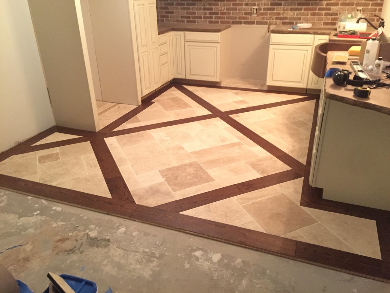

    Here's a finished pic of the kitchen floor I did. This was the cutback adhesive room I mentioned previously. Wood with tile in-lays.

    Thank you! My first attempt at this kind of design. Turned out great. Really happy with it.

    I'm assuming thats wood tile vs actual wood? Very cool counters also. Are they concrete with a rough edge?

    Yes it's a 3/4" hardwood plank. It's the same wood I have everywhere else.
    The countertops I made out of quikcrete countertop mix with their brown colorant. I used some chiseled edge molds for the front edges. Then I put a sealer that also deepened the color. This was a major undertaking as I made molds of all the pieces. It was fun though.

    that is an amazingly beautiful kitchen! farm sink. raw edge counters. brick backslash... I love it all! (when we rebuild, can you come do my kitchen???)
