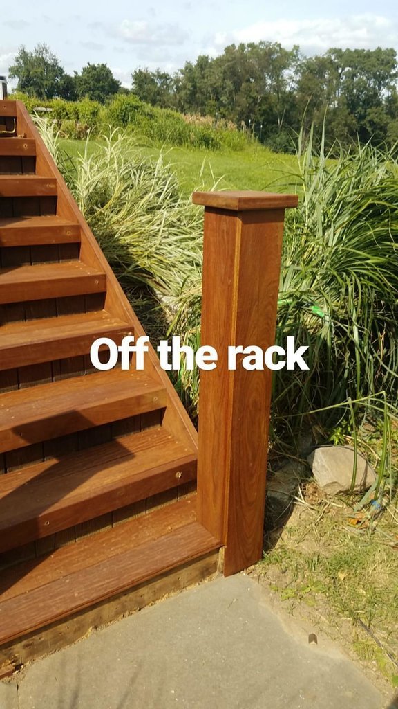

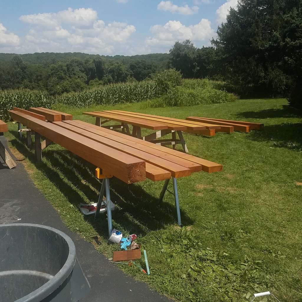

    I'll have to look, this has been a what they want is what they want cost isn't an issue jobs,
    Those ate 24' 8x8s

    Looks like nice material

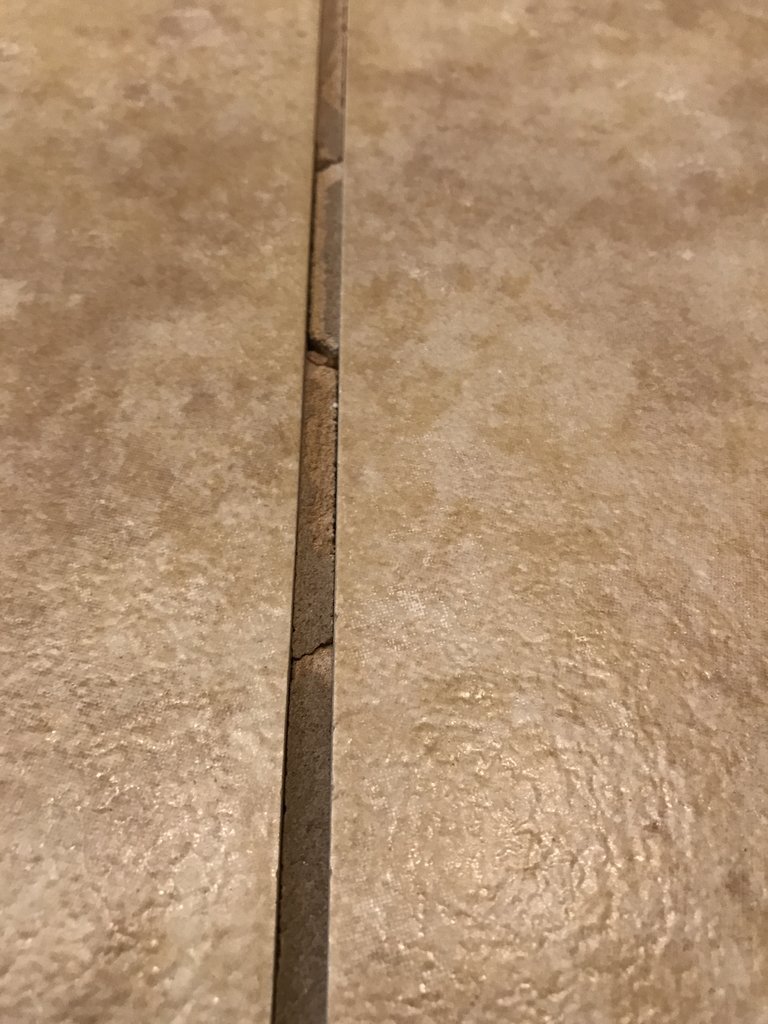

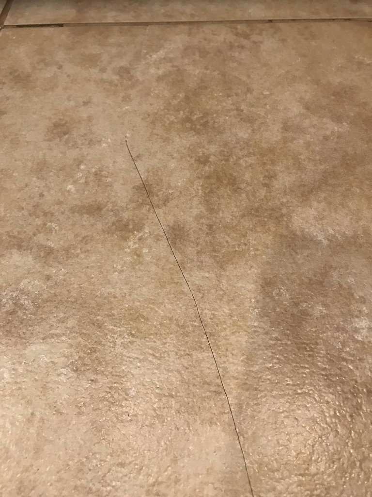

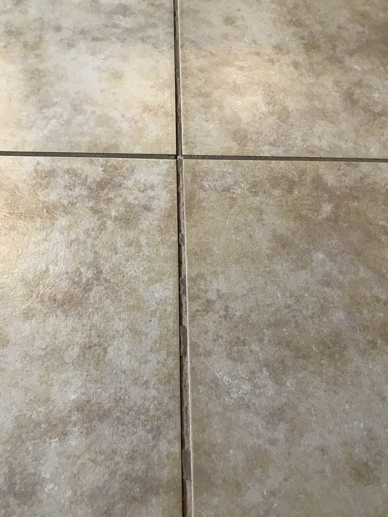

    Day 1 of tile work; taking the old stuff out and saved myself a bit of money by helping the guys and removing the screws and helping remove the underlayment. The old stuff was popping right off so there was no bond between the mortar and the underlayment.

    Not just glue and clamps lol he did some serious shaper/router work so the corners would lock together

    Locking mitre

    Yes lock mitre titebond3 and it will be screwed to the old post. It should hold up for a very long time. If not I'll redo it. The homeowner is letting me play a bit, which is nice.

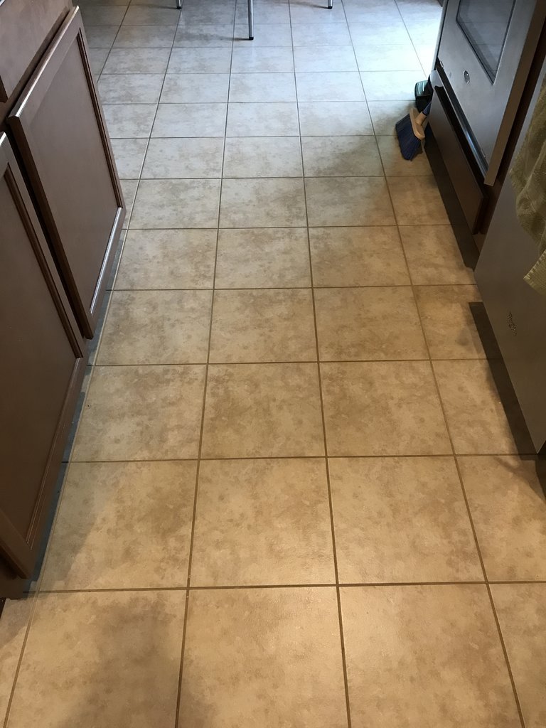

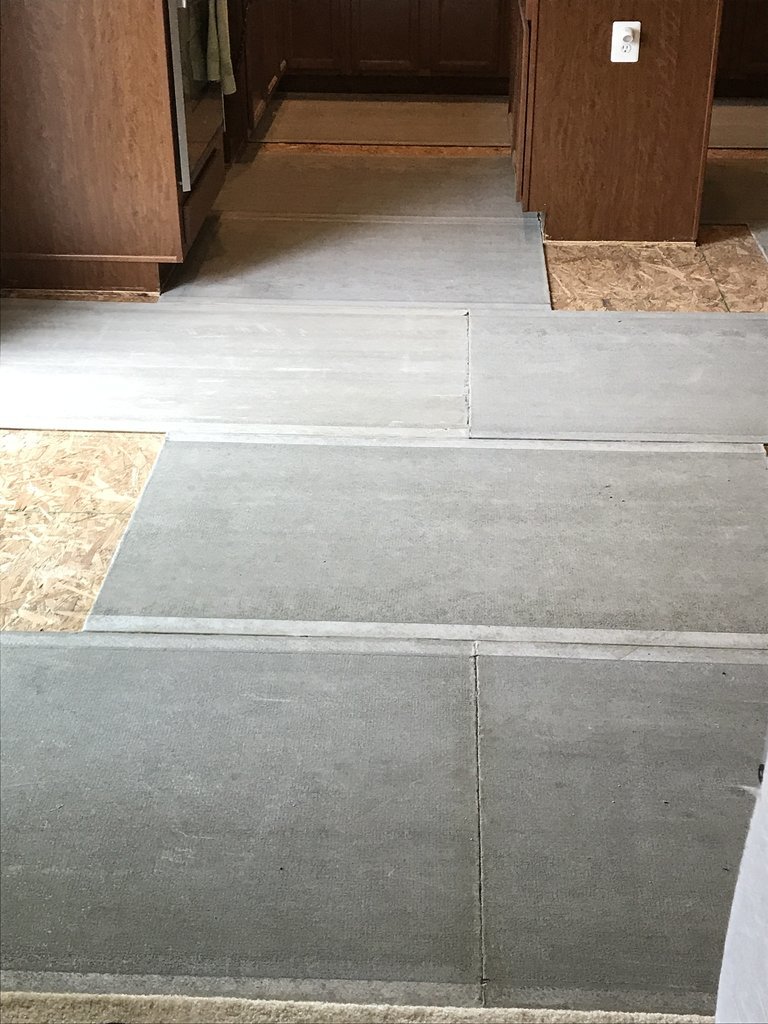

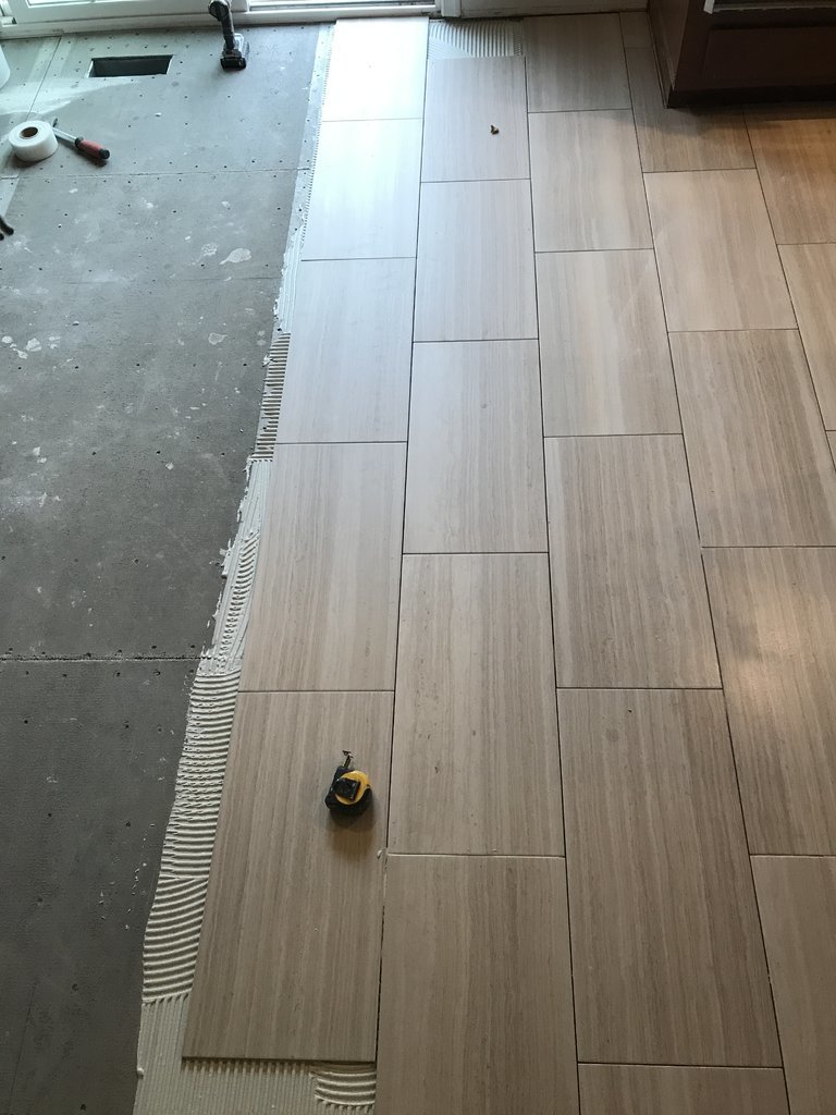

    Second day of kitchen tile work, finished pulling up all the 3/4" underlayment, put down the 1/4" durarock, and layed the 24" tiles. Tomorrow they will be starting the demo of the bathroom tile and putting in the grout in the kitchen. IMG_1697.jpgIMG_1701.jpgIMG_1703.jpg IMG_1704.jpg

    Looks good!

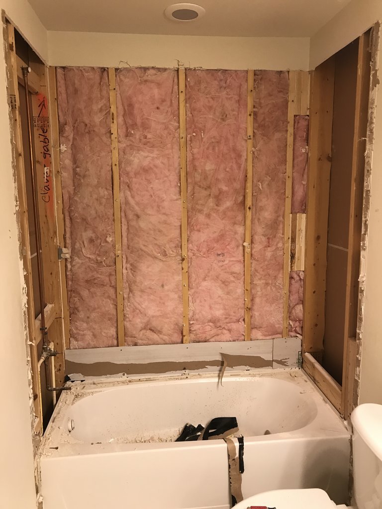

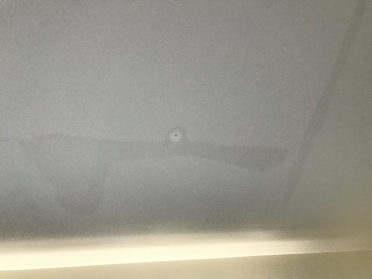

    Day 3 of 5 day saga. The grout was spread and the demo work on the bathroom was done. The builder put the green board right on top of the bathtub, which is why the caulking kept getting mold on it. Putting in the new tubcreated some issues, as it is steel, and not plastic. Nothing like when the contractor breaks the glued seal before it's set to have a water leak on the ceiling right under the bathroom. I told the wife it could have been worse, it could have been my fault!!
