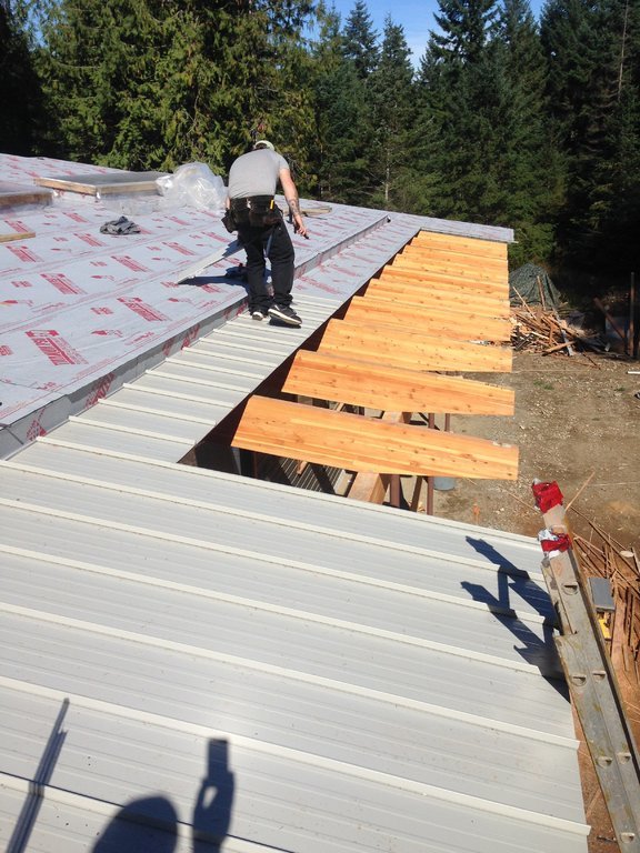

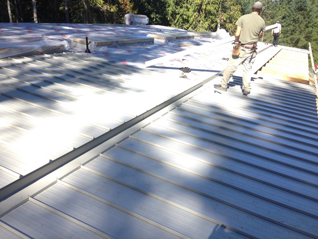

    This is Prolok which has the benefits of standing seam for not having any exposed fasteners but without the need to mechanically roll / fold the seams

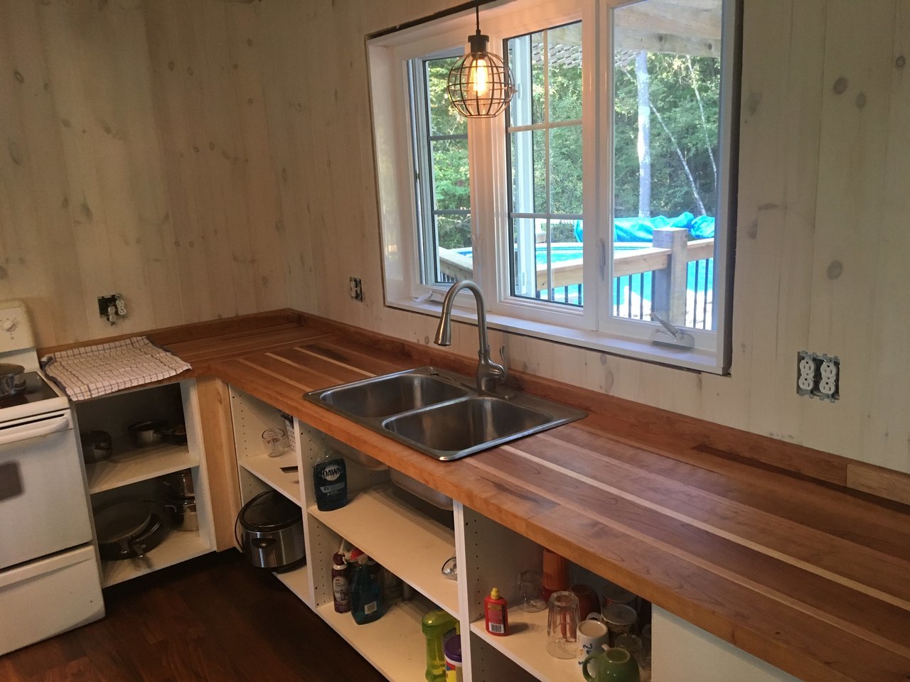

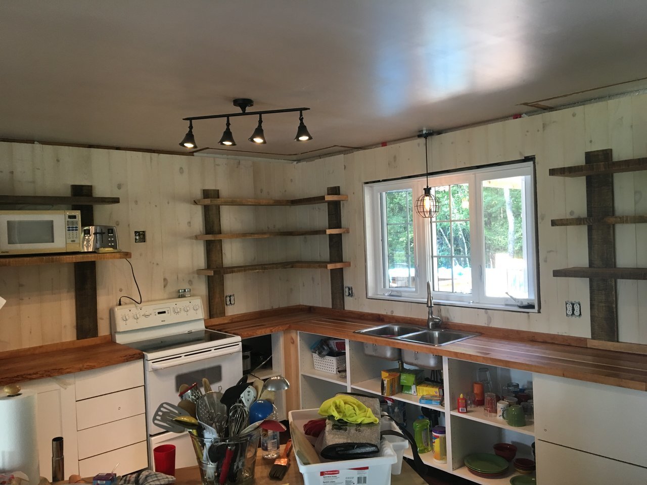

    Kitchen renos almost done

    What do you use for ice?

    You mean like snow breaks ?

    Not sure in the correct term, it's used to keep the ice/snow on the roof and not skidding off in one big chunk

    Yup...in PA we have talons that stop that.

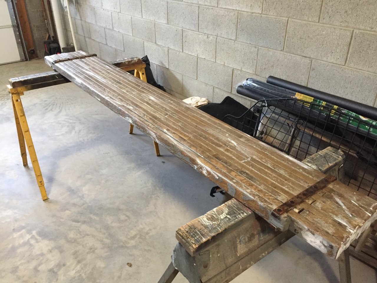

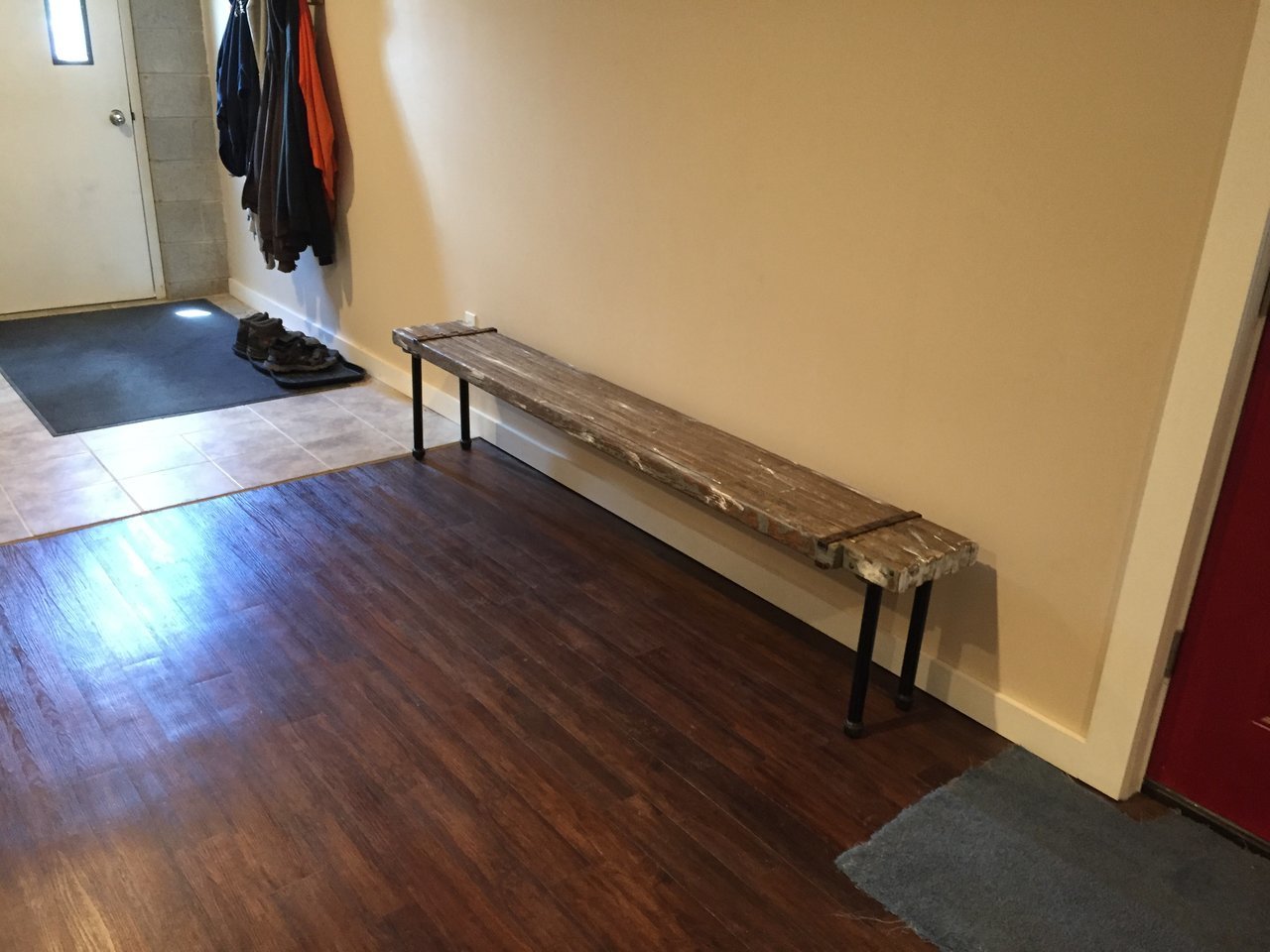

    AEA749DF-82C9-4C70-82E3-2AC5AA709C84.jpg 47BC5364-2E90-456A-95A2-C630EA83DEC2.jpg Turned a painters pick into a expandable bench

    Snow breaks
    When added they screw to the ridges of the fins on the metal

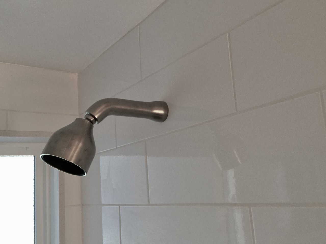

    Well, the 2" brass nipple for the shower head isn't long enough. I noticed water seeping out where the shower arm meets the wall. Neither 2" or 2 1/2" works. The shower arm doesn't have a flange. With a flange you can hide a gap between the arm and the wall. I need 2 1/4", but no such thing exists. I'm going to see if I can find a flange on line that will work. If not, I'll have to use a different shower head/arm.

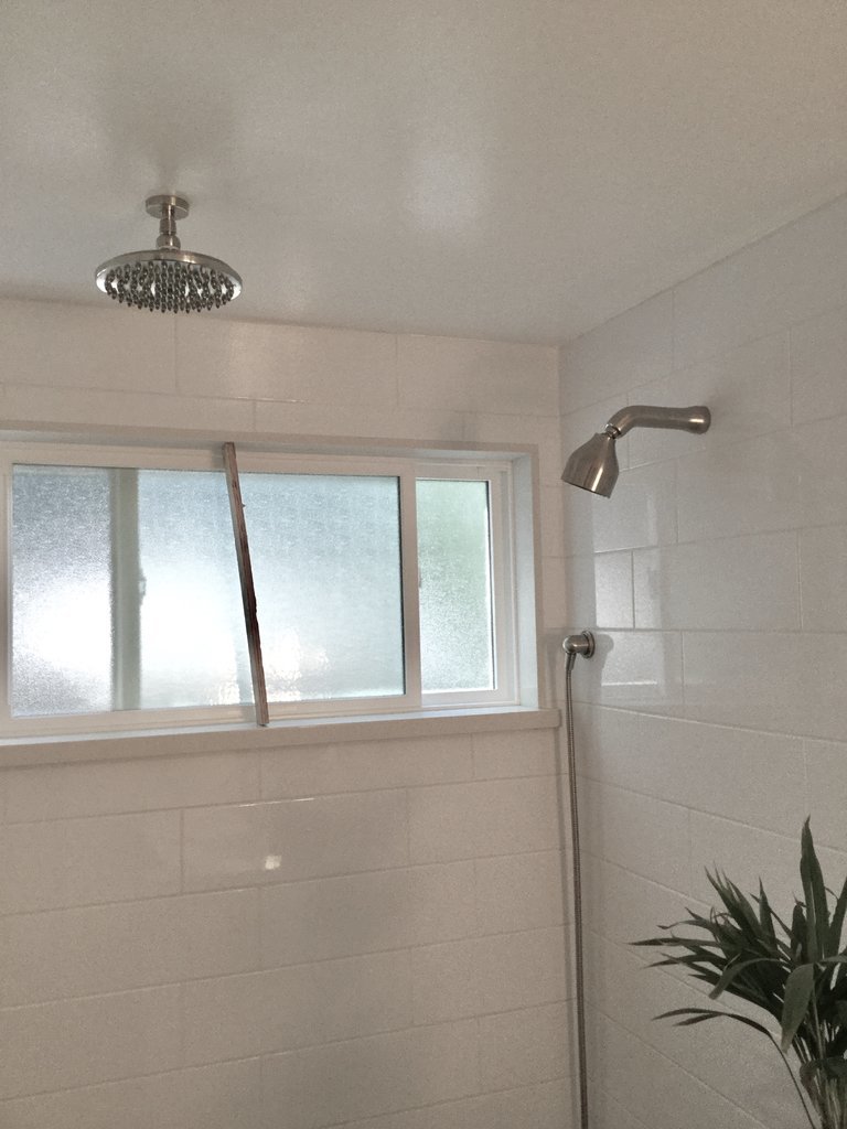

    I don't know how people install this particular style of shower head. As mentioned, there is no flange to cover any gap. The brass nipples used to connect them have tapered threads and only screw on so far (maybe 3 rotations). They have to be screwed down fairly tight to prevent leaks, so my margin to #1 get the shower head finished in the right direction i.e. pointing down, #2 get it tight enough to not leak, and #3 have a small enough gap to cover with a flange (or in the case of this particular style have a gap small enough to calk and not be noticeable) is proving difficult.

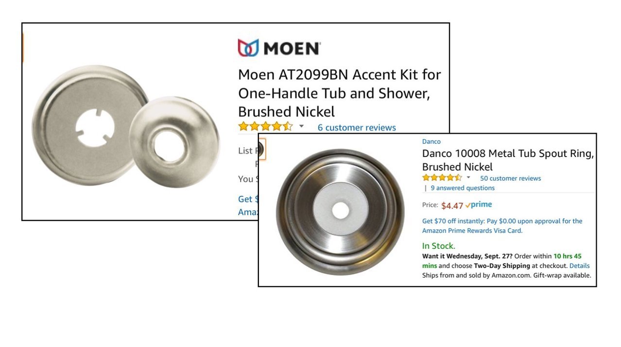

    I can only see 2 options - forgo this shower head or be creative. I may try a cover plate used for the tub filler. It has the right dimensions to work, however it doesn't slide over the shower spout but rather sits like a base. So i need to install the 2 1/2 brass nipple, see how big the gap is and if the plate covers that distance. Or comes close enough to calk. Ugh.
    No flange - just flush to the wall.

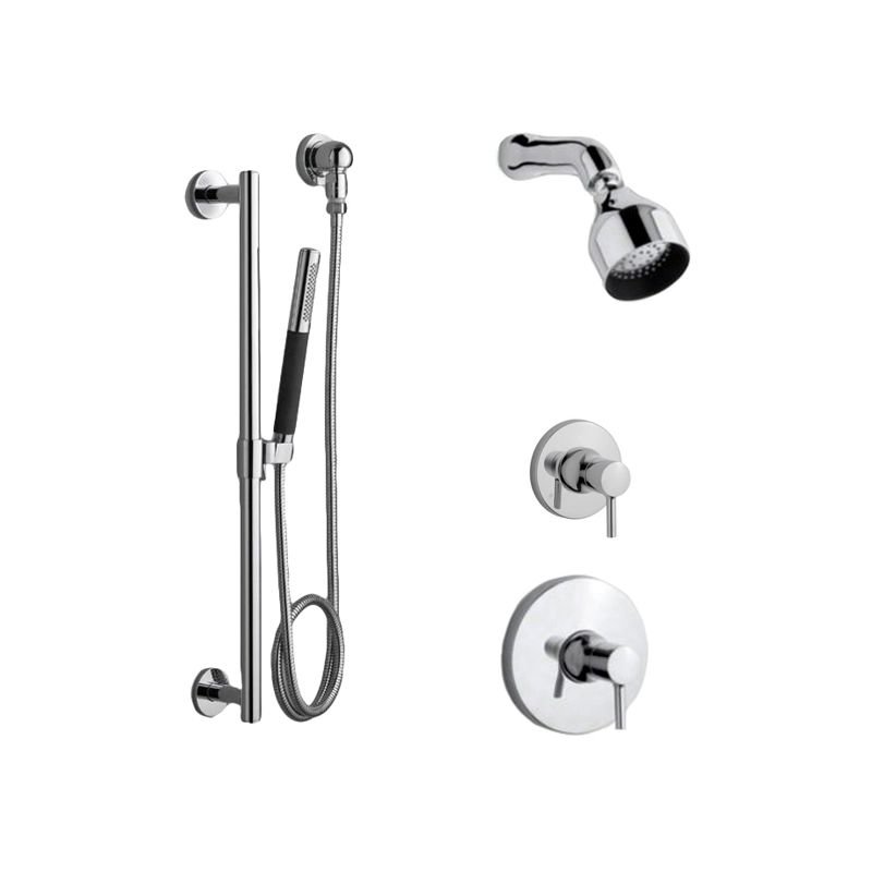

    Maybe use one of these as a base plate to cover the gap when using a longer nipple?

    No escutcheon ?
  19. Sep 25, 2017 at 1:01 PM
    916carl
    916carl Well-Known Member
    Jul 26, 2015
    #160332
    4,151
    Carl
    2008 DCSB TRD Sport SR5
    No. Didn't think about that or notice it when I bought the set...
