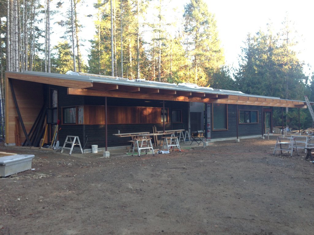

    What a mess. You should clean up first.
    The sawhorses are nice.

    Since it is kind of a barn'esque look to the house, I think the number of sawhorses are fitting. After all, horses go in barns.....:rimshot::rofl:
