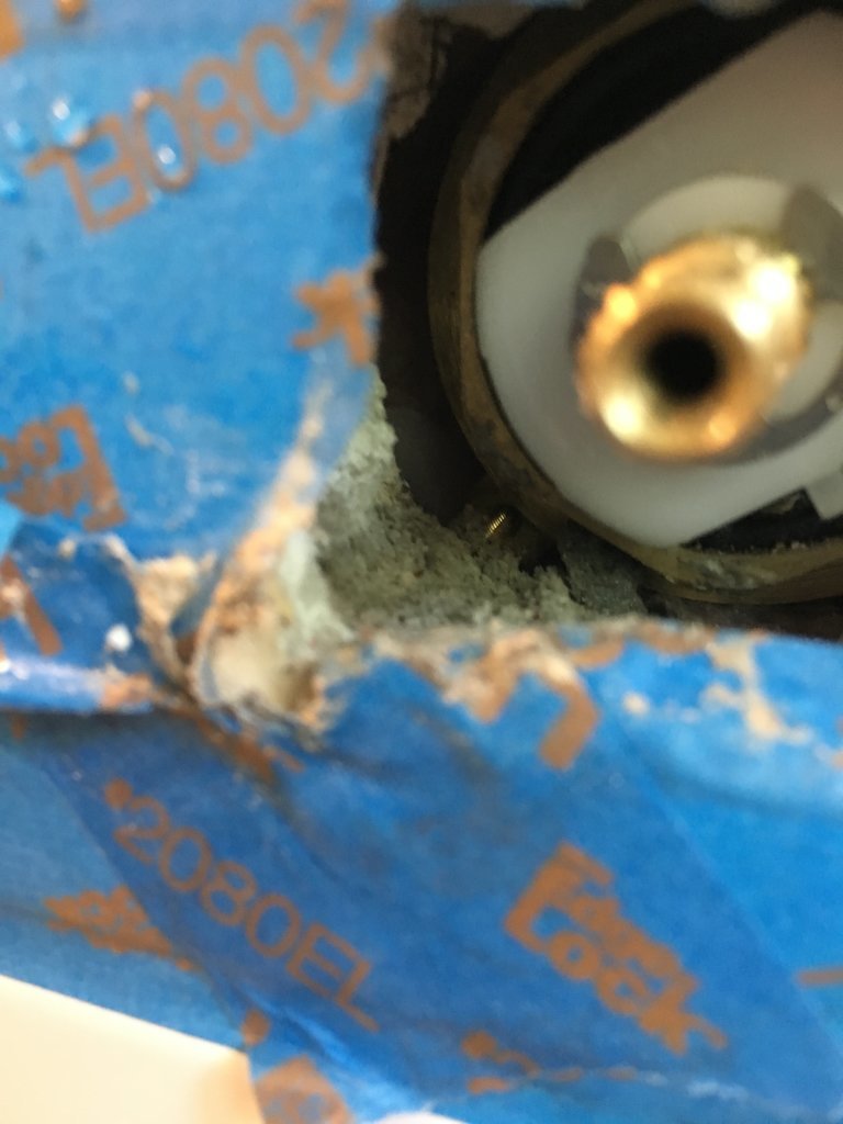

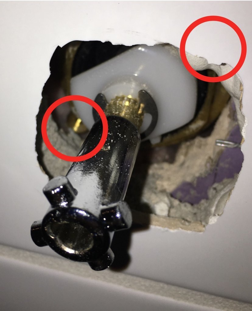

    Frackity frack frack. I'm installing the levers and trim on the shower plumbing and just found the tile covers the screw holes for the diverter lever/cover assembly (picture 1). I tried using a masonry bit to enlarge the opening enough to expose the screw hole but it's so close to the existing edge and it has to go through the tile, thinset and about 1/2 of mortar bed that it isn't working (pic 2). I'm not sure what else to do...
    The only thing I can think of is to use silicone adhesive to glue the trim to the tile. The lever screws onto that piece (pic 3). The only load it would have to support would be horizontally - the lever works by rotating it, not pulling it out - so as long as no one yanks it...
    Anyone have other options? What would you do at this point?

    I have bits to drill through tile but where I need to remove material is to close to the existing edge. The bit just slips into the existing opening. I thought of going further out but it would likely encroach on the area where the mounting plate mates with the tile surface.
    My other thought was to rotate the plate, drill new holes in the tile and just use anchors. Picture 3 is set up for that scenario. I found the same issue when I looked at that; the new holes would be <1/8" from the existing opening. Not likely to be able to drill a hole without cracking the tile and just opening the existing hole a bit more.
    I'm ready for this bathroom to be done...

    Maybe widen the hole and epoxy anchors or screw-blinds into place?

    I looked into widening holes in tile and found diamond bit on roto zips can work, I just don't have either of those. The masonry bit cuts with it's tip, so using the side of the bit the cut away material didn't work (tried it). At this point I'm going to use prodigious amounts of 100% silicone on the back of the plate. Worst that can happen is that it comes loose at some point and I'll just be back where I am now.
