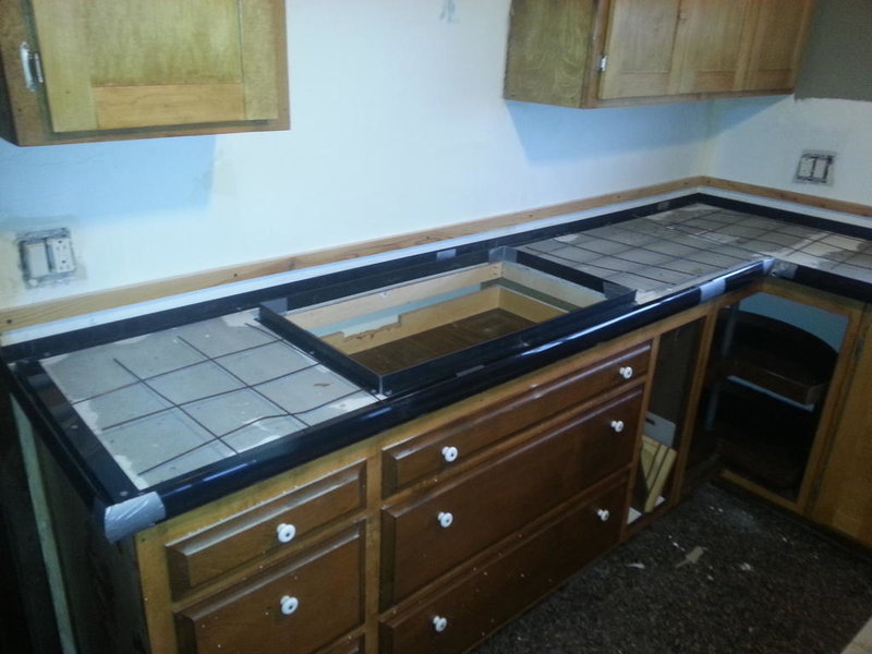

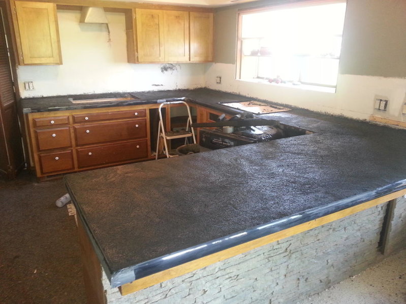

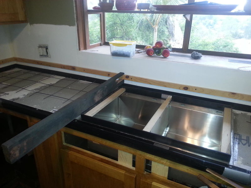

    Started work on the concrete countertops. Here are the forms mounted. I cut some wire for strength.
    I cut a slot on the end of my screed board and attached a runner to the wall. That give me a little bit longer edge to screed off of since the form is very narrow.
    The concrete is put down. The bottom half is GFRC with 19 mm glass fiber strips. The top is no glass fiber. We've just screeded and wood floated the surface. We'll use a steel trowel once it has set up a bit.
