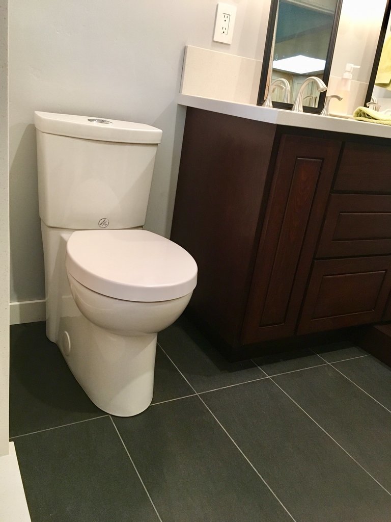

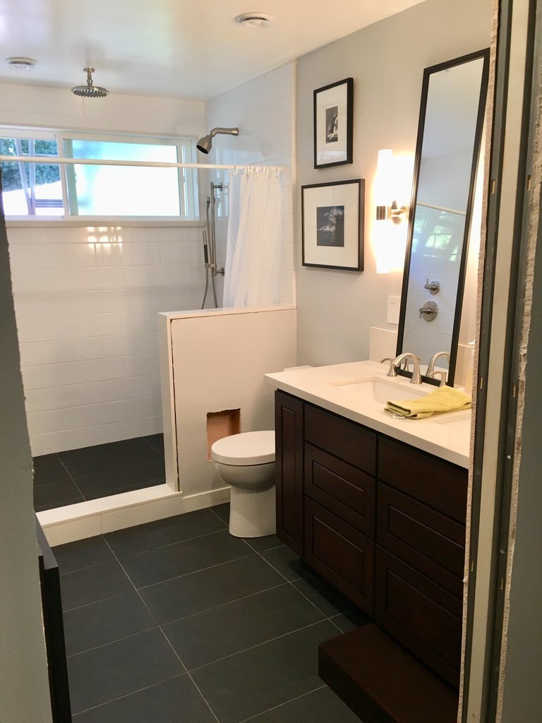

    What was a pain in the ass with it compared to a traditional toilet?

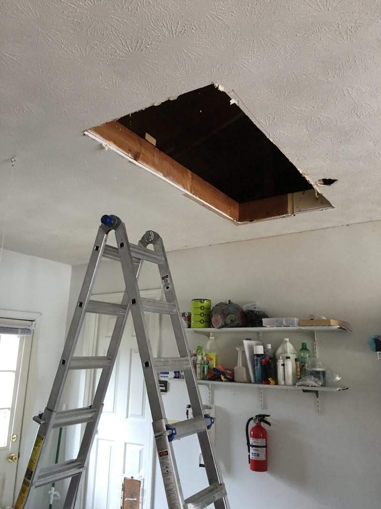

    I need to do this. I have a square scuttle hole right now. I hate using a ladder to get up in there.

    Is the hole in the wall going to be a magazine rack or toilet paper holder?

    Bath is looking great :thumbsup:
    I hate showing up and customer has a toilet like that from box store :annoyed:
    It takes longer and they pay more.

    Mostly it was the closet bolts that hold the toilet down are concealed in the structure. There are small round porthole in the sides (you can see they are capped off in the pics) that you're supposed to reach through to tighten the bolts down, however there just isn't much room plus the bolts are loose and move around a lot until you get the nut tight. I couldn't get the nut started as there was no room to hold the bolt still while twisting on the nut. I found it "easier" to straddle the toilet in reverse and reach around behind it and come in through the back. Still difficult to do, but it worked out in the end.
    Toilet paper. It is the only spot available. On the other side of the 1/2 wall is a niche for shower stuff. I wish I had configured it a bit different so the TP is not so low... Next I'm going to build a wooden box to slide in, add some moulding to the outside and stain it to match the cabinets.

    was this hard to do? one of the many things i want to do to my house is add attic access in the garage.

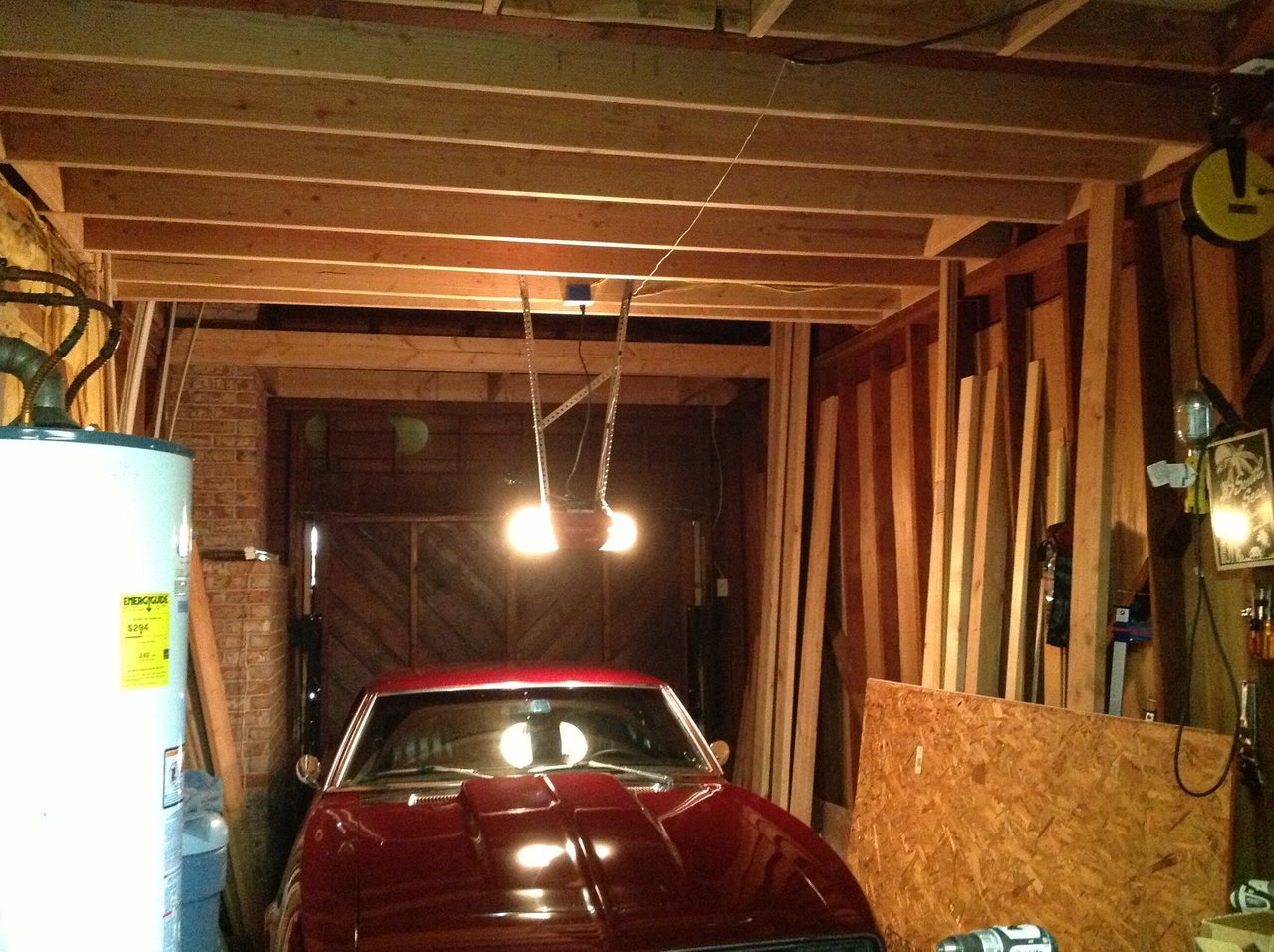

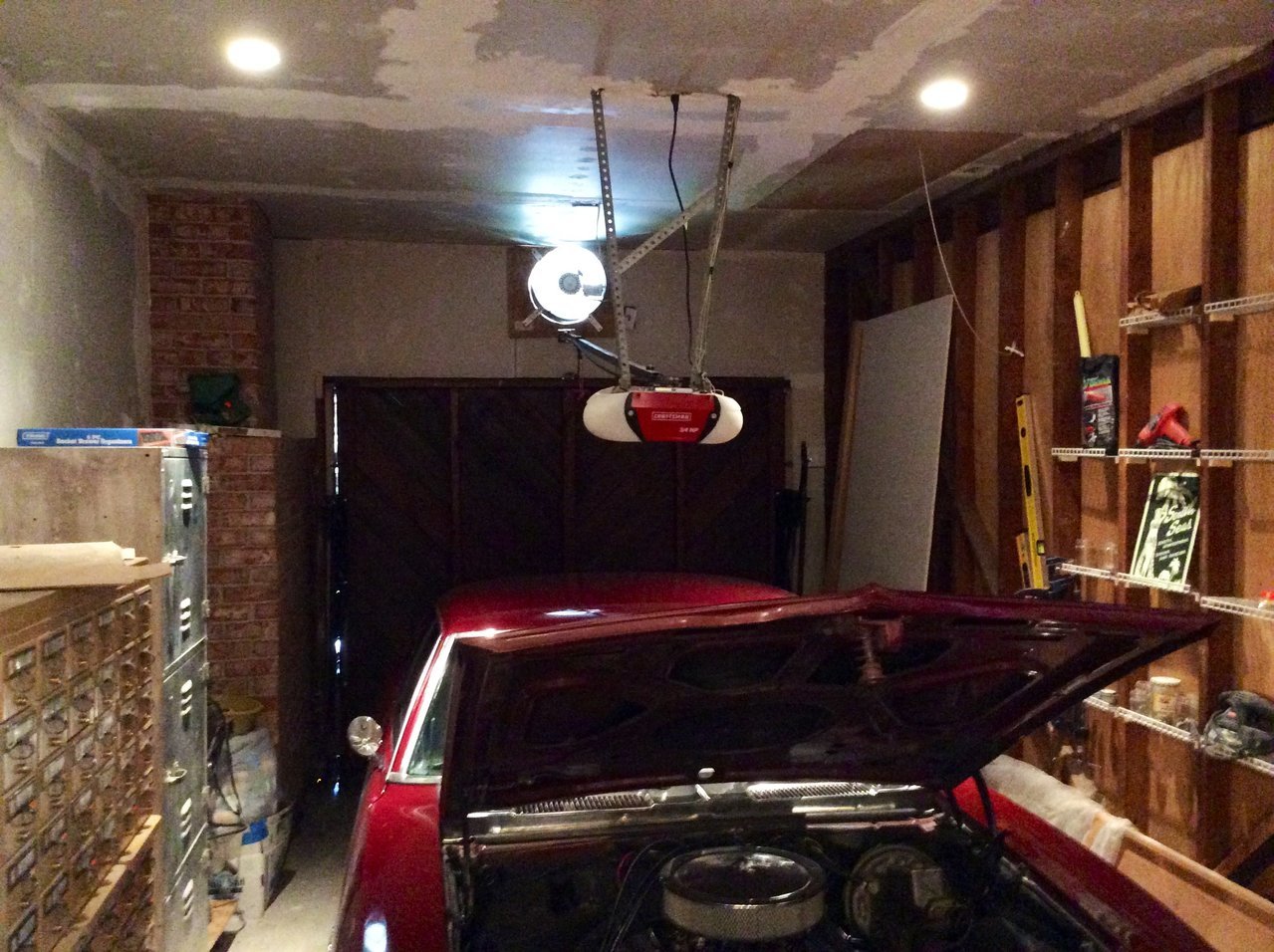

    I can't speak for him but mine was a fair amount of work. Really depends on what you're starting with and how far you want to go.
    The first pic is whay my garage ceiling looked like when I bought it, except there was a lot more crap resting on those spindly, sagging 2x4's spanning the width of the garage.
    I wanted to create storage space and needed to beef up the rafters, so I added 2x8's and put them on top of the top plates of the walls (just to get a little more height in the garage). I may have went a little overboard but it wasn't that much more $. I used OSB panels for the floor and also insulated it.
    When I installed the pull down ladder I added a few lag bolts, just because. It's created a lot of usable space where there really wasn't any. If you already have sufficient joists in place then I would say it's a fairly straightforward process and not that hard.

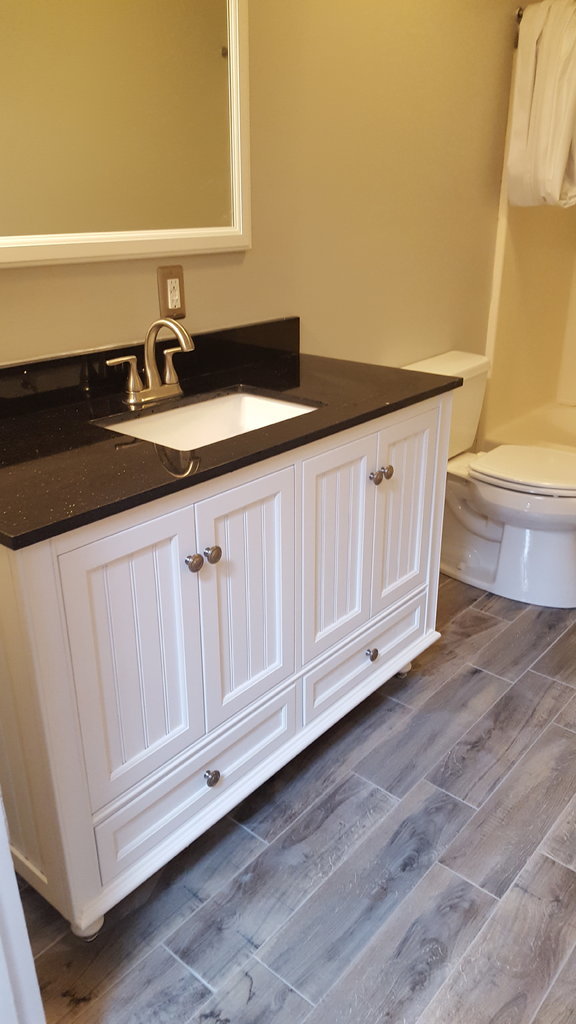

    Not bad for the mountain house...

    what flooring is that?

    It's that porcelain tile from Lowe's that is 6x18...i think that's the size. I really like it.

    Might be 24...none here to measure.

    I'd say 24
