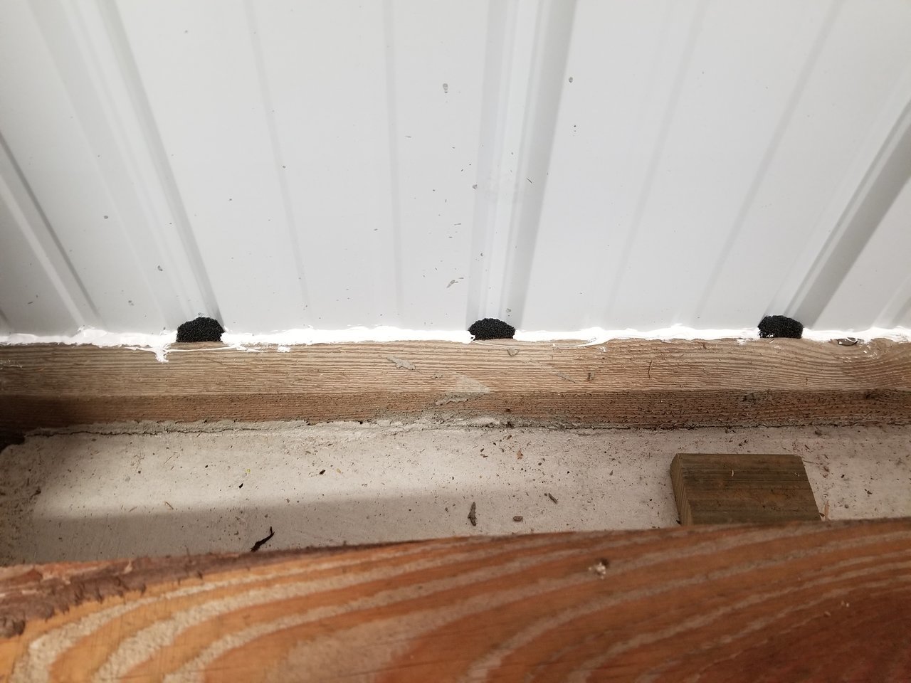

    Holy chit, I've done a lot already!!
    This is what I did. I'm going for the yeti effect :)
    Caulk and leftover ridge vent foam, to allow some air in, and condensation out. Added insect protection
    Spray foam to seal top
    And finally house wrap on the inside of the girts. 6" faced fiberglass will be installed before the walls go up.
    Leaves an insulating air gap, and seals out bugs. That's my story and I'm, hopefully, sticking to it.

    Curious why you guys don't put the housewrap on the strapping prior to the installation of the metal siding ?

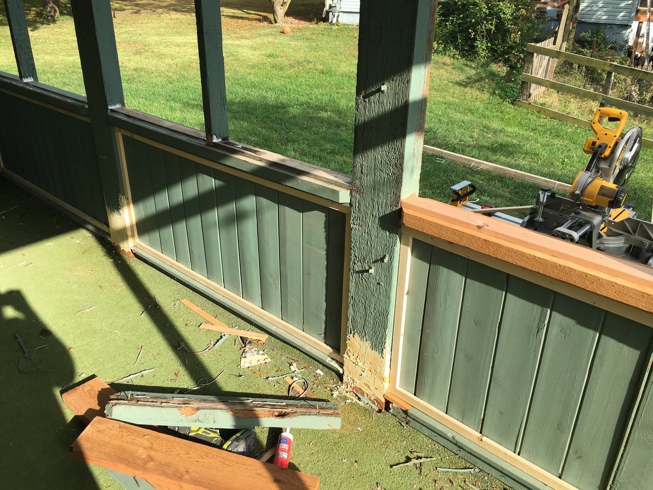

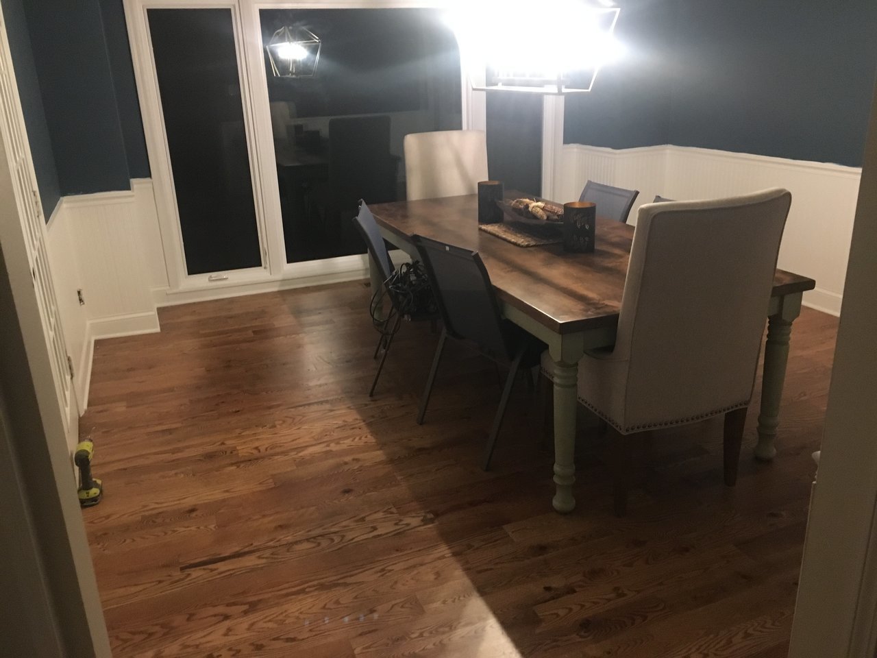

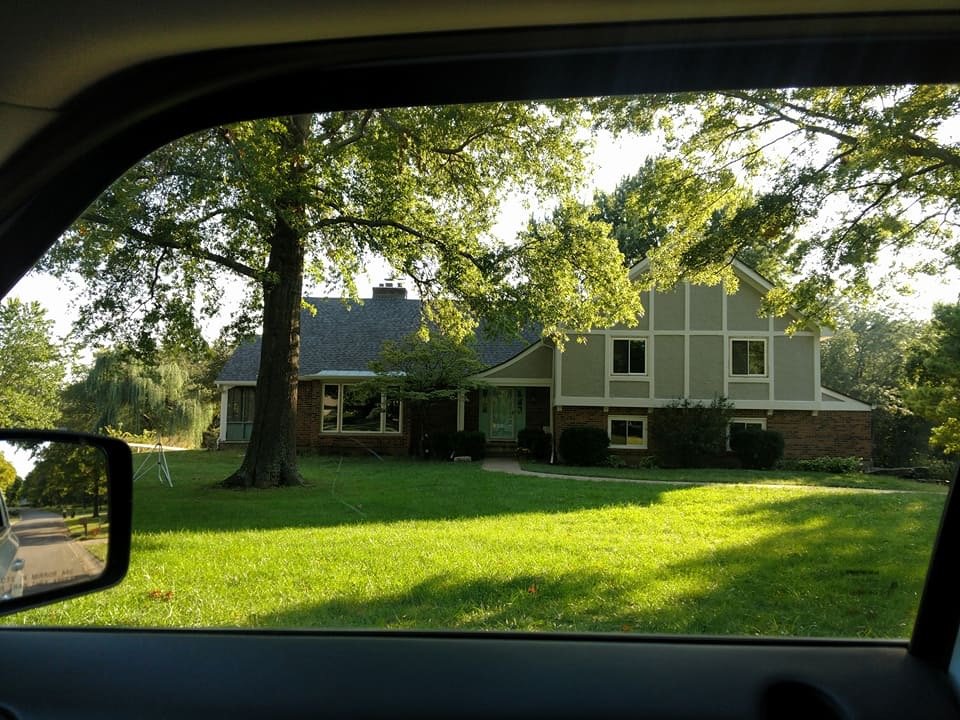

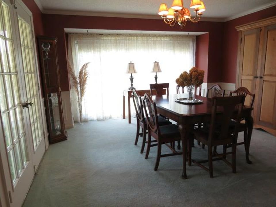

    We've been busy as we work to wrap up our reno…since I last posted, we have:
    - Exterior done - repair/replace rot, new caulk/paint.
    - Finished the dining room w/ new beadboard wainscoting and chair rail
    - Been installing casings, baseboards, and base shoe in all rooms
    - Shiplap accent wall in kitchen eat-in area
    - New windows in entire house, added 2 in lower level
    - Repaired/replaced wood rot in sun porch (painting that this week)
    - Finished master bathroom

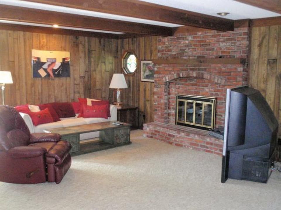

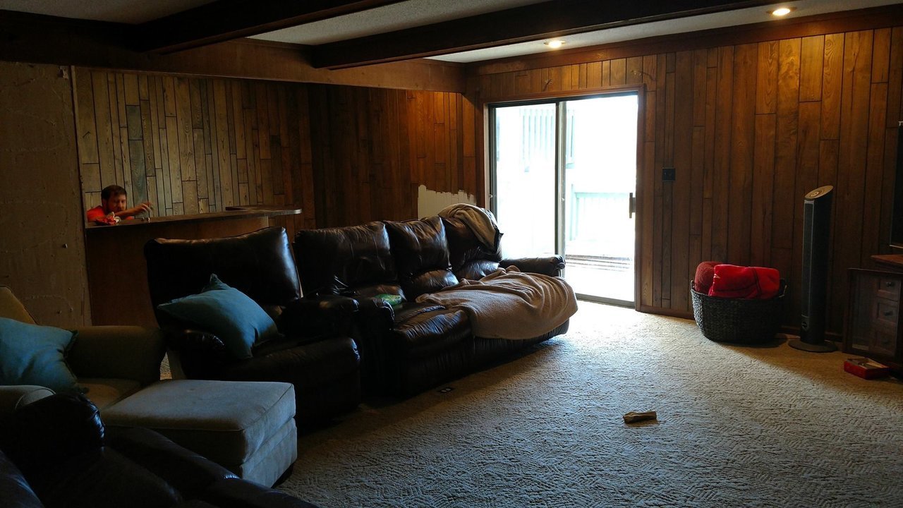

    I’m sure there’s a lot of other random stuff, but those are the big things. We basically have miscellaneous touch up paint (so ignore bad paint lines in after photos) and other detail work inside and out left, and then it’s just down to decorating and such. Only major project left is to rebuild the bar area at some point in the next year or so. In this post are some of the before pictures from the listing – I’ll be adding progress and after pictures in next post. We are not pros…we had no construction/renovation experience before starting this. We’ve just been learning as we go, so it’s not perfect, but I think it’s turning out pretty good for a couple newbies.
    Dining Room.jpg Formal Living Room.jpg Front.jpg Rec Room.jpg IMG_0780.jpg IMG_0783.jpg

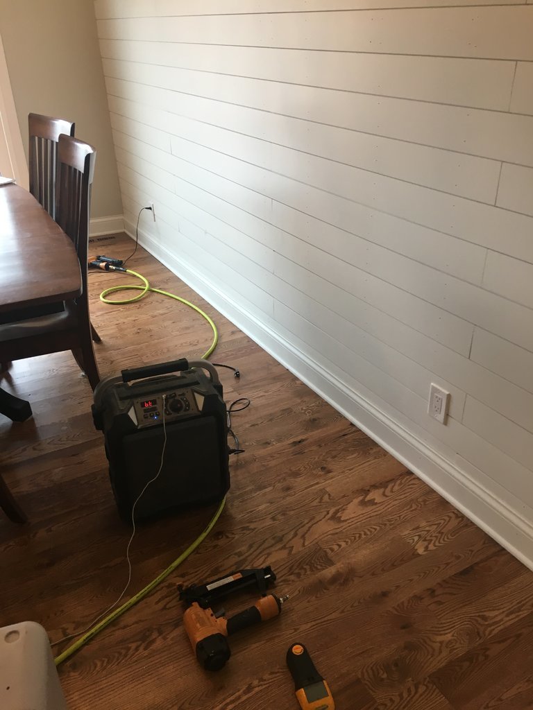

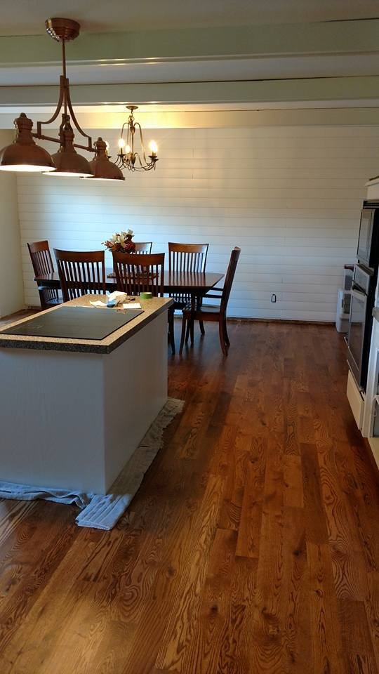

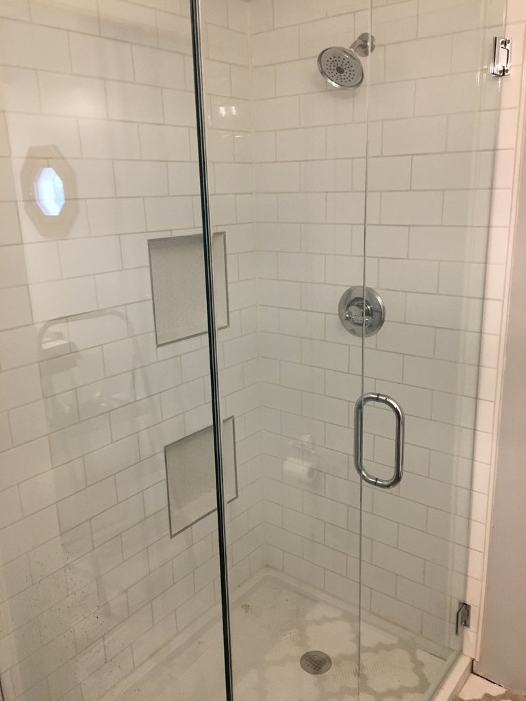

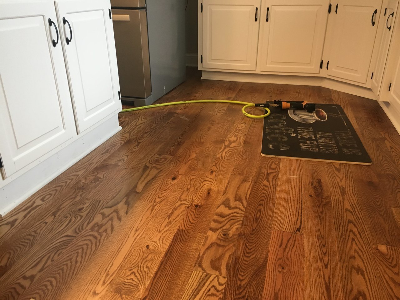

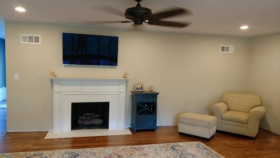

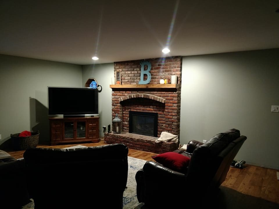

    During/after photos...this is just a sampling, obviously we have a lot more.
    IMG_0779.jpg IMG_0778.jpg IMG_0777.jpg IMG_0786.jpg IMG_0785.jpg IMG_0787.jpg IMG_0782.jpg IMG_0463.jpg IMG_0781.jpg IMG_0665.jpg IMG_0512.jpg IMG_0774.jpg IMG_0773.jpg IMG_0655.jpg IMG_0752.jpg IMG_0753.jpg IMG_0771.jpg

    For me it was an afterthought. Plus I would prefer to leave the air gap as another "layer" of insulation.

    Good question
    Was told to spray foam barn so didn't think about it. Then started thinking about other possibilities. Metal horse barn was built by a crew that can't understand we're going to live in it.
