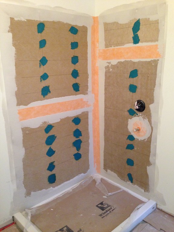

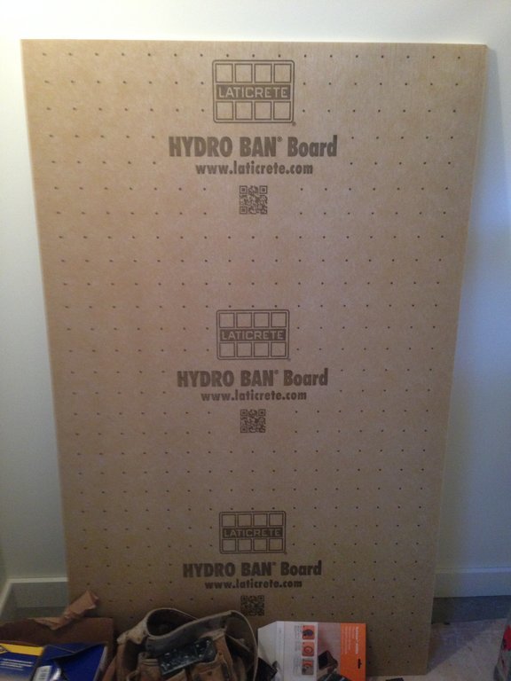

    Tile guys started at the job today . He's using a new to me product that he has switched to instead of Schluter Kerdiboard .
    Laticrete Hydro-Ban Board
    Its way stiffer in the same thickness as the Kerdiboard and requires no barbed washers to fix it . He still prefers the Kerdiband for seams but the screws are getting brush applied waterproofing

    Is that a special tape for the seams?

    KerdiBand

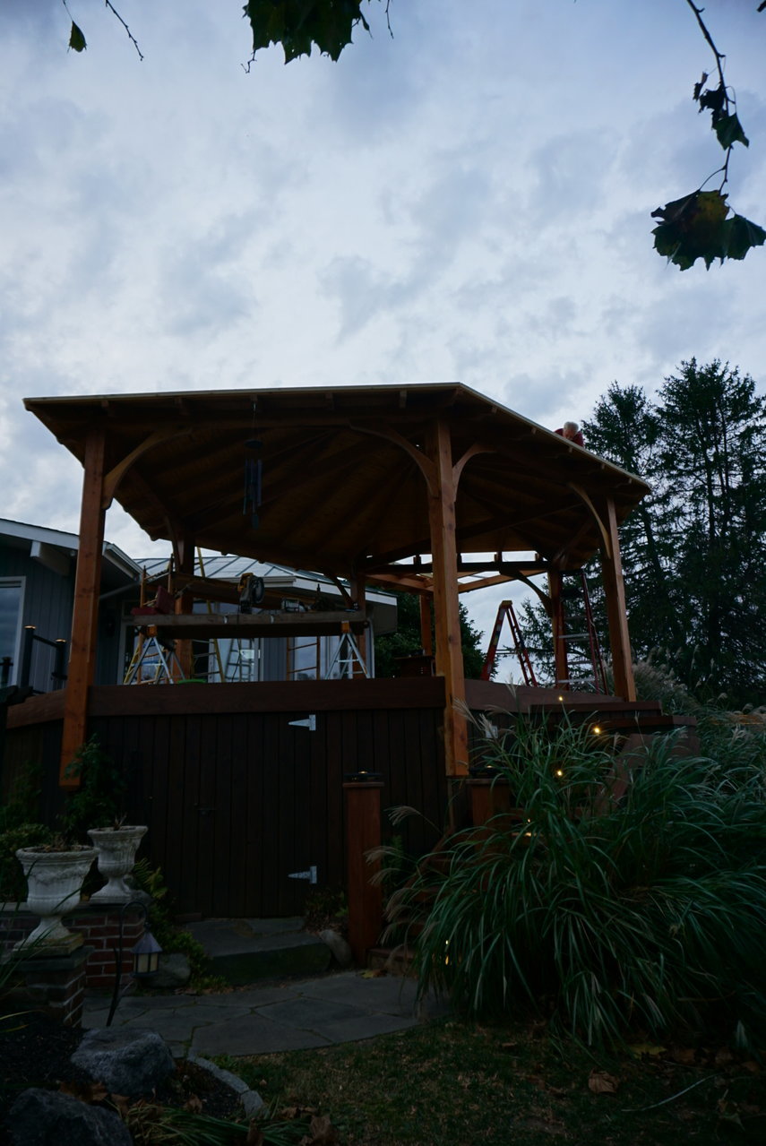

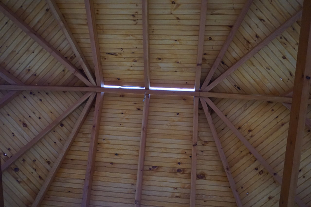

    That looks awesome...Id like to build something like that in the back yard where we live now. Is that something you have plans/instructions for or what?

    Plans? Nada

    Looks great man!

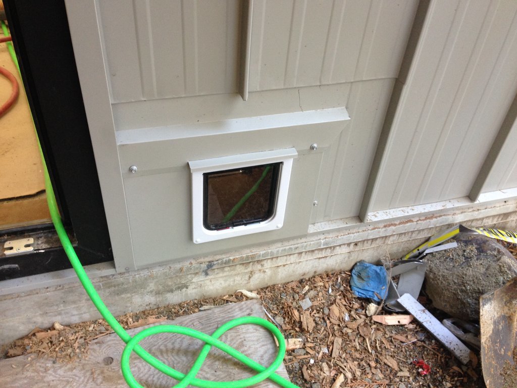

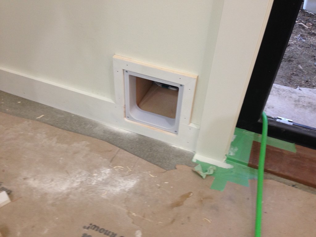

    World's most expensive cat door completed

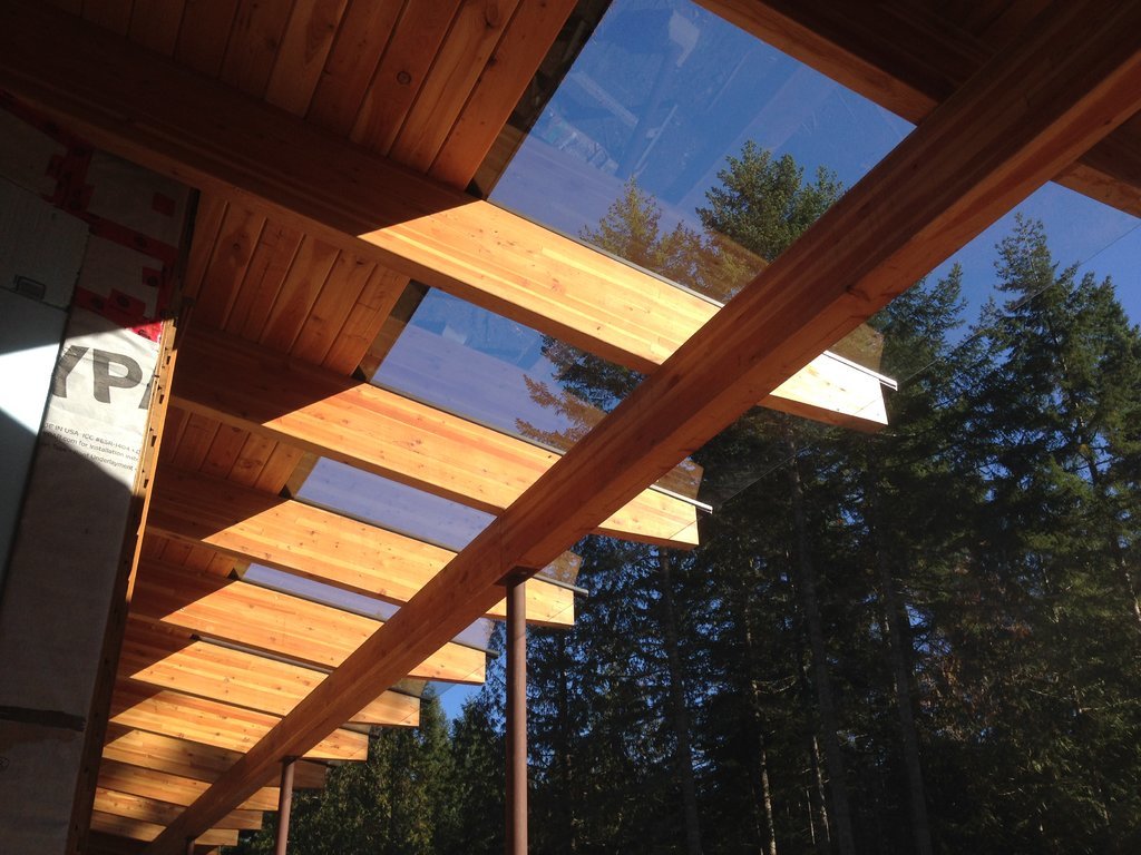

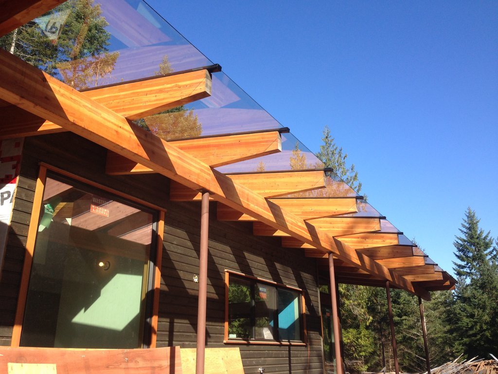

    And the glaizers came today and installed the eave skylight system

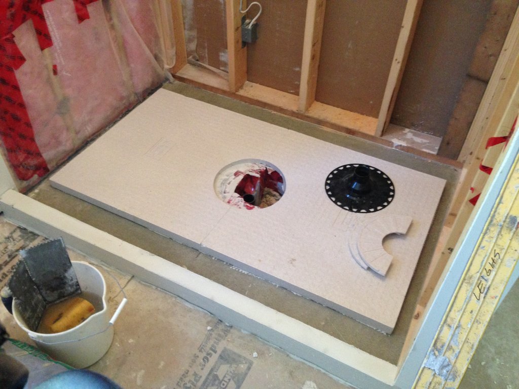

    Also got the Schluter pan and a laminated concrete board sill down so we can start the ensuite shower install

    The glass looks amazing

    The skunks will appreciate that well-crafted cat door.
    Eave skylight is awesome. You can stargaze when it's raining. Oh, wait.

    Had a good friend that came home to a pantry full of raccoons having a party...

    You can lock the cat door duh

    Training the cat to use the key is the tough part duh.

    I installed a cat door with a magnetic latch and only our cat with the magnet could walk through it. Seemed to work ok...

    That's actually a pretty smart design!
