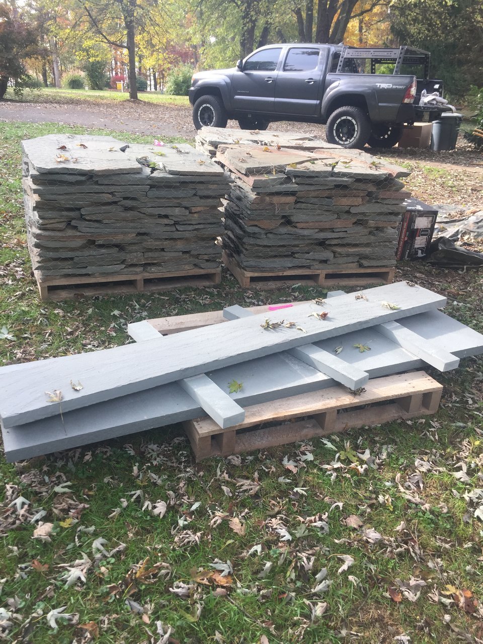

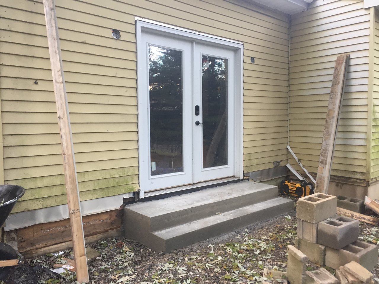

    And two days later we have steps poured. It's not perfect, but it's square and level. Bluestone treads are going on top and stone veneer on the risers.

    Level? should pitch slightly out to shed water. Especially important in the winter. Looks good, will they get a seal coat and paint?

    Haha yea by level I mean it's about a 1/8-1/4 inch slope. They're getting bluestone tread on top and stone veneer on the risers.

    +1 For including the Taco in the pic:thumbsup:

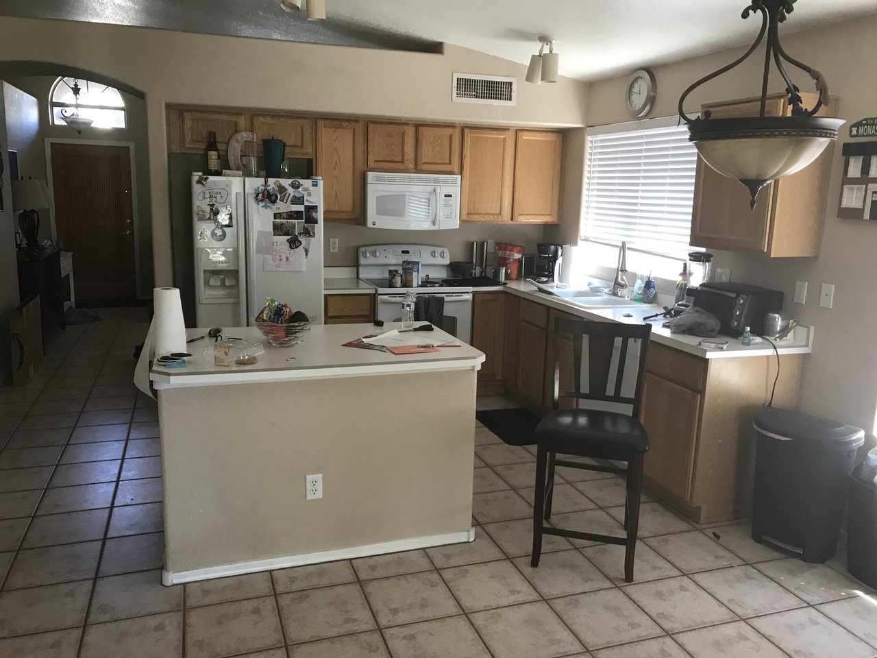

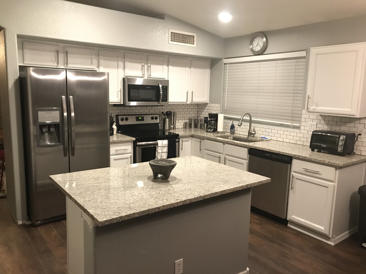

    Kitchen done:

    That's awesome. What kind of flooring is that?

    Same cabinets just paint and new hardware?

    But tile to wood tho

    I like the wood over the tile.

    This looks amazing! What paint/process did you do on the cabinets?

    https://www.homedepot.com/p/Home-De...oring-12-19-sq-ft-case-368301-00257/205833280
    Yep. Sanded, deglossed, high bond primer and extremely durable paint. All doors taken off and painted with high quality brushes/rollers. It took a long time and I'm a very good painter, but they look like they came white from the factory.
    https://www.sherwin-williams.com/homeowners/products/extreme-bond-primer
    https://www.sherwin-williams.com/homeowners/products/emerald-urethane-trim-enamel
    But ugly ass 1990s tile to beautiful dark wood tho.

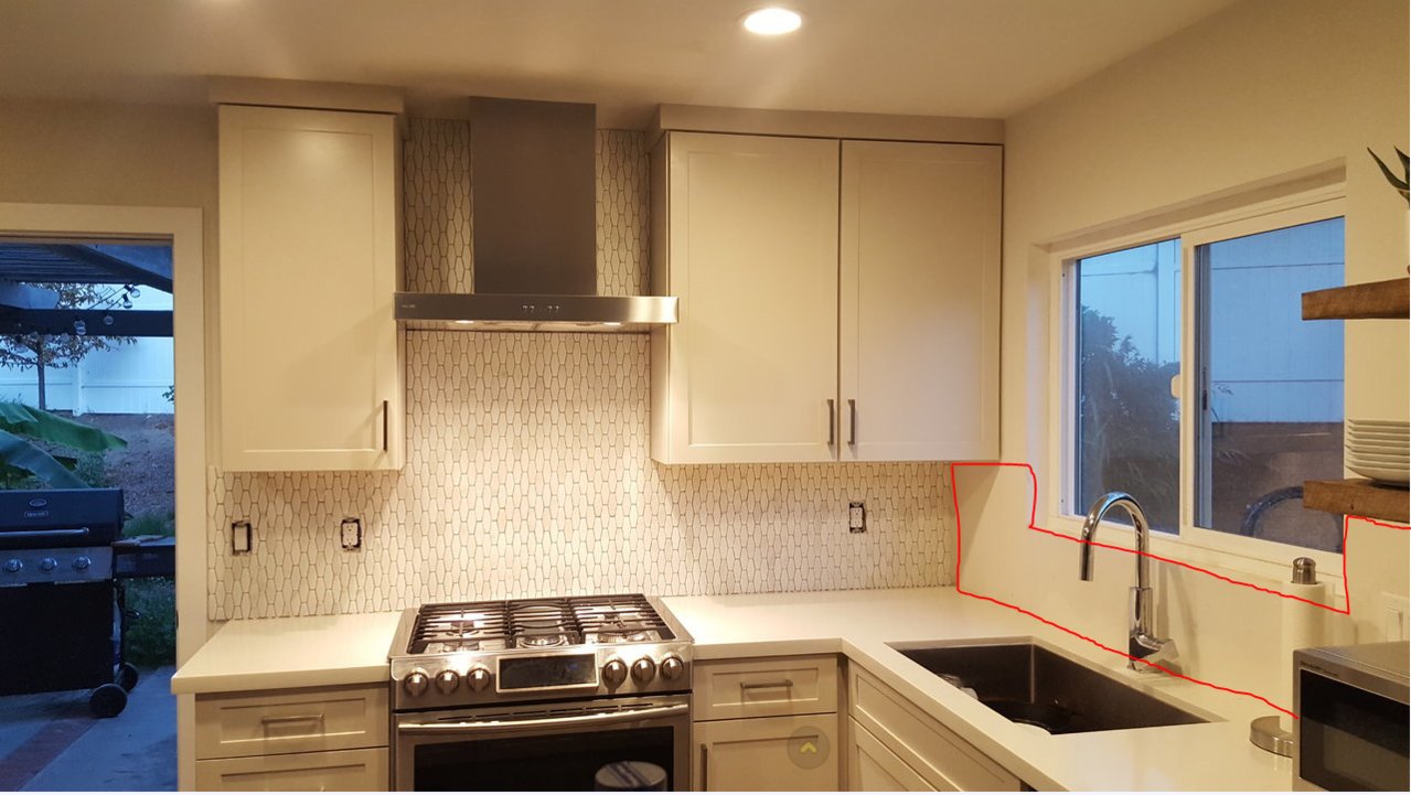

    Working on a backsplash for the kitchen..
    Question, how should the right corner go, as I continue on the sink wall?

    I always start from either end and then meet in the corner so my cut tiles are back in the corner and not on the edge. If I were doing it I would start from right to left on that wall. You may actually want to layout the tile around the window first to make sure it doesnt look stupid with 1/2 tiles on one end or the other, and then work out from there. They're so small that it probably doesnt make a difference on the ends.
    Edit: You might want to take off the right cabinet door after verifying that there won't be any clearance issues with the tile. That sucker is close to the wall. (assuming you're tiling the whole wall like the stove wall considering you've got those open concept shelves, which I would take off and tile behind to make your life easier.)

    ^^ This
    I would do it like this if it were my house. Easiest best way to do it. Typically the whole wall is not done behind a sink. At least for what I have to deal with. I am sure the higher end hopes do the whole wall. Just seems like it would be too busy with that size of tile and shrink the rooms feel.

    I agree, except with the open shelves It seems like it would call for full wall tile.

    Definitely going to bring that right cabinet door gap closer to the left door, to accommodate the full tile wall and not have any weird gaps. I agree with taking off the floating shelves and installing tile all behind it.
    I hear ya, but wife wants it all done, and it wasn't to expensive $5/sqft x 65 sqft. The open shelves call for tile to be done.
