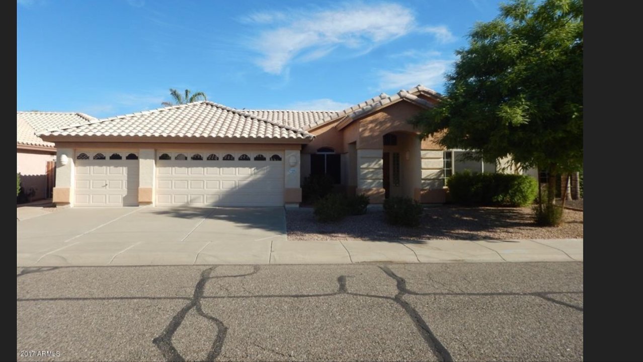

    IMG_0749.PNG.jpg Made settlement yesterday on a house in Phoenix. Place is in great shape but needs updates. First thing i did yesterday was replace the broken garage door opener on the double door. Here's my question.... I've got a free garage door opener with an 8' door sized rail. Mine are 7'. Can I use the 8' opener on the 3rd bay and just adjust the max up and down accordingly?

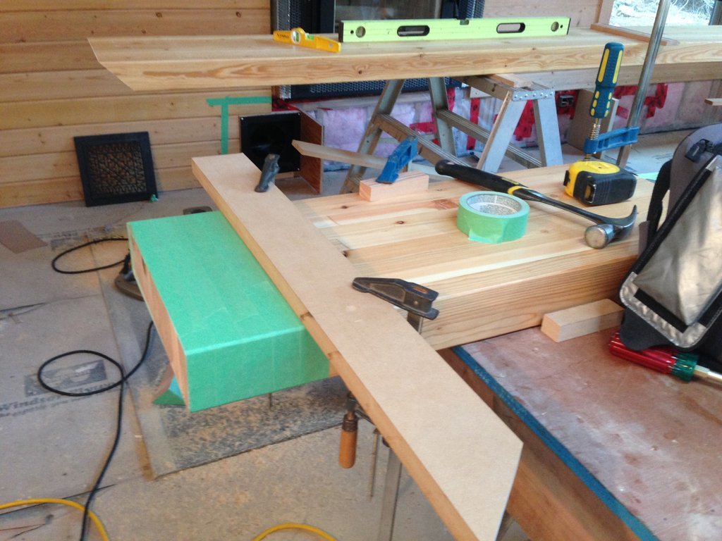

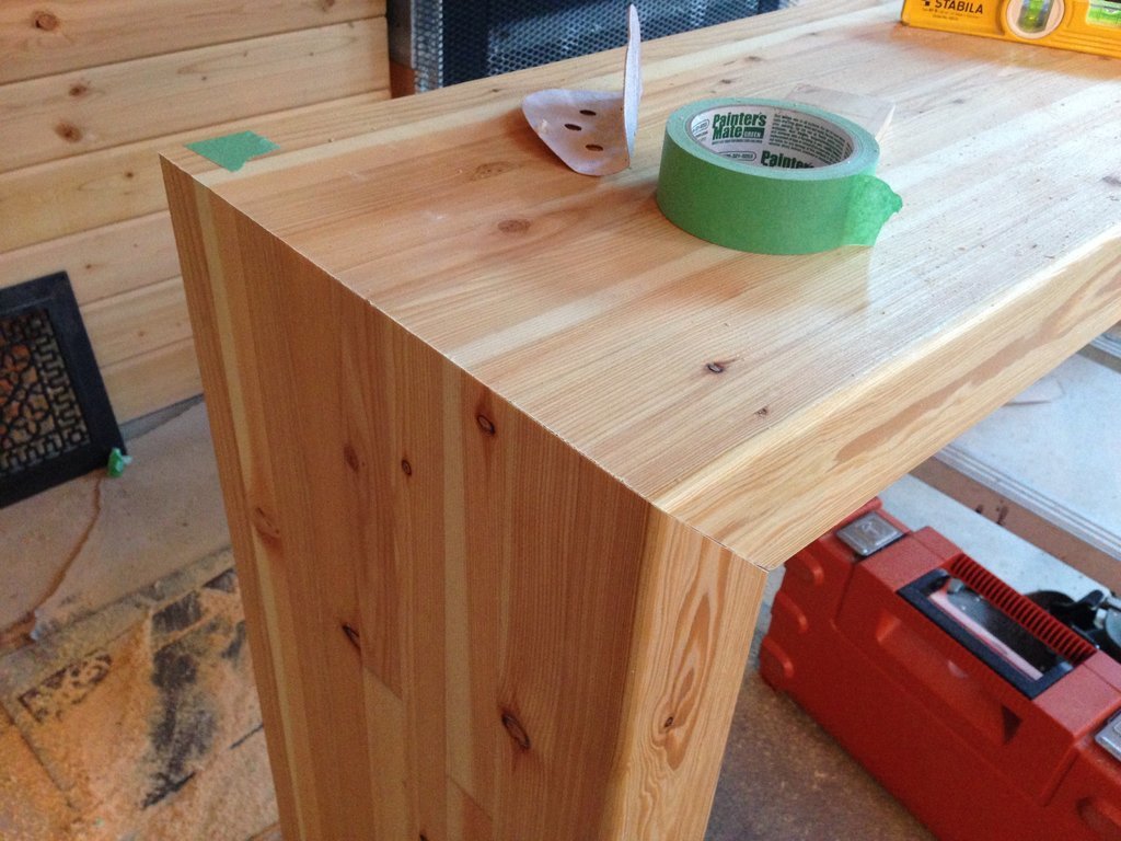

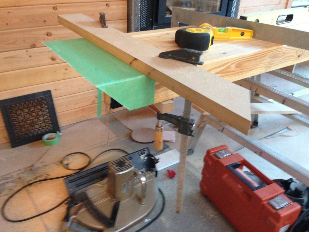

    One of my last major carpentry jobs at this house is scribing and fitting a glulam bench that runs on the fireplace wall , same wall as the fir t&g cascade
    The far right hand end is supported on a low cabinet but the left end waterfalls with a mitred end into the floor
    Trying to get a decent mitre in a piece of wood that is 3 1/8" x 13 1/2" is a bit of a challenge and my only saw that will cut that thickness at a 45 degree bevel is my 16" Makita circular saw
    Started with a 16' glulam , figured out where the waterfall would drop to the floor and added 2" so I can scribe the non waterfall end to the wall after I'm certain my mitre joint will work
    I cross cut the piece square with my 10" Makita circular saw , then taped off the end , clamped on a fence square to the edge and cut a 45 on it with the 16" saw
    Taped off the end of the off cut , clamped on a fence and cut that end with the 16" saw at 45
    Dry fit looks pretty good , happy with the grain wrap
    That was end of day , the water fall will get fit to the floor Monday and I'll connect the two pieces
