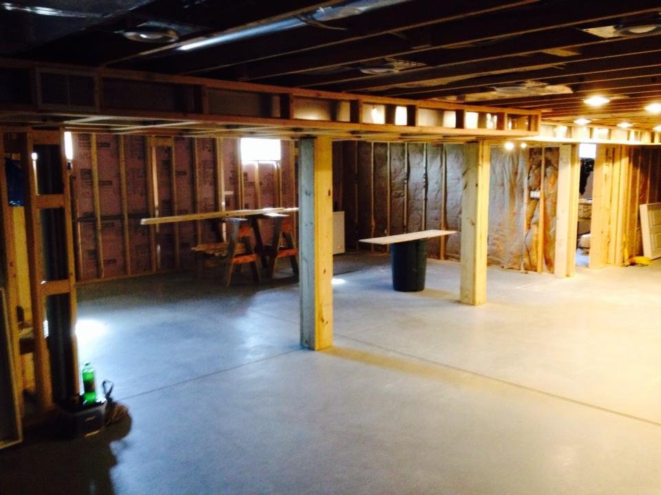

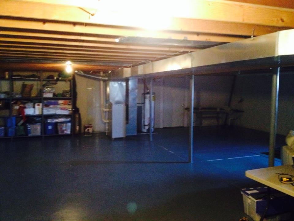

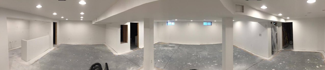

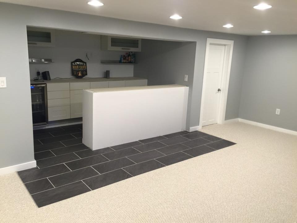

    Well, this project is a couple years old now, but here is my basement finish project.
    upload_2017-12-14_9-11-1.jpgupload_2017-12-14_9-11-23.jpgupload_2017-12-14_9-11-47.jpgupload_2017-12-14_9-12-6.jpg
