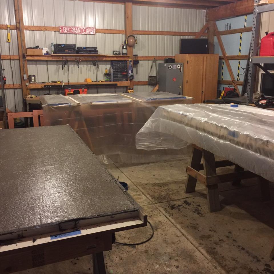

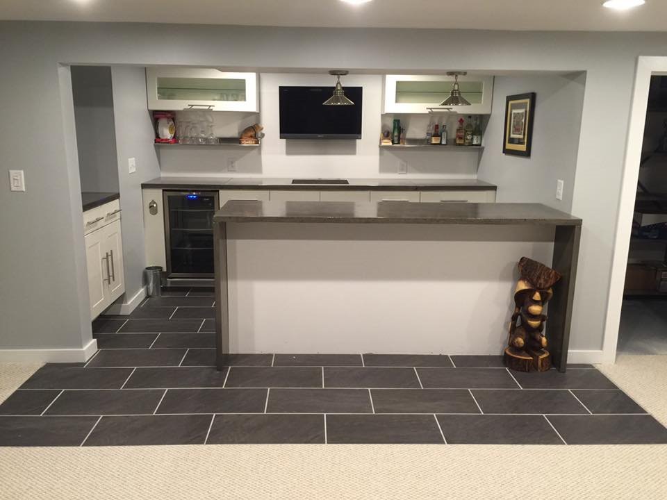

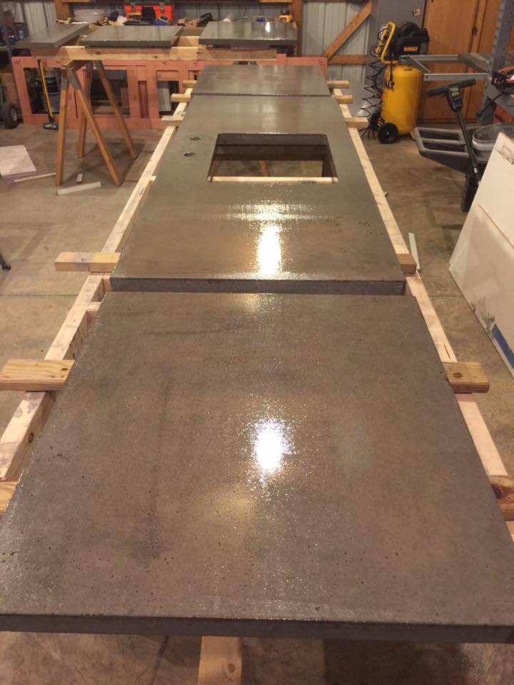

    I love concrete countertops the more I see them. Espcially nice that you can put hot pots on them and not have to worry. Hate taking pans out of the oven and having to find oven mitts/towels to put them one

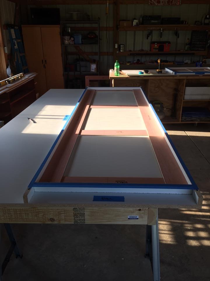

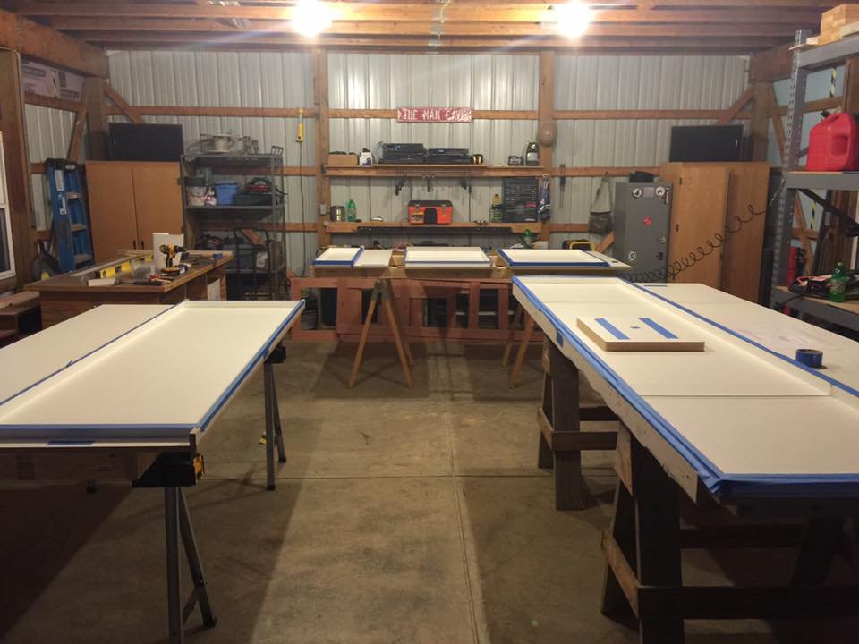

    Nice job on those countertops. I made concrete countertops as well. It was a fun experience. Was this your first time making concrete tops?

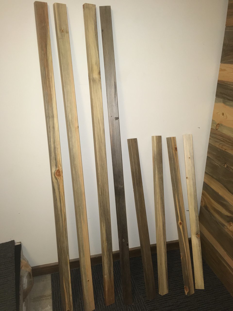

    Last bits of trim arrived. Should have this wall build done this weekend.
    Then it's time to build the modular workbench and lockers.

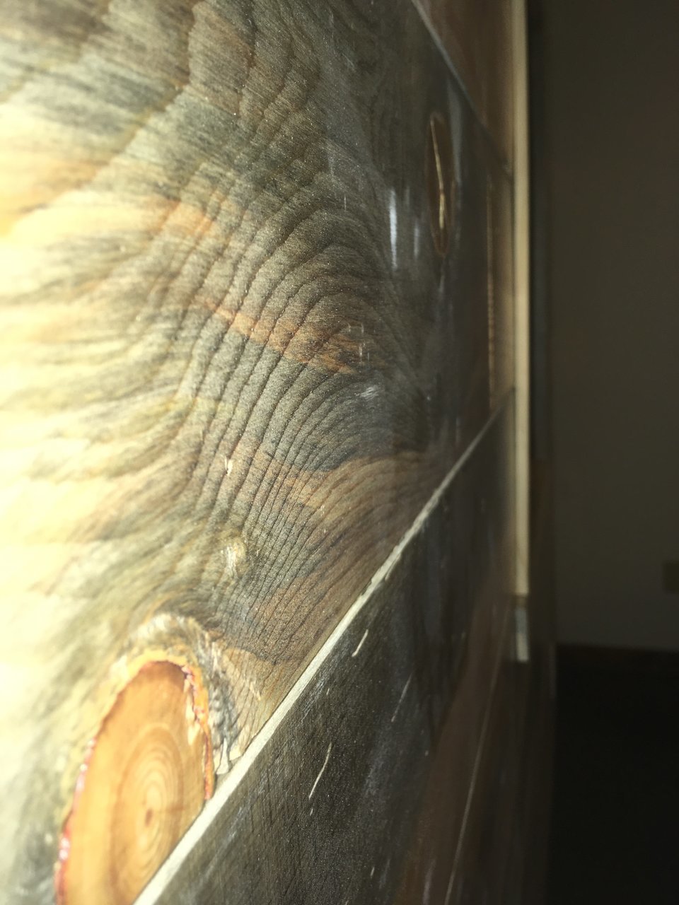

    Love the rough cut wall

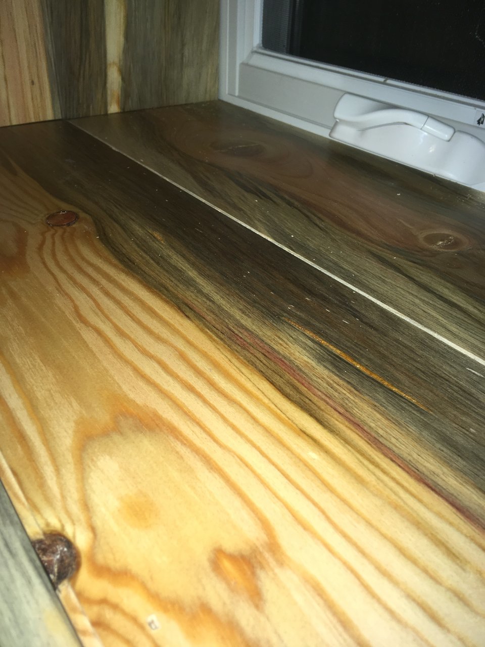

    Then paneling is satin clear beetle kill pine T&G. It's smooth but the color variations make it look rough. I guess there is bug holes and such in there too.

    Either way ....pretty wood...I did something similar to my basement area.

    Thanks. It was a bit pricey, but looking at it now it was well worth the effort.
    Had a casement window that leaked pretty bad... as in there was a distinct waterline on the glass. We brought in a remidiation company to discover the extent of the water damage since there were mushrooms starting to sprout in the burbur carpet.
    Damage was limited to a big bell curve with the window at the peak. Ripped out the the block, and carpet to the slab.
    We were getting an egress put in the spare bedroom, and the installer gave us a 50% discount on window number two. So in an egress went.
    Wall is 1.5" pink foam board with all edges filled with pest control greatstuff and seam taped. Then a 2x4 wall with the studs sideways floating on top the foam. More 1.5" foam in the stud holes, sealed and taped. 3/4" furring strips then paneling. Over built, yes.
