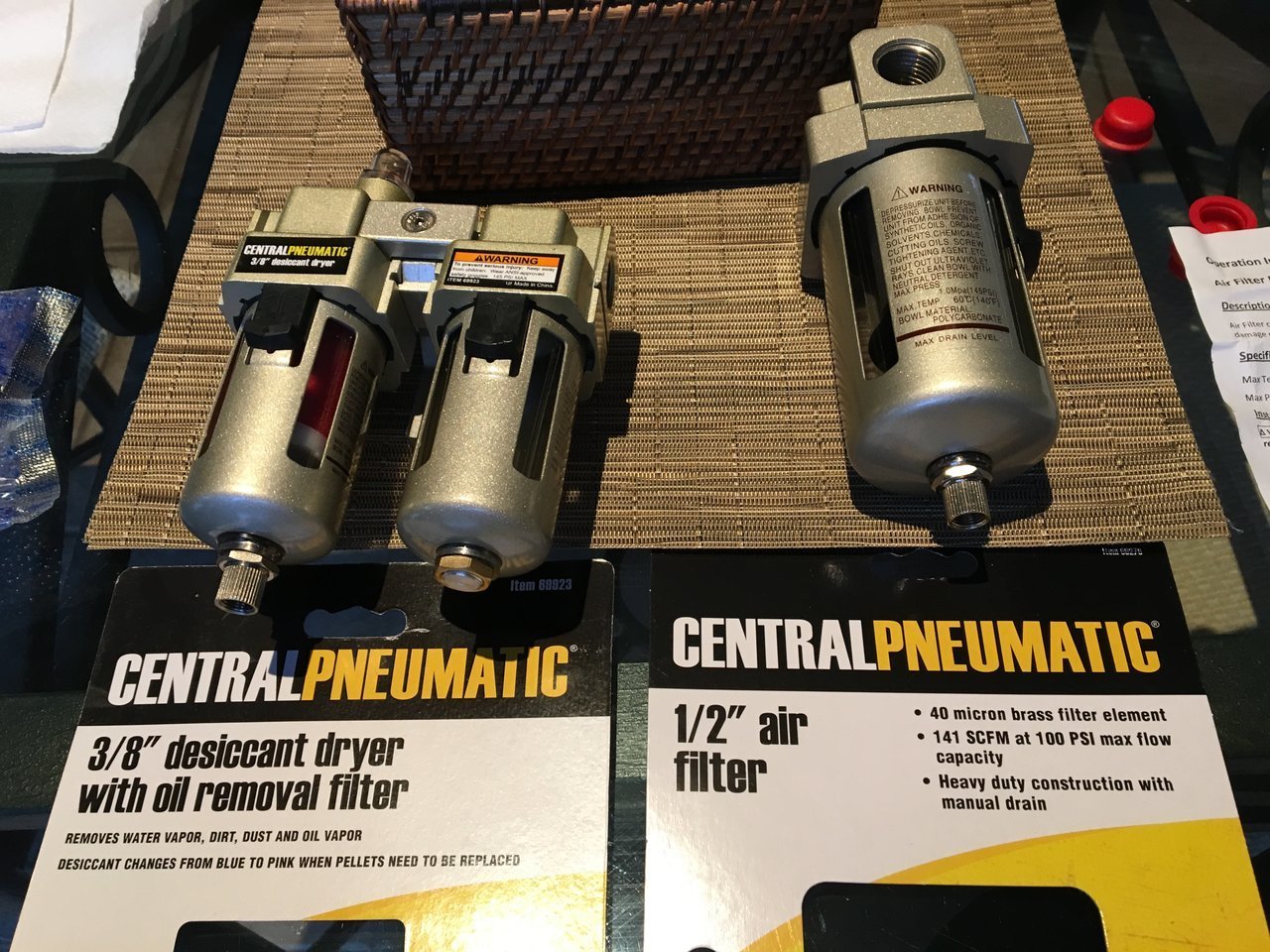

    Who knows anything about air compressors?
    I bought 3/8 desiccant dryer with oil removal filter and a 1/2 air filter.
    Do I need the independent 1/2 air filter or will the desiccant/oil filter combo will filter the air the same? I intend to use paint spray guns and a sandblaster on top of normal air tools.
    I was planning on running both of them in series. Is it completely unnecessary, or will the combo filter work fine?
    Also, can I run the filters horizontally with the bottoms facing towards the tank or will it interfere with the drains and/or operation?

    First, dedicate a hose that is used only for the spray gun. If the hose ever had Oiled air going thru it it will screw up the paint.
    Second, not many people need an air oiler. Tire shops are about the only ones that need an oiler. The rest of us can oil our tools at the point of use.
    As for the dryer, use that only for drying un Oiled air when painting. The same goes for if you are doing any sand blasting. For that matter I don't think a desiccant dryer will keep up with a sand blaster. They make lots of moisture and it would soon overload the dryer.
    Those need to remain vertical if you use them.

    Thanks for the help. So do I even need the independent air filter at all? The combo filter isn't an air oiler, it's an oil and water remover.

    Kirk beat me to it. I would use the combo and forgo the stand alone filter.
    But I second the opinion about having the dessicant filter in a dedicated outlet to the sprayer. Otherwise you will be changing your dessicant way more often.

    I'm going to assume for most air hand tools whether the air is wet or oiled or not doesn't make any difference.
    I understand I need to use the desiccant filter to make sure the sandblaster does not get clogged up with moisture, would this one suffice? I will be sandblasting way more than painting.

    The dessicant filter should have a cfm rating on it. But from the pic I would say no. You will need a larger filter. Sandblasters use a ton of air. I only have a small blasting cabinet and it makes my compressor work it's ass off. And I do not run a dessicant filter for my blaster.

    How big of a tank does you compressor have? 60-80 cans, I wouldn't bother. The moisture collect in the bottom and you can drain it out easy. Smaller cans, it would help, but only slightly while painting. Sand blasting, it would over load on big projects. But most likely you would have to wait for pressure to build back up anyways.
    I do painting and blasting with my 80 gallon unit. I don't have any of those and see no reason.
    Hint:if you have a bigger tank, put a fitting on the bottom of the tank and connect a hose to that. Use this for blowing the dust out if the shop or airing up mower tires. This makes it easy to remove the water from the bottom of the tank. Lots easier than that stupid pet cock thing they put on at the factory.
