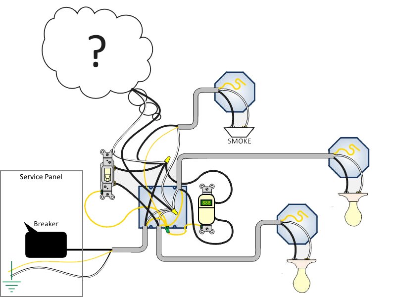

    I think you're trying to say a 3-way switch, and those require a "red" AKA traveler wire. :notsure:
    You are correct though if someone is using a common as a "HOT" wire it does require an electrical tape or other type of flagging indicating it.

    Should i be concerned about that wire? When I had the breaker off I noticed that the smoke detectors and a nearby outlet also went off. In that box is a switch for the exterior garage lights, an exterior porch light (which is the timer switch) and an interior foyer chandelier. One wire comes into the box and the white goes to Black and the black goes to white. I don't believe that wire has anything to do with the switches. I also don't think the previous homeowner would have done any electrical work. When I say she left everything original I mean she even left the plastic film on the refrigerator for 23 years.... That film Kept the little light switch 'button' pressed in so for 23 years there was no light on in the fridge. House was also immaculate and they had service records and manuals and notes for everything. Even have all of the blueprints and landscape design for the place.
    There's a lot of wires in the box but it's really not messy. All the same wire except for the timer switch, all tightly twisted together. I just pulled it back out to make the picture more useful.

    You can always turn off the breaker --> disconnect those wires from the bundle, put wire nuts on the ends --> turn breaker back on and figure out what it goes to and IF it is supposed to be that way or not.

    Ya that's what I was thinking. If it was crossed wouldn't it be tripping the breaker?

    If reversed: the object/fixture that it is connected to it would still operate; however the fixture is now considered to be before the circuit protection (fuse/ breaker). Thus, because it's A/C the power is osculating/ alternating on both conductors(wires) and therefor the breaker is still protecting the circuit. If you had a GFCI or Ground Fault breaker you would further increase the opportunity for tripping the device because these devices are checking ground(green) and neutral(white) for potential differences. I'f you're really concerned disconnect the wires as I said earlier to find out what device it goes to and see if that is wired correctly at the device and you can correct the wiring accordingly.

    yes sorry I did mean a 3 way switch.

    also on that switch in the picture, I'm not an electrician but have always been told not to use the wire push in on the back. better to use the screws on the side.

    Why not? If it is a UL/CUL listed item and you strip the wire only the length indicated on the device there should be no issue. The press in type of wire connection is a permanent connection <-- and this is the only reason not to use the press in connection (for future device replacement you need to cut the wire in most instances.)

    had a few electrical problems when we bought the house. had an electrician come in and changed a few things including a plug outlet that had wires black and melted a little. said it was from what he called plug stabbing. told me they should never use them.

    Back stab are bad, a fire waiting to happen. The back wire outlets, where you push the wire in and tighten the screw are fine.
