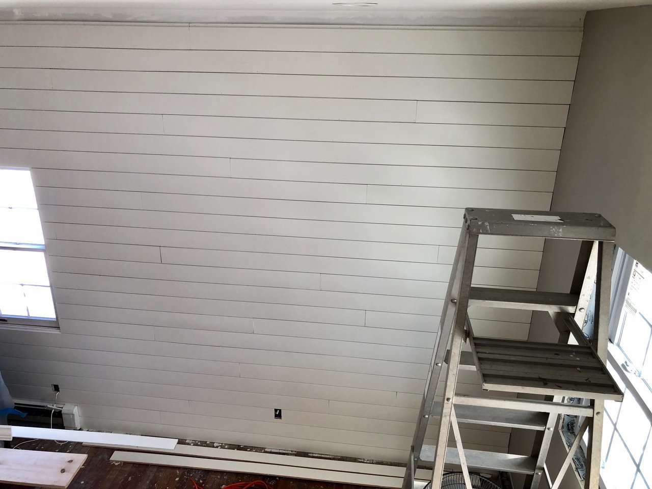

    I just used this in my house and it was really easy to install. Level it and nail it up with finish nailer. I did need a table saw to rip the top board but you could do that with a circular saw and a guide if needed. I just painted it yesterday and still have to install the top piece.

    You can rip ply on those. I do it on my small DeWalt. That's one of the reasons they made fences to accommodate 24-inch cuts. You just need some outfeed support and caution. The thickness and weight of the sheets needs to be in your comfort zone to handle the material safely.
    But yeah, for your project, just buy shiplap. Sooo much easier and better result.
