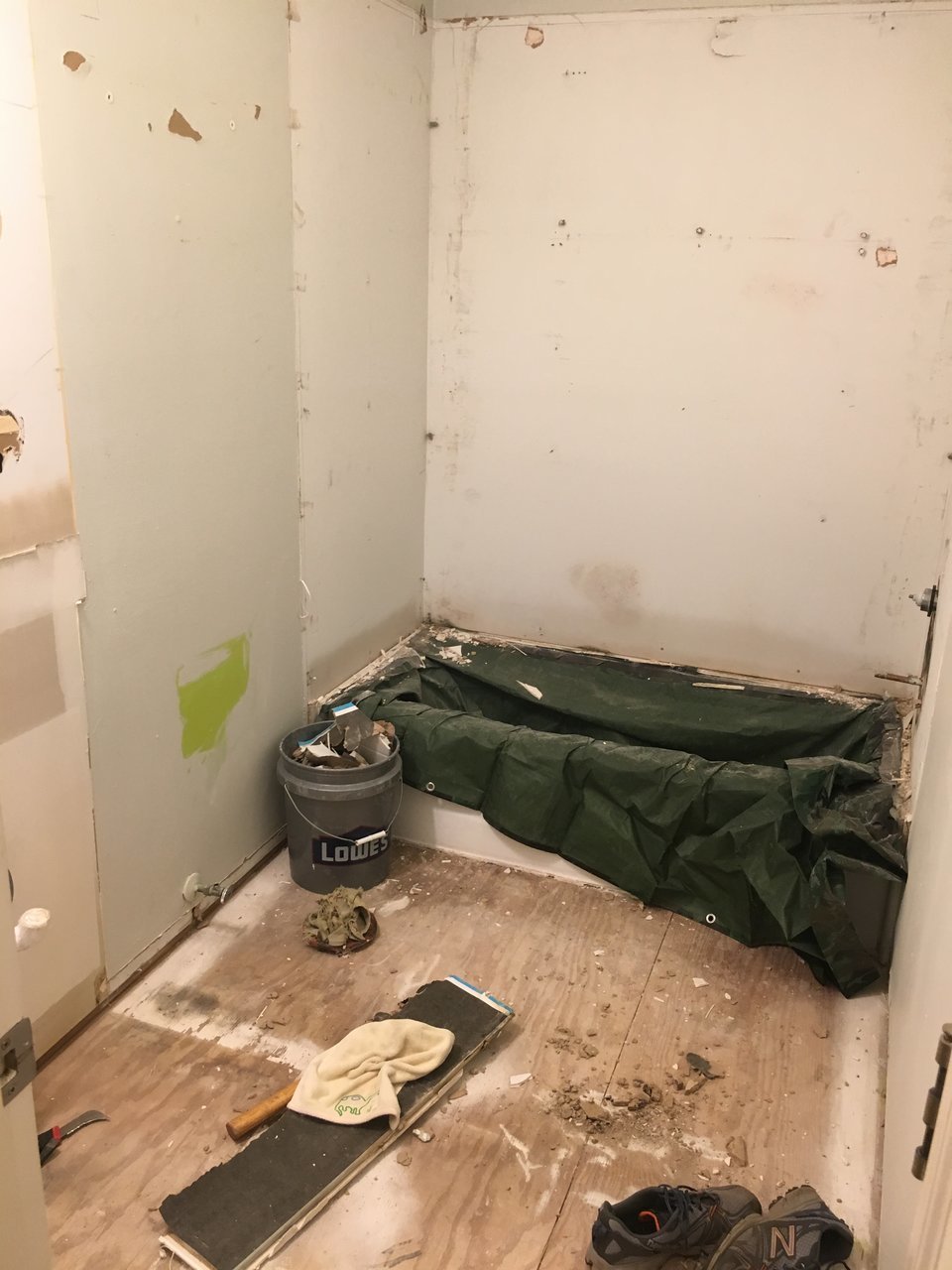

    Since we are talking about tiling around a tub. I ripped my bathroom up this weekend. I was planning on putting Hardiebacker directly on the studs behind the shower then puting a heavy coat of RedGuard and properly taping all the seams.
    1. Do I need a vapor barrier behind the Hardiebacker?
    2. How do you keep water from running in behind the cover plate on the tub water valve? The contractor put green board directly over the drywall and water got between it and the drywall around the valve.

    Is it an exterior wall ?
    There should be a gasket on the trim but you can add silicone
    Use Kerdi instead

    It is not an exterior wall.
    As I need to remove the existing drywall due to some surface mold and softening I think putting the Hardiebacker down will be less work and cost. This is why I wanted to go that route.

    The Kerdi goes over the substrate and replaces the Redgaurd
    I don't mean Kerdiboard
    No need for an additional VB if it is not an exterior wall

    Things like Kerdi and wedi may seem more expensive but are a much easier system to get top notch results from compared to hardi and redguard.

    +1 for Kerdi. Good stuff. Also if you happen to get some mortar or grout on your tub. A magic eraser does a good job at getting it off.

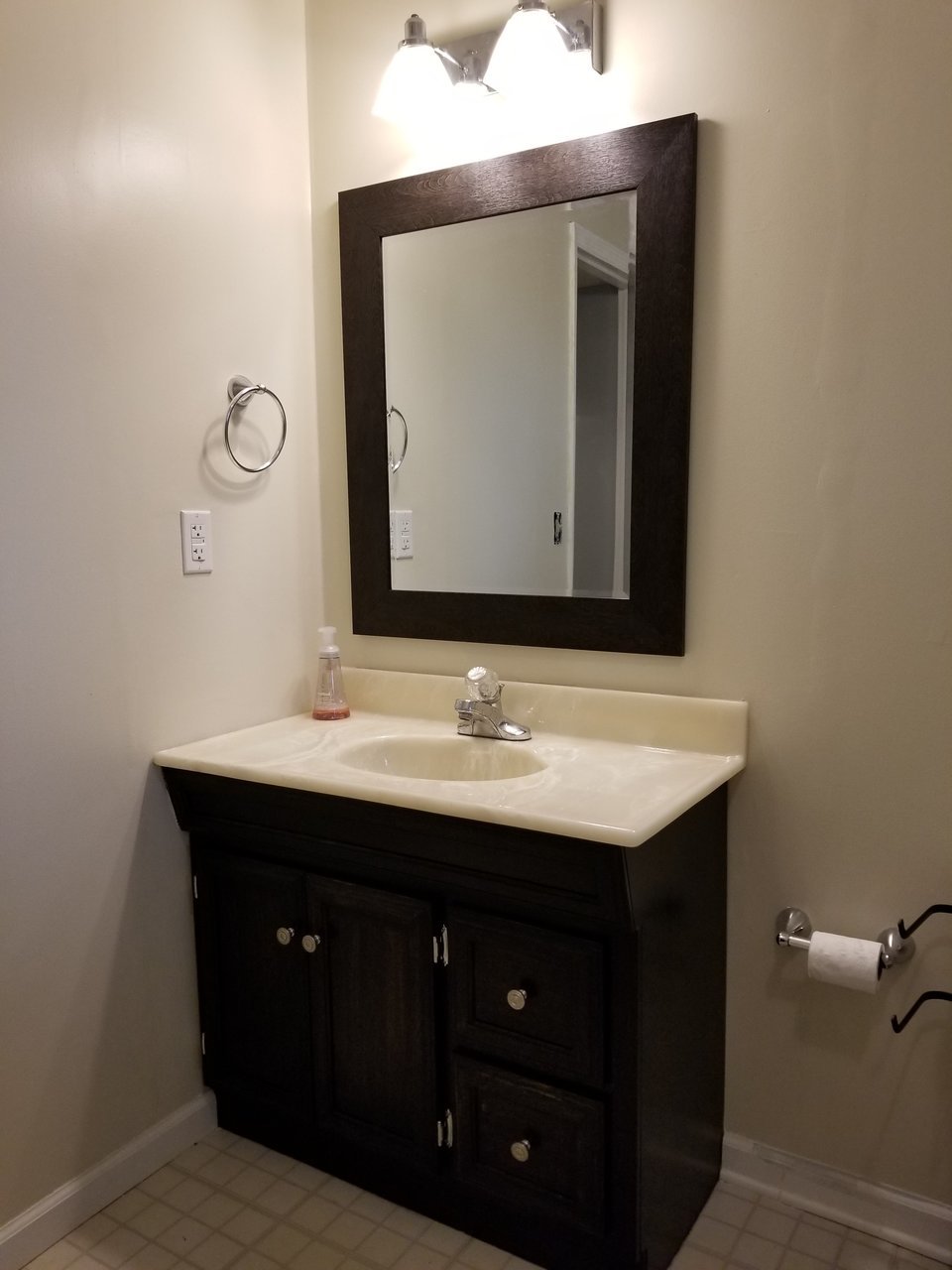

    Basement 3rd bathroom. Didn't want to spend alot. New floors next thinking tile I enjoyed doing it last time. Want to try concrete counter possibly.
    Looks black in pic but it is Java stain iirc
