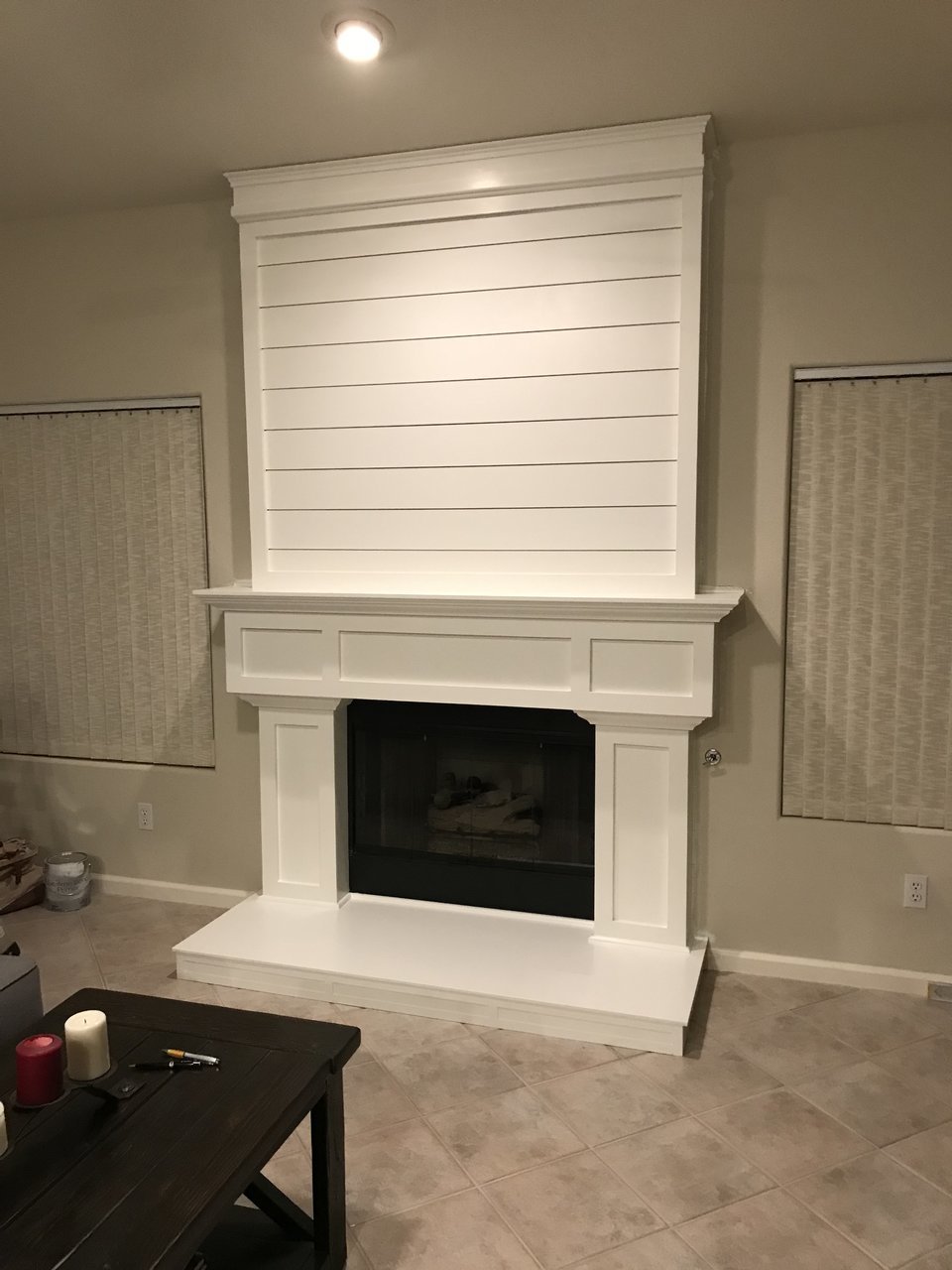

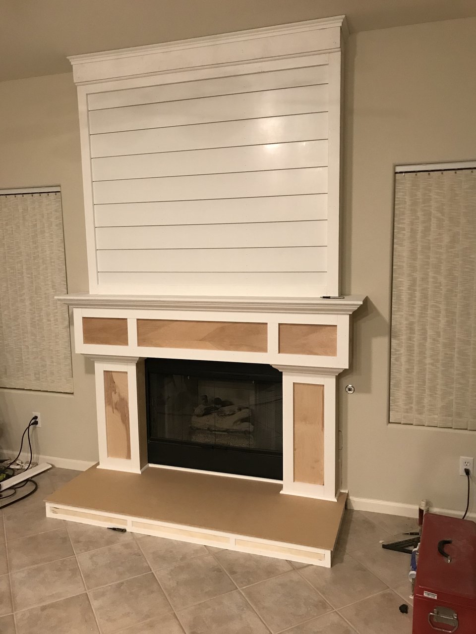

    You did a super job on the fireplace, it looks great! BUT, you should be careful with BIG fires. That would NOT pass a code inspection where I live. Combustible materials cannot be used with in 6 inches of the firebox on the sides, and 10-12 inches above. Same deal with the hearth, not sure of the dimension. I have spent many hours researching local codes for a job we did. The initial submitted drawings were rejected for this very reason. Just a heads up, again, great work!

    Hmmm. I thought about that but isn't the drywall mantle that is still under the plywood just as combustible?
    Edit: Now I'm really feeling like i f*cked this up big time. god dammit. Its a gas fireplace. I only put combustible materials 1/2" closer to the surround but they do stick out probably 1.5 inches further from the wall. I didnt think twice about it because it was drywall before. House was built in 1994, logs vent up through a chimney that is built to be wood burning. The metal surround doesnt even get hot when its on.
    Edit to the edit: Upon further review, I am indeed boned. Going to replace most of the bottom with tile or stone or something. It's a gas log set, it emits practically 0 heat, but I am not f*cking with fire. Taking it apart is going to be depressing.
