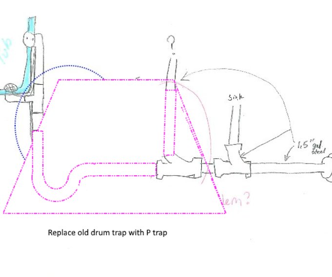

    Had the same problem in a rowhome I owned in philly. plumber told me that drum traps corrode and fail after awhile (in this case about 75 years) and are very hard to clean out if they havent been maintained. Most people ignore it until it becomes a major problem and at the point the best option is to just replace it like you have in the second diagram. Not sure how old yours is, but even if you could get it open, I personally wouldnt trust it even if you could get it closed. I used to plunge mine every few months with 3 plungers. one for the tub drain, one to cover the overflow, and one to cover the sink drain which was literally right next to it. That would work for a few more months. Never did end up truly fixing it.

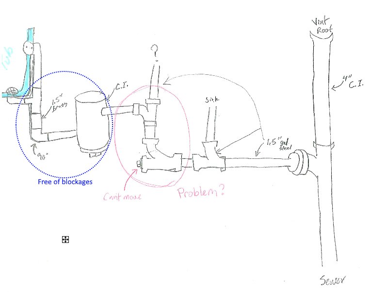

    I thought I may have said this earlier if not: I can get the drum trap open just fine and it is free and clear from the drum back to the tub. In fact the drum is my access point for snaking back to the tub drain and snaking from the drum trap towards the sewer.
    I'm not sure that it is at this point. The up-spout with the question mark (?) above it might be a vent or it could be linked to some-other plumbing in the house based off of the wye???
    I am really seriously considering this option of full replacement of the drum as I am at a loss for what to do...:frusty: It would be an easy fix with PVC and some rubber joiners, however I am now wondering if I would be violating any plumbing code. :help:

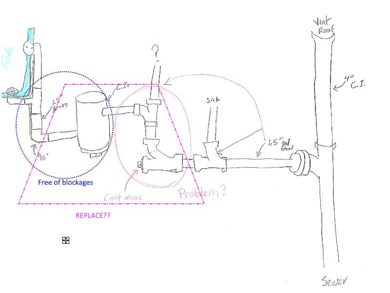

    It is in our basement, pretty open but I don't really think it necessary to replace the entire section, if I replace with PVC it will have a nice easy access clean out port. However when I'm cutting the galvanized steel I might fracture some other joint and have to replace the whole horizontal section...

    Yea, makes sense. It's really odd that you can get in the drum trap no problem but there's still a blockage. That would make me think it's not the drum trap.

    I did all my normal troubleshooting before coming on here to ask. I had gone through already tried all the suggestions that everyone has suggested so far.
    My original post had this image. Showing where I think the problem is. The end cap of the horizontal run that has the note "can't move" I heated the joint, added penetrating oil and even used a 30" pipe wrench with no budging. (I even hit the cap with a 20oz framing hammer a few times.)

    Instead of replacing just the blue circled portion to get rid of the drum trap, why not cut out and replace the red circled portion? Is that a vent?
    Edit: Can you just cut out and replace the 'can't move' 90?
    Toyko Joe[QUOTED] likes this.

    :hattip:
    Great Idea!
    This way I won't be changing anything as far as installation or function or code! Added bonus, if I just replace this part I can ensure the wye and up-spout pipe are 100% clear and snake the horizontal while I have it open!
    I'm glad I asked for a different perspective here.
    I think I'm going to get one of these. I'll still need to verify this is acceptable per code for a horizontal but I have a good feeling this can be solved quickly.
