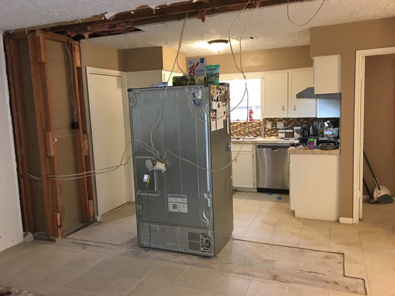

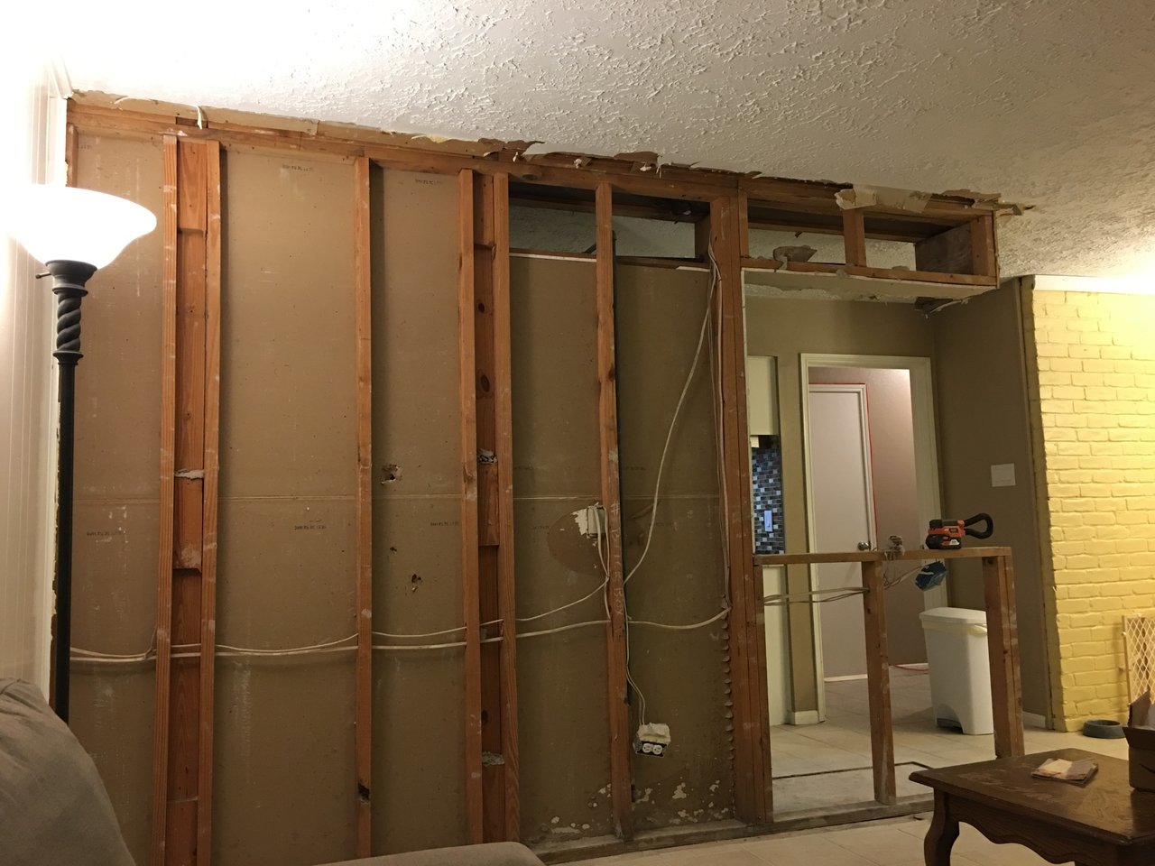

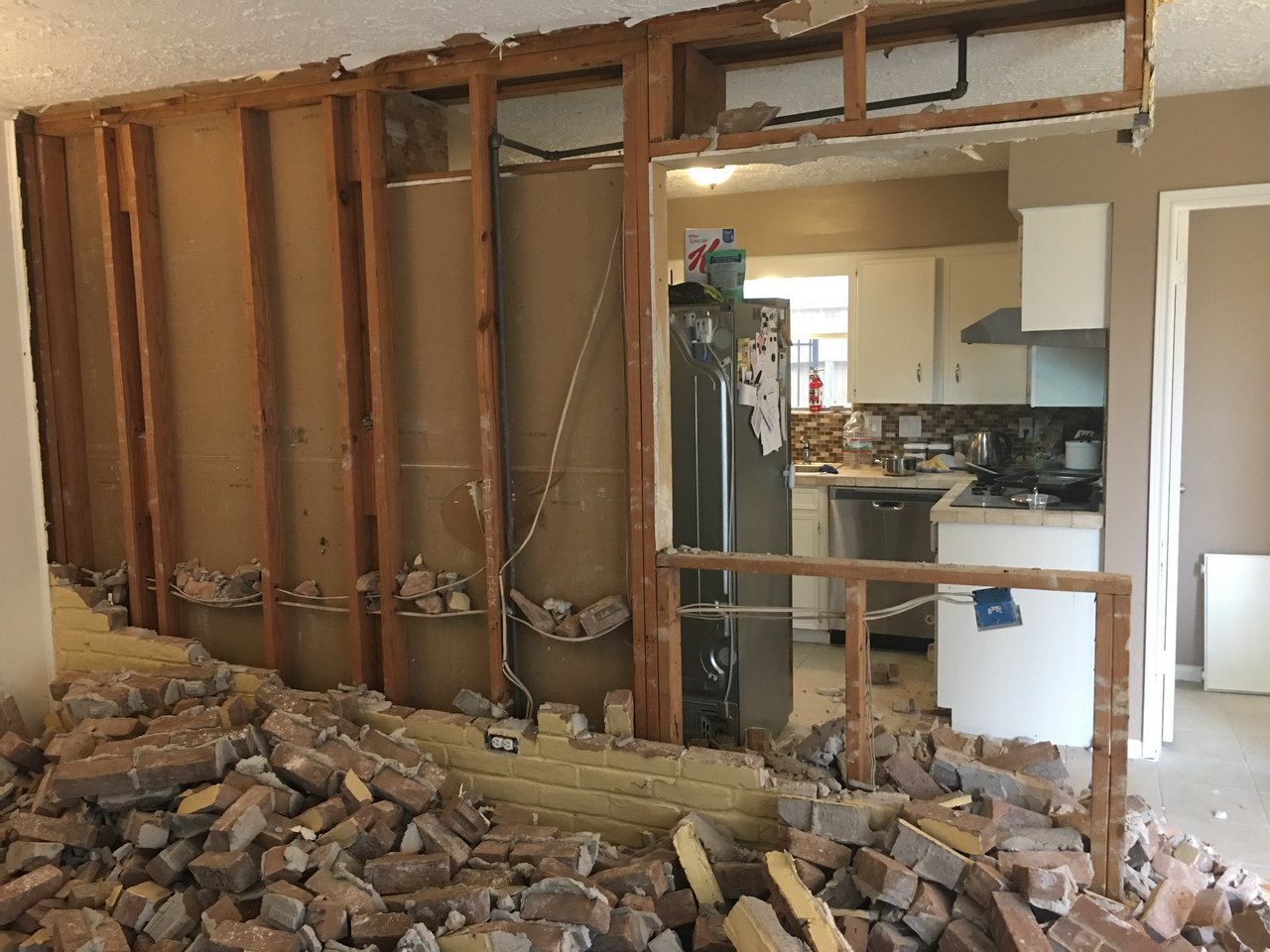

    Demolition phase 1 is complete after I had a water pipe break and leak down my most hated wall in the house.
    Demolition phase 2 - remove the door between the kitchen and dining room and make a nice sized opening.
    Demolition phase 3 - tear down the wall where my range is located and then rearrange my utility room/half bath to get more kitchen space.
    Demolition phase 4 - remove all existing cabinets and countertops.
    This is going to be a very long process as I am currently working out of town for at least the next year, if not longer. But I will tackle it one weekend at a time.
    The new kitchen layout will include a kitchen island, more counter space, gas range, and recessed lighting.

    Whats the story with the interior brick wall ?

    The other week I had a galvanizing water line above the wall/cabinets develop a pretty good leak while I was out of town. The water ran down between the stud wall and bricks. I didn’t like the wall and now had a reason to start my reno way ahead of schedule.

    No I mean why is there an interior brick wall

    I guess that was the style of the home builders in my area back in the mid 70’s.
    Almost every house in the neighborhood has something similar.
    I have one more brick wall in my breakfast room. That will be coming down as well.

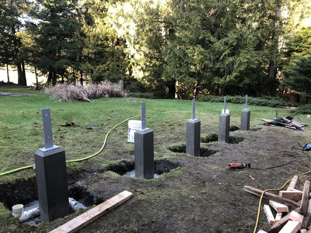

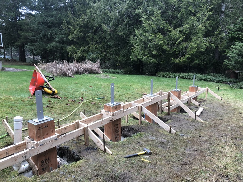

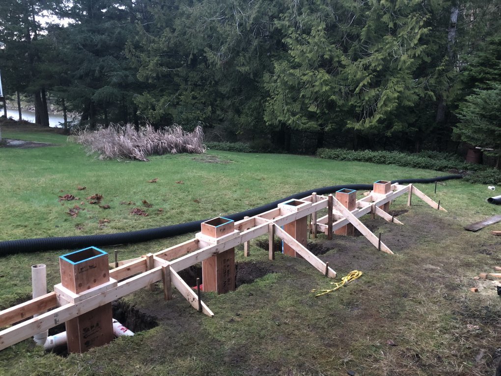

    Actual home improvement
    Building a privacy screen / vine arbour
    6x8 columns formed up
    I had these knife plates made up for me by my fabricator
    Columns poured and knife plates set
    Stripped columns today
    rob1208, TACOVRD, wilcam47 and 2 others like this.

    I put a 1"x1" cant strip around the top of the columns prior to pouring
    There is a perforated drain tile that runs along that sideline I installed about 20 years ago to pick up a groundwater drain further up the property , of course that was also exactly where I needed to dig the footings for my columns which made a sump pump part of the forming equation . Because there is a cypress hedge close to that drain , I decided while I had the pipe exposed to add a clean out / inspection upright so I could maintain the drain in the future .
