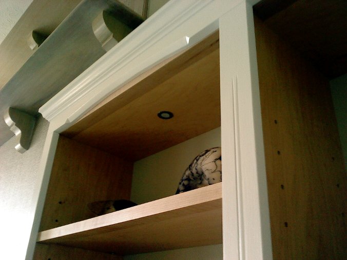

    i still struggle w/ painting, ...have to build up the skill... use a synthetic bristle brush for the water-based latex paints, ..i typically use the better quality brushes by "purdy" or "wooster" (available at home centers, hw/ stores, etc..)... brush matters, paint matters, and so does the sheen level... here's some pics of recent trim project, i used:
    - benjamin moore regal select, sheen: pearl (equiv. to "satin")
    - purdy brush
    - water (spray) bottle
    ...what i don't like about the newer water-based formulations (lower "VOC" = more PITA) is they dry way to quickly, ...hard to keep a wet edge you can go back and even out, drips, etc... what i did was spritz the paint in my paint cup w/ water from time to time to keep it thinner... you can't totally eliminate brush strokes, ...but you can keep it to a minimum, and a good paint/sheen will hide them view after you get a couple feet away...
    ImpulseRed008, TK-422 and PHLinPHX like this.

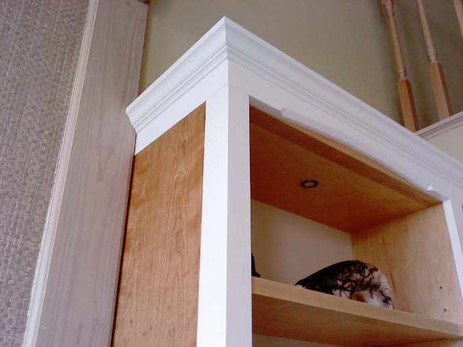

    your built-in looks excellent! great match, ..nice place!
