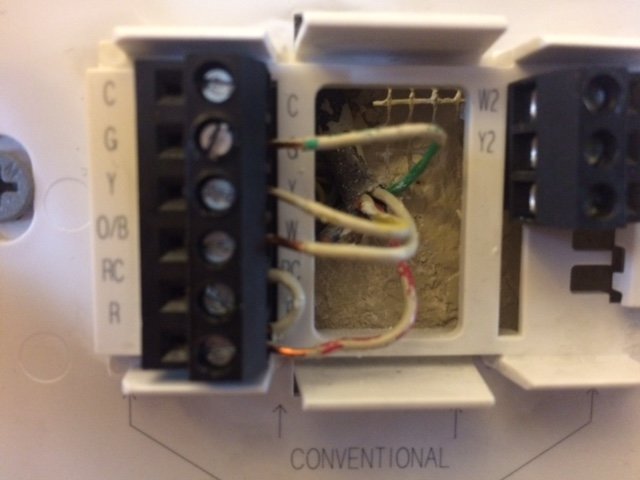

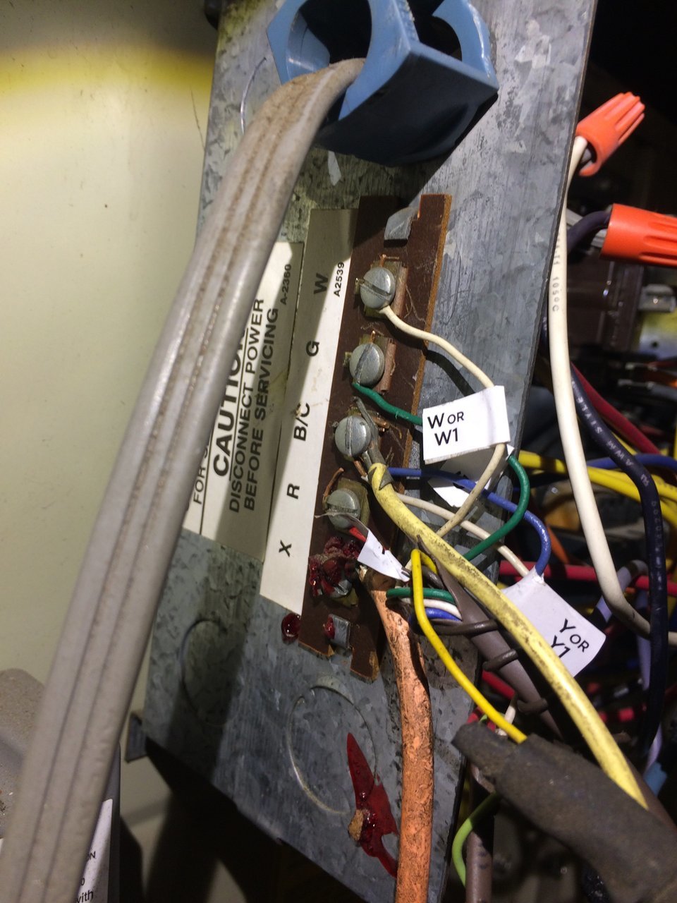

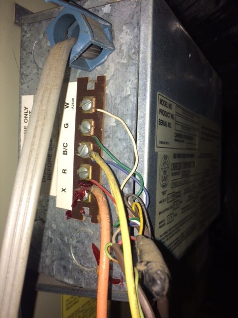

    Tackling the tstat again.

    Anndddd nothing.

    Is it spliced together somewhere? Maybe the blue wasn't spliced?

    im Thinking blue was damage somewhere so I have a brown wire I’m going to replace and try.
    Fingers crossed.

    Was blue in use on old t-stat? My thought is maybe a break/short in the wire somewhere that wasn’t noticed before if it wasn’t used.

    Wires loose in the wall, just use existing as a snake to pull new line through.
    What I ended up doing.

    Thanks all. Phew.

    There may be a way to get a power supply and run it down the fan control wire, but this would take your ability of manually kicking in the fan away. I went down this same path with a Honeywell smart thermostat but gave up.
    And I just noticed that I am a little late to the party, glad to see you got it working!
    dlawrence529 and DoorDing like this.

    I had the same problem. I ended up going with a Nest thermostat. They seem to be one of the few smart thermostats that don't require a c-wire (if you're still interested in getting a smart thermostat)

    I ended up canning the whole "I have a c-wire" and used the provided PEK provided by Ecobee (for people who don't have a C-wire). Which gave me a chance on cleaning up the existing wiring and it's working fine.

    I was fortunate to have the c wire, and a newer furnace. Overall I am pleased with the Ecobee. We actually use alexa and the crappy speaker frequently. Just some background music. Glad you got it working, and I hope you are as happy as I am with it.
