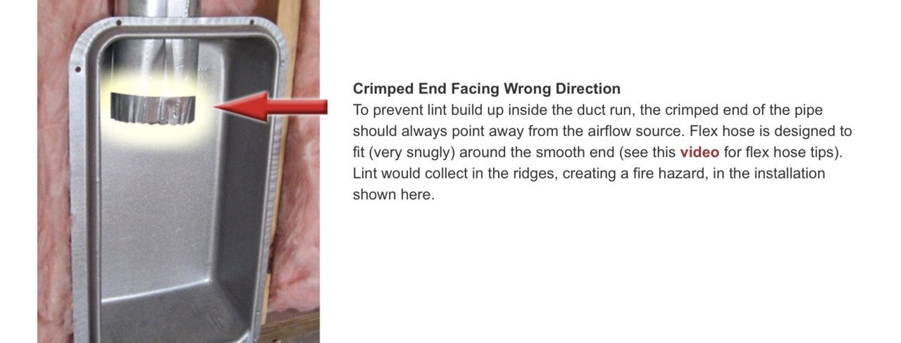

    We just closed on a newly constructed house and moved in this weekend. Washer and dryer just got here. I’m trying to do all the hookups and then I see a major malfunction... the dryer exhaust pipe that comes from the wall... it’s installed backwards! (Stock photo to show what I have going on).
    Can anyone give me any guidance on an easy fix? If I call the builder right now, I may need bail money shortly after that, I’m ready to come unglued on his ass.

    Other than taking the whole thing off and putting it on right, maybe cut the crimped end off?

    It’s installed... and behind drywall...
    I don’t know dryer vent pipe at all. Is it possible the entire run is backwards?

    how far is the run to get out of the house? if it's just up and out behind a sheet or two of drywall I'd be pretty tempted to pull it and flip it.. I'm pretty shy about cutting corners with anything that could lead to a fire hazard.. peace of mind has a pretty high price tag, and depending how much you have to cut into to access it, I'd be pretty tempted to just go at it without the builder.. having said that, if they don't get called on shoddy work theres nothing stopping them from building 1000 houses with potential fire hazards built into them.. .02

    I'd bet the whole thing is backwards. Make the builder fix it. Does it run straight up through the roof? Might be able to flip it without ruining the wall, but I'd demand they fix it. Don't let them just cut the bottom crimps off, as the main problem would be lint clogging at the joints in the wall that are also upside down...

    Just re-read your post
    Got a pic of your actual installation ?
