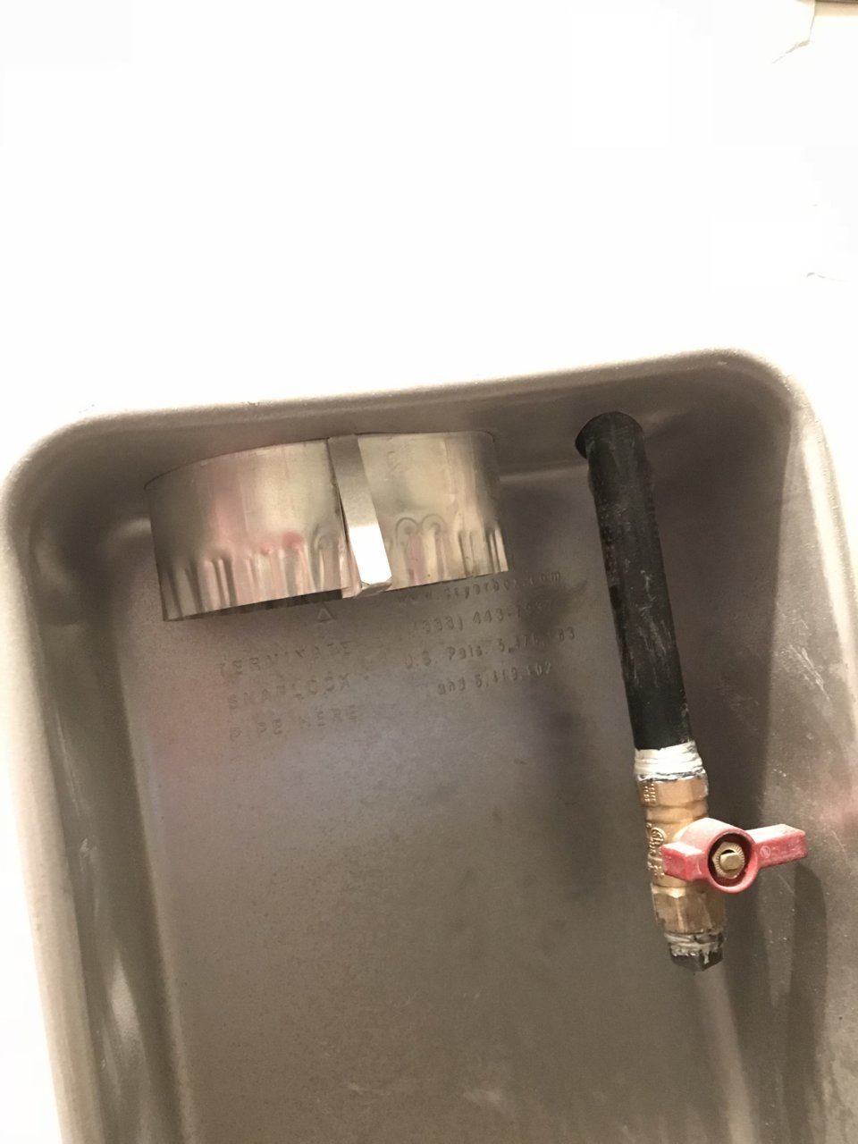

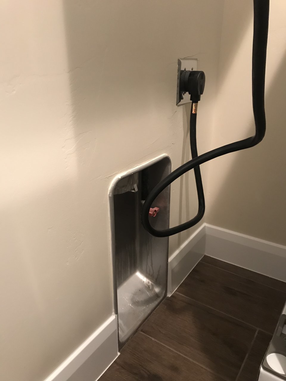

    That looks like a site made crimp , which means other end of pipe can still be in correct orientation , are you able to shine a light up into the pipe and see how the next connection is oriented ?

    It's OK. Look up dryerbox info here:
    https://dryerbox.com/installation/dryer_vent_installation.htm
    Yes, it is not ideal for airflow in theory, but it will be fine with an external hose clamp. You're supposed to take the vent hose off and inspect/clean annually anyway. You can also have a service clean it from the outside in with a flexible rotating brush. I just went through all this, very long story, found a break in an L in a very remote, hard to detect area simply because I get anal abtouthings like retards causing my house to go up in flames, or having laundry machines stick out into passageways and doorways. I won't even go into the guys putting a foot through the ceiling into the guestroom, or installing the box too high and having to come back and lower it all, or waiting forever to have the drywall guy come and close it all up again. He was the best on the job. But we should not have needed him at all. Yay.

    I have an OCD about doing things the right way, especially when it can cause a potential problem. It’s not right. It’s taking a shortcut.

    Can you see orientation of second connection ?

    Rent an inspection camera
    or nuke it from orbit . Its the only way to be sure .

    I'm with @OZ-T this. My first thought when I saw the photos was it looked like a sloppy field crimp.
    If you take your camera and a flashlight you can shine it up there and take a picture. If it's a straight pipe (which I'm assuming it is) you should be able to get a pretty good picture of the next joint even if it is up 4-8'.
