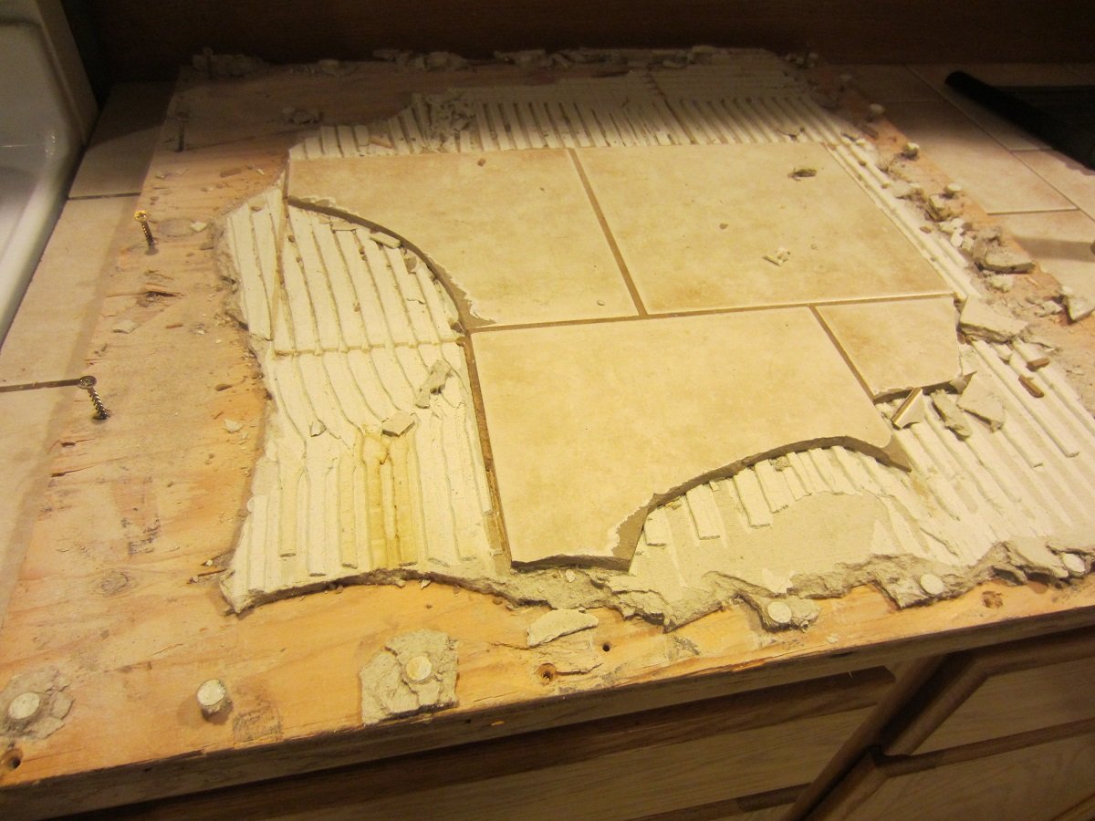

    Rent it. Those scrapers are hell on recip saws as they are not built for that impact.

    normally Id agree. But not since Im trying to NOT buy more stuff since we are more than likely going ot be selling in the next two years.
    Cheap harbor freight one I got for free so not to worried on that. No way I'd do that with my nice Dewalt one

    Take a Sawzall to the screws from underneath.

    Im not picturing how you would safely do that when the plywood is screwed into the cabinets and getting a saw-z-all blade between the two is no easy task...especially without damaging the cabinets.

    I think any damage would be minimal if you steer the blade up into the countertop and would be hidden by the new top.

    I get that part...its more how to get a blade between the screwed down plywood and the cabinet. Let alone getting at the screws in the rear or in the middle.
    But either way think I have the "best" method figured out for tools on hand. The mason chisel works ok but will still take a bit. But the air hammer
    works quite well....which makes sense since its (more or less) the same principle as a hammer drill.
