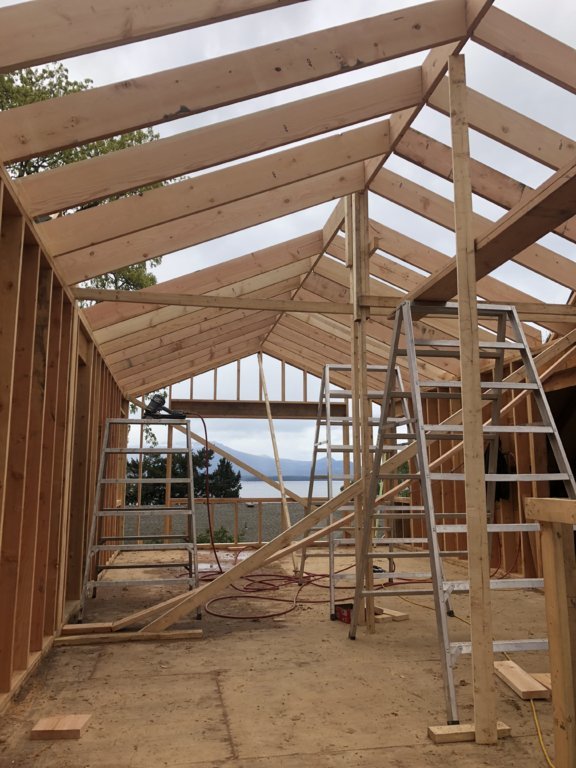

    Framed main centre core roof today , will add ceiling joists tomorrow and start strapping and sheeting it

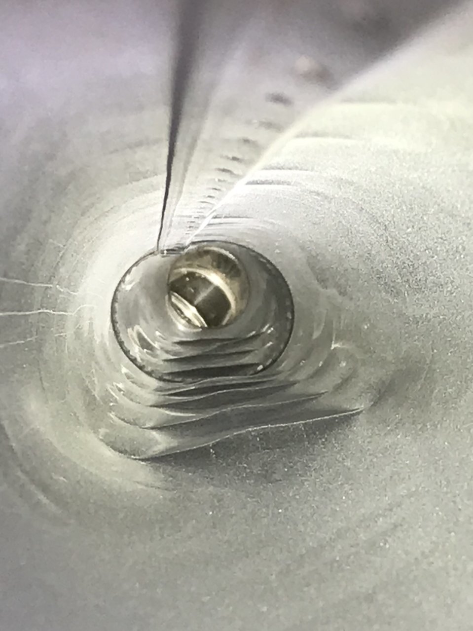

    Dryer vent update:
    (and this is why I fucking hate incompetent people)
    Dryer vent installer says he did the crimp on site. Says its to make it easier to fit the hose over... Also admitted to putting the 4" rigid pipe into the 2x4 wall cavity. "the pipe becomes oval" he says... I tell him its buckled... he argues. I send him photo. He temporarily shuts up. He tells builder that he'll have to rip out the entire wall. Neither have come up with an answer yet as to who is going to do what and who is going to pay for it. Im certainly not.
    Brought misaligned light/faucet to builders attention. By his reaction, he's never ever even noticed this kind of thing before. I just wonder how many other homes he's done this to...
    Now... Next Question:
    Dryer vent hose. Whats the best thing to use? That old aluminum accordion type flexible stuff? (I dont like it, gets holes too easily). Rigid but flexible (that stuff thats crimped to bend where you want it to). Or some other kind that Im not even aware of? Im asking since the installer goofed and says its for easy install of the flexible hose. I was wanting to install a shallow and rigid type assembly so that the dryer could be pushed closer to the wall. His crimping does not allow for any other type of hose to be attached...

    Use rigid galv duct , not the corrugated stuff
    It is fine if the pipe is oval

    It’s not oval (not anymore, at least) This is looking up the wall, in the direction the lint would travel - and collect into the crevices.

    I wouldn't be concerned about the waves in the pipe in your pic , but I was actually just stating that an oval rigid duct is fine if they need to squash it to fit into a 2x4 wall

    That pic is what’s in the wall. So that’s ok??
