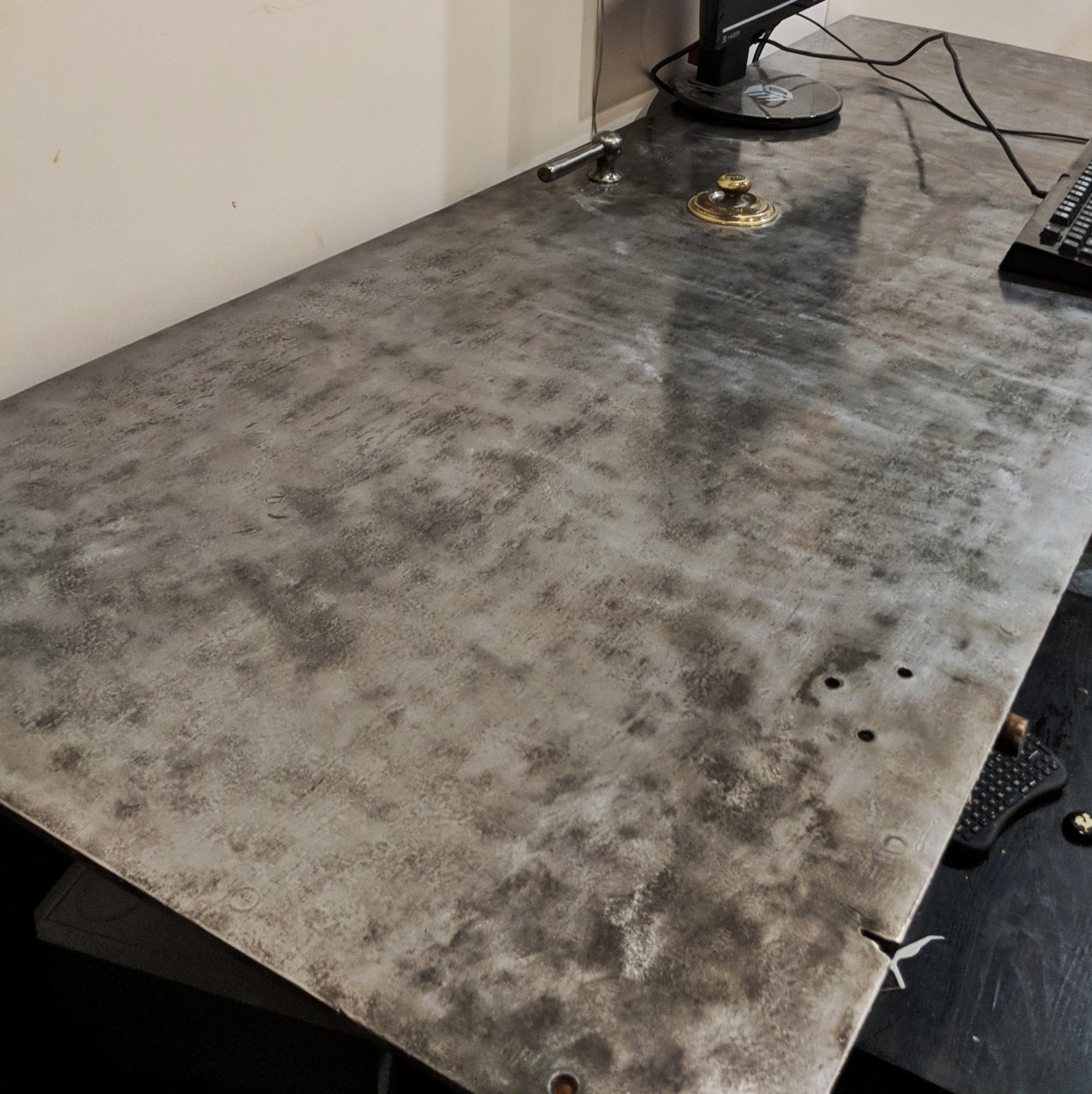

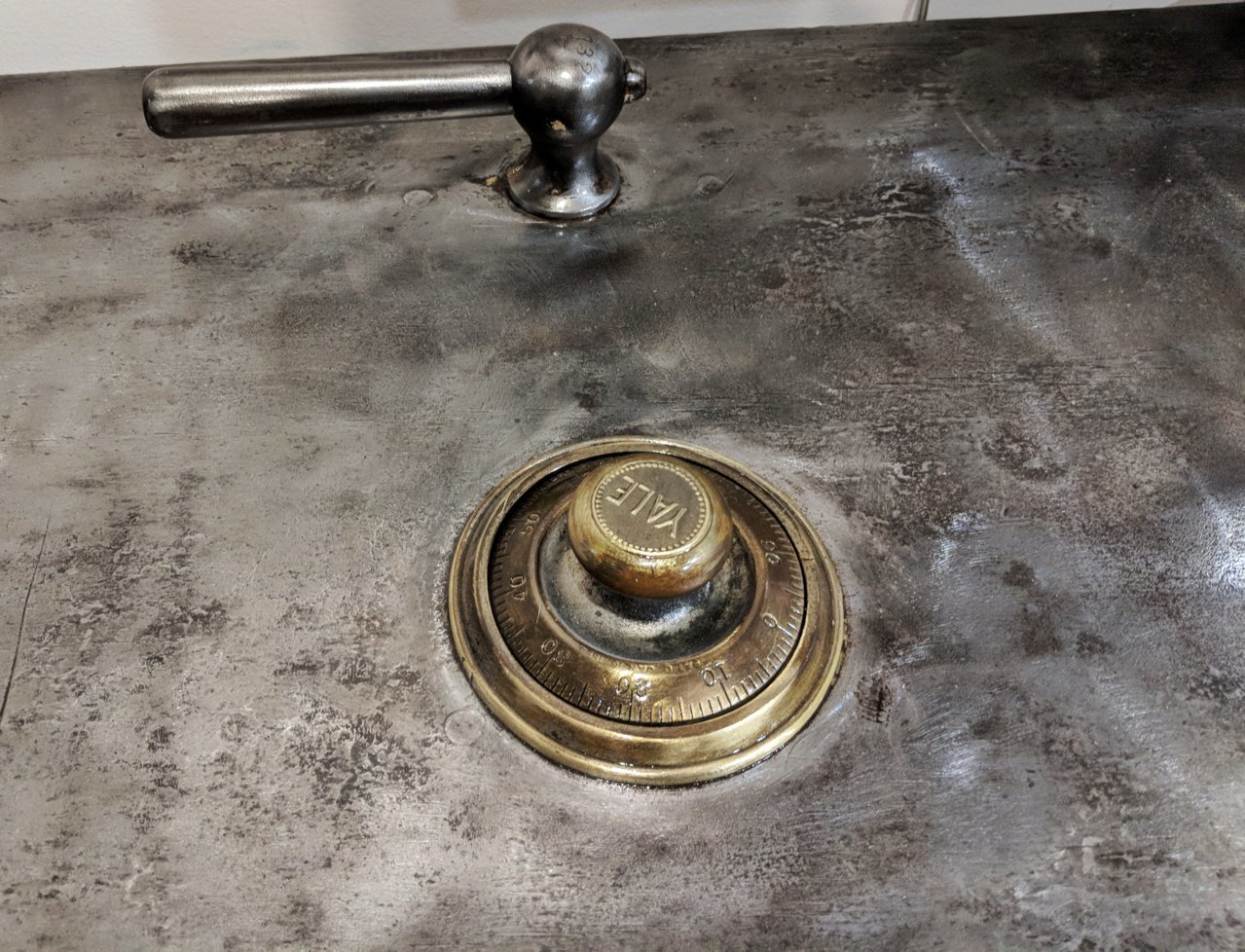

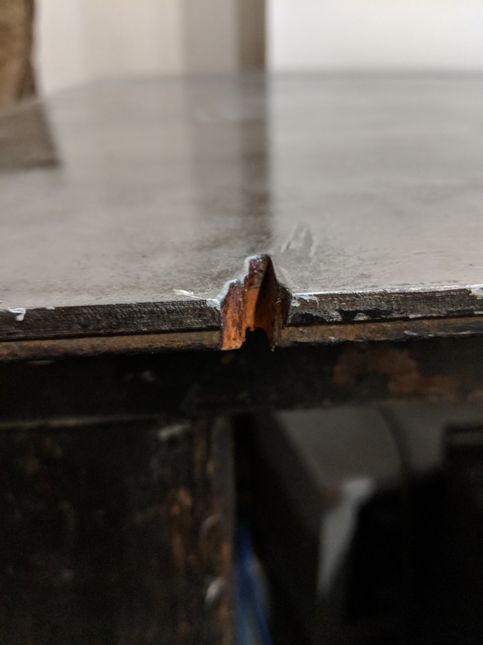

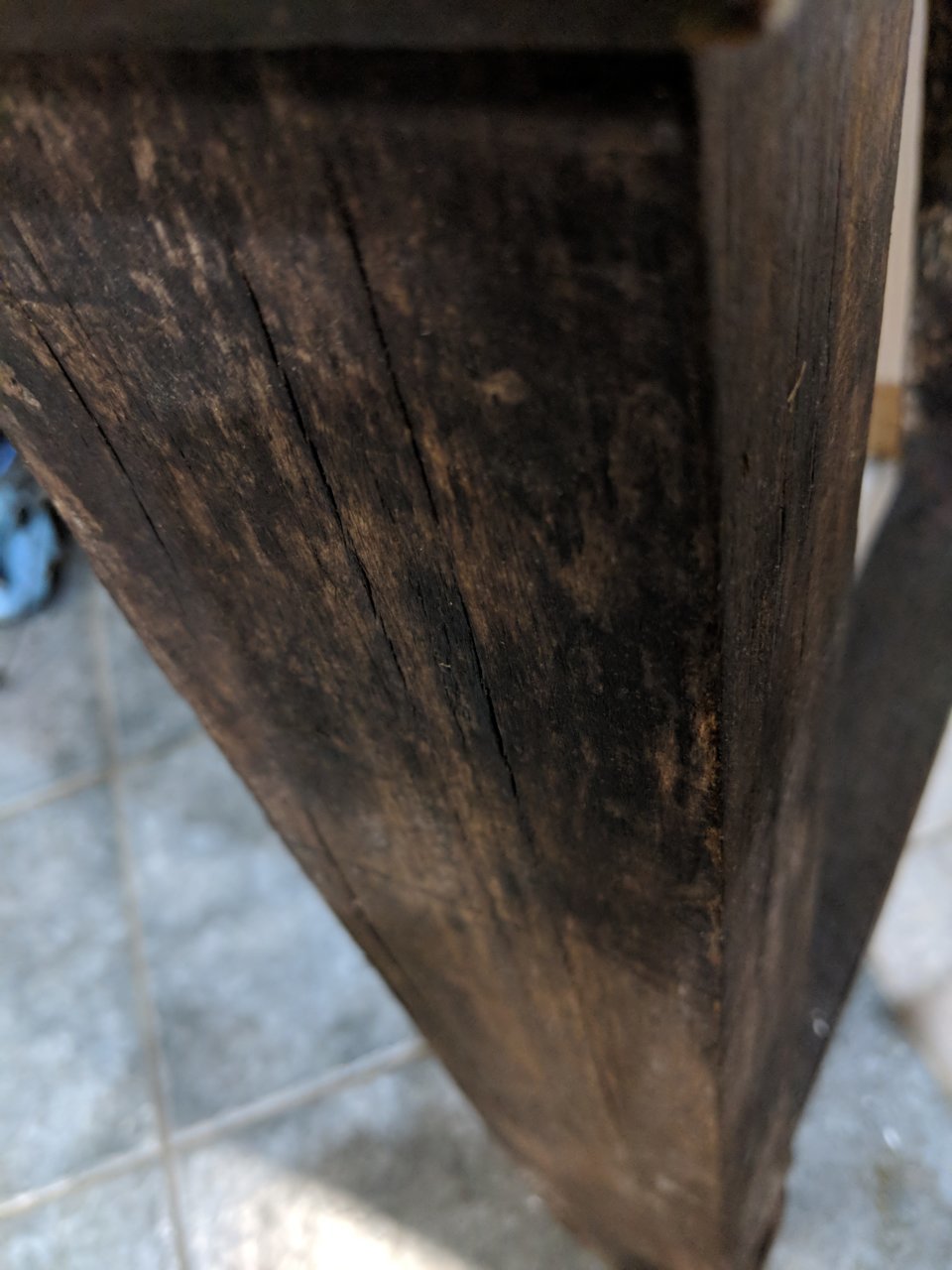

    I might as well show off some of my stuff... Otis safe door with weathered oak legs made into a computer desk.

    Very cool.
    On a smartass note, was it Al Capone's via the douche bag Geraldo Rivera?

    No but very similar situation.... There wasn't fuck all inside.

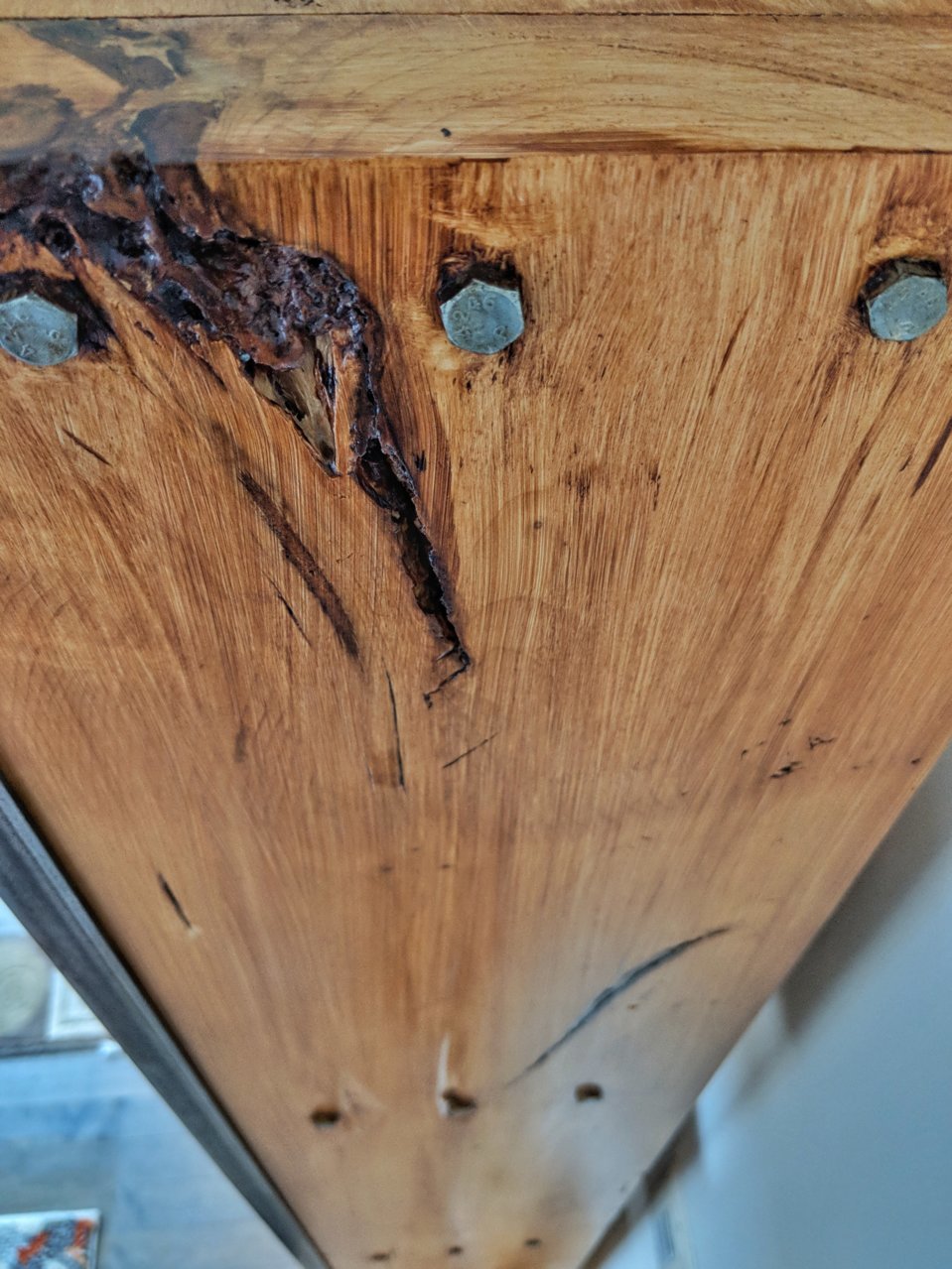

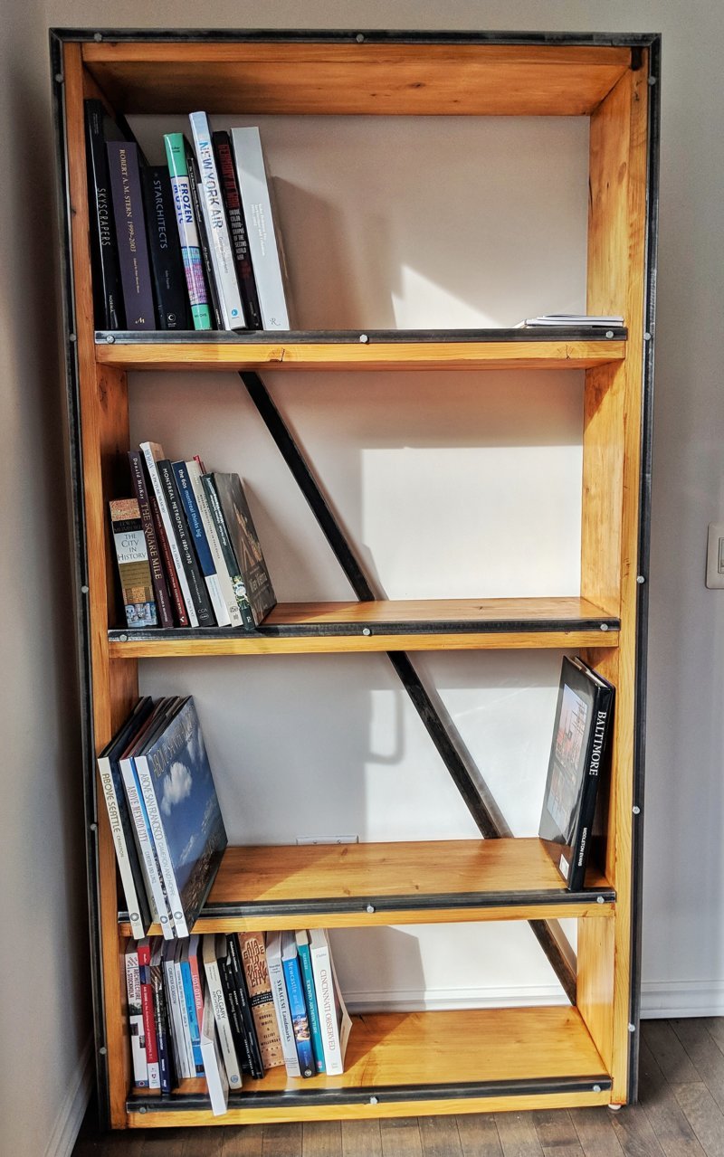

    Scaffold planks (rough cut 2x10 spruce) sanded, sealed, rough brush gel stained and sealed again with 4 coats. 5/8th angle used as border clear coated. Assembled with 6" lag bolts.
