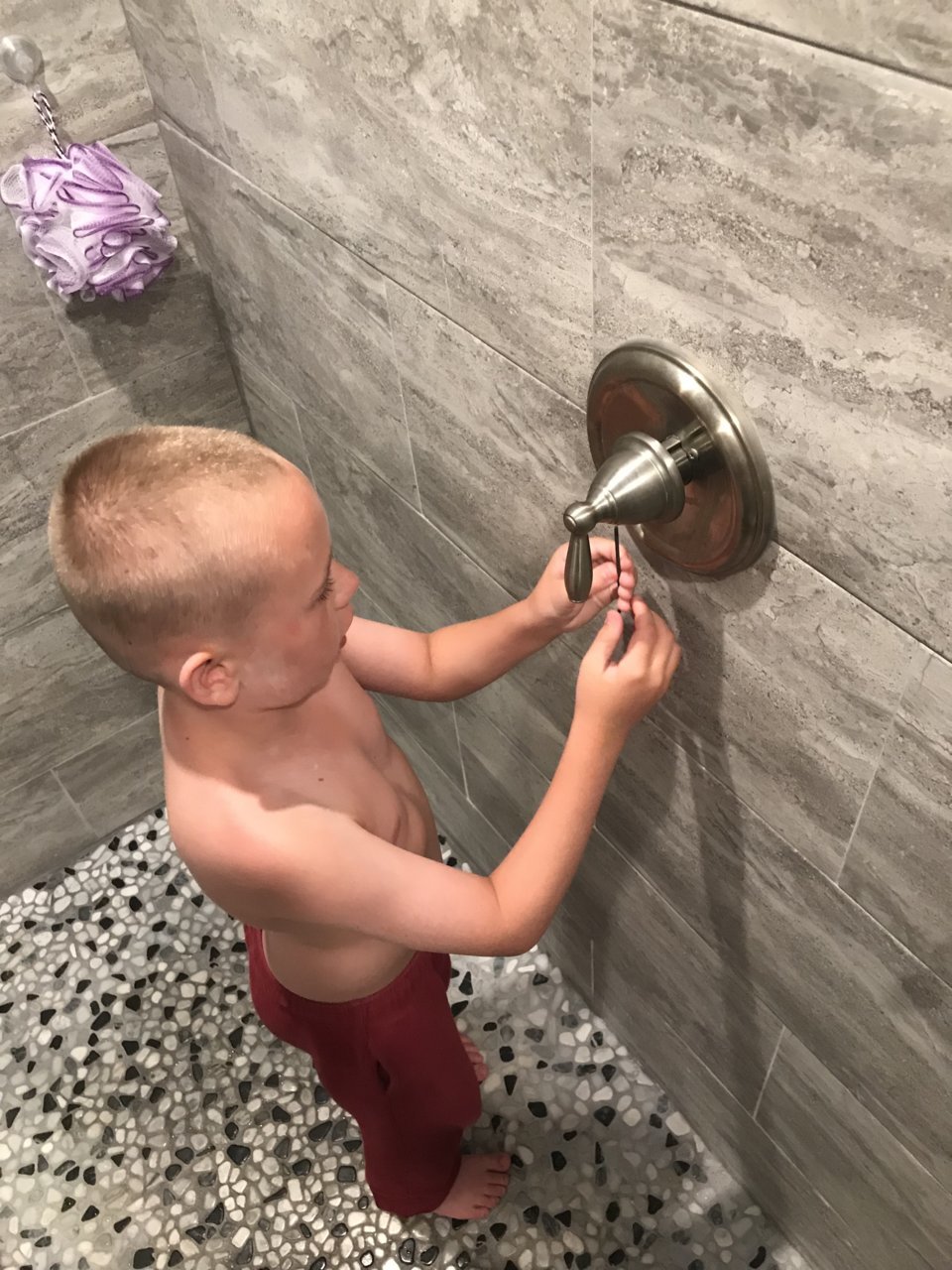

    Not my home but trying to teach my 8yo nephew simple stuff. Sister’s shower handle was loose, had to take off handle and tighten the faucet insert. Figured I’d have him help with the simple task.

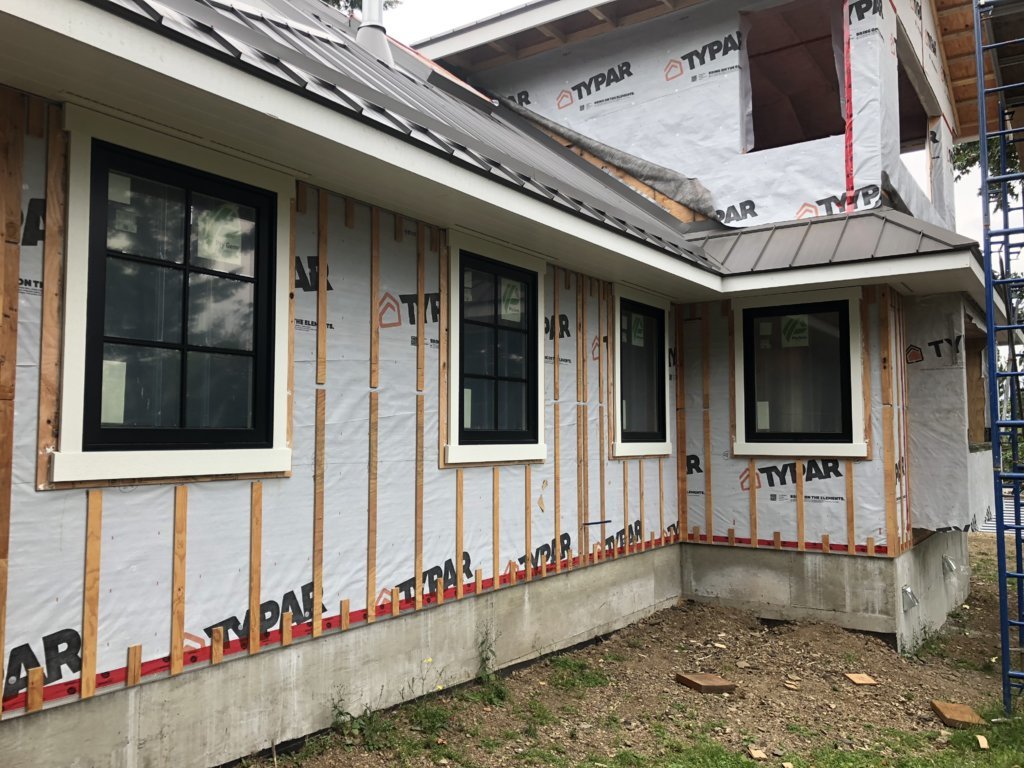

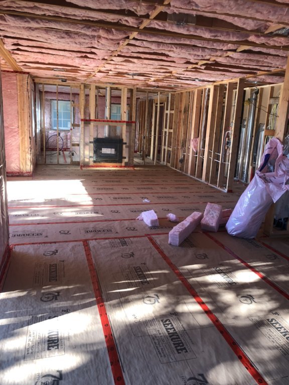

    Last couple days we papered off the floor after the concrete pours and the batt insulation for sound and to reflect the radiant heat up was installed in the ceiling

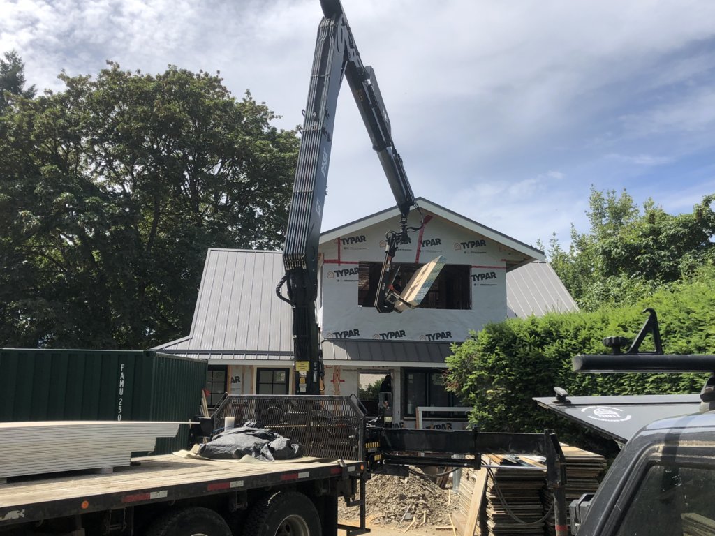

    Drywall was delivered today
    and we installed our preassmbled window trim boxes on all the main floor windows
    Drywallers start boarding tomorrow and we'll be working on siding and exterior finishes

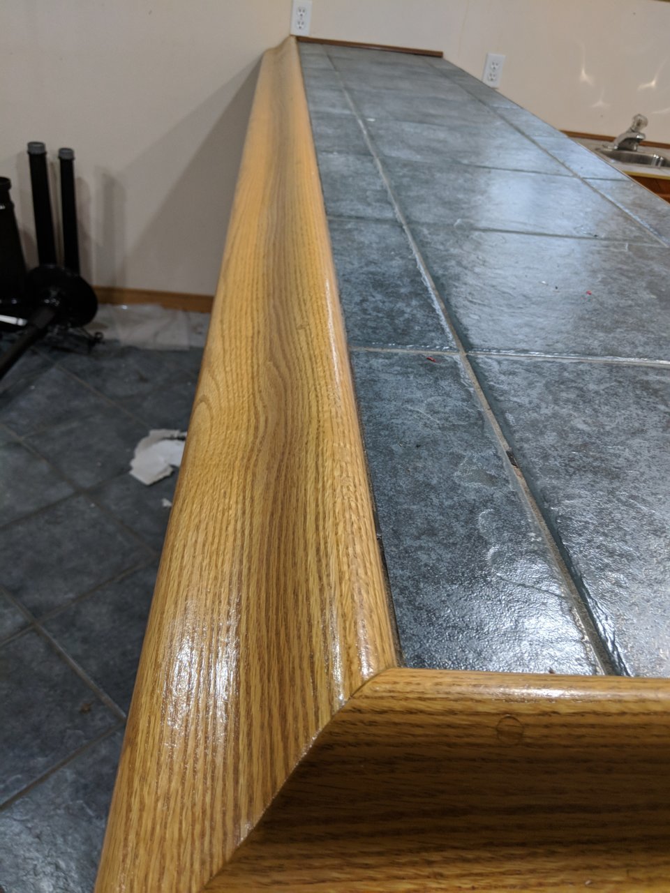

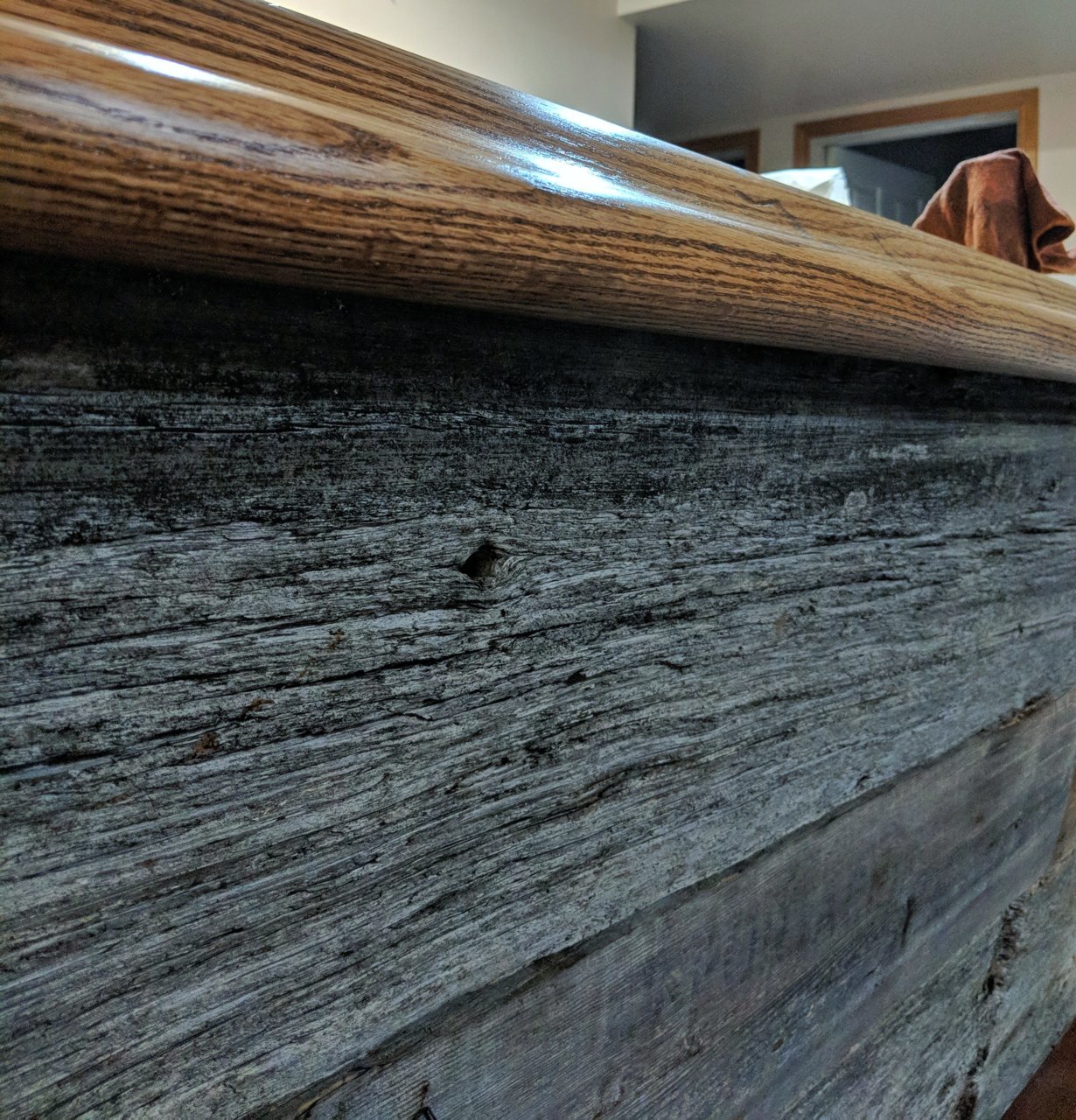

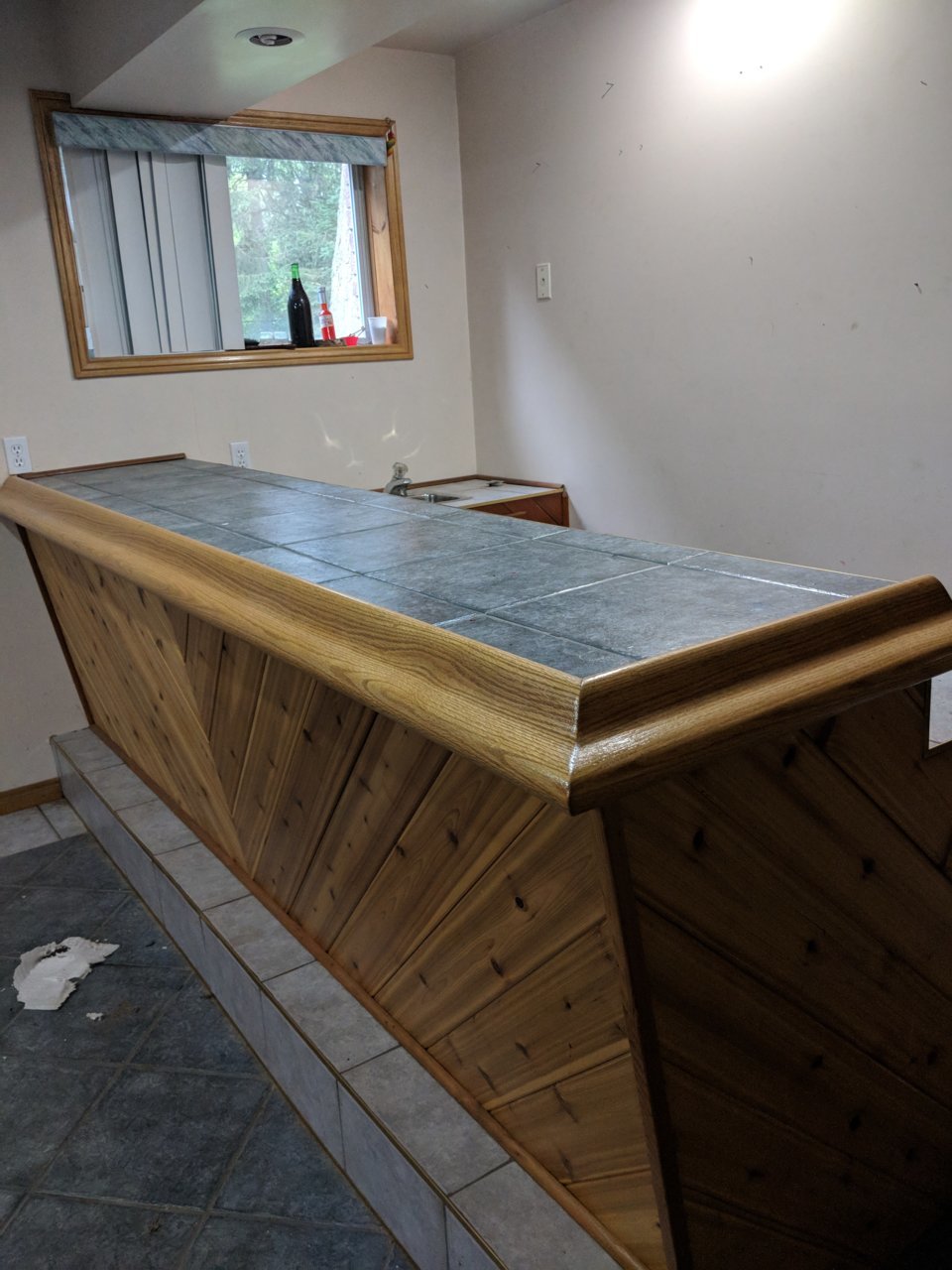

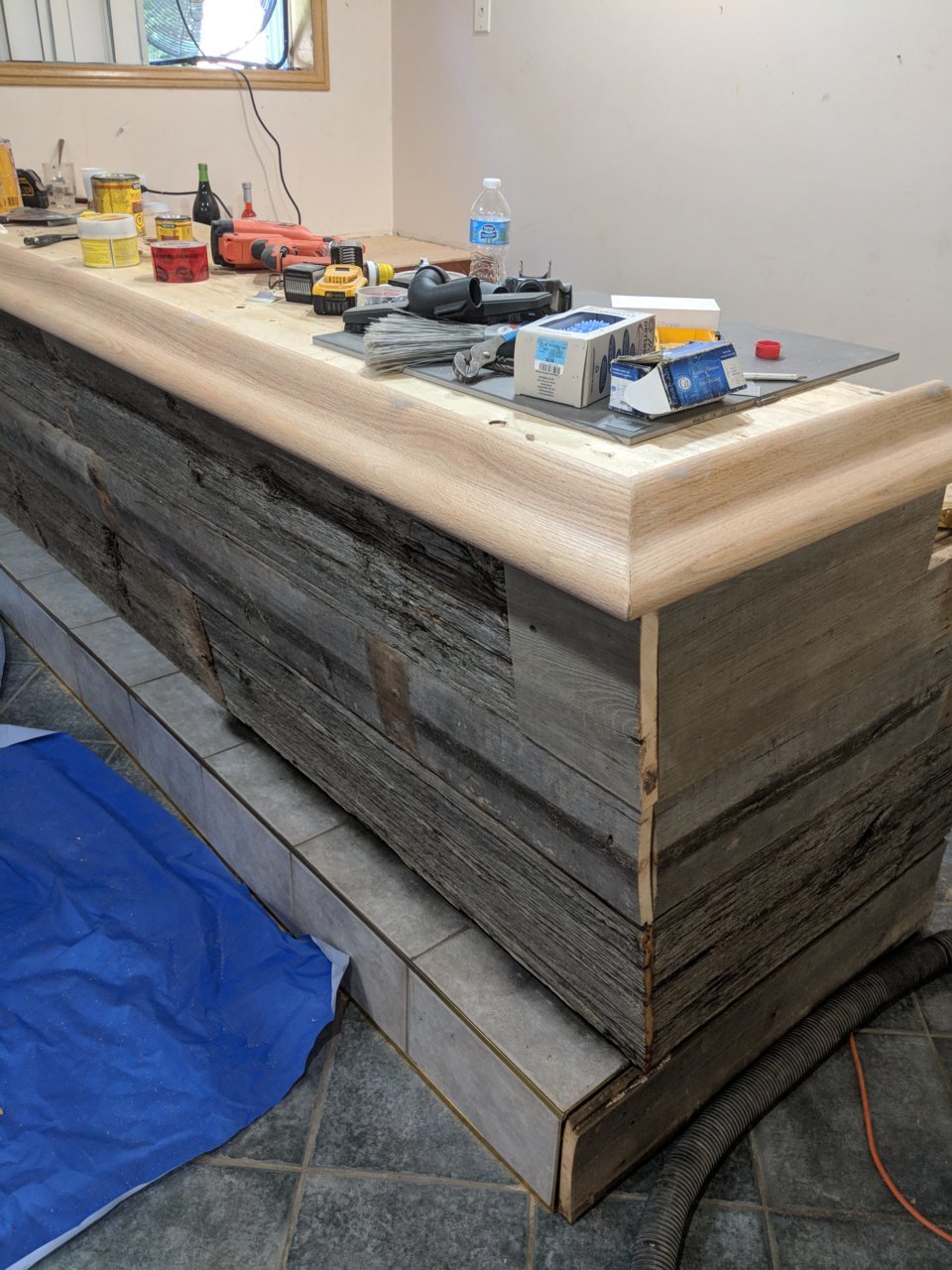

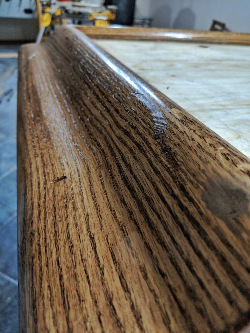

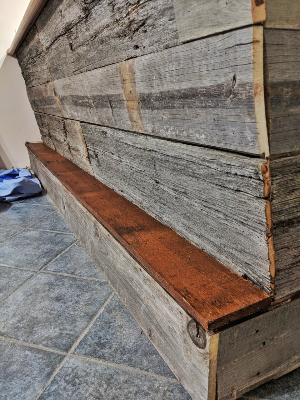

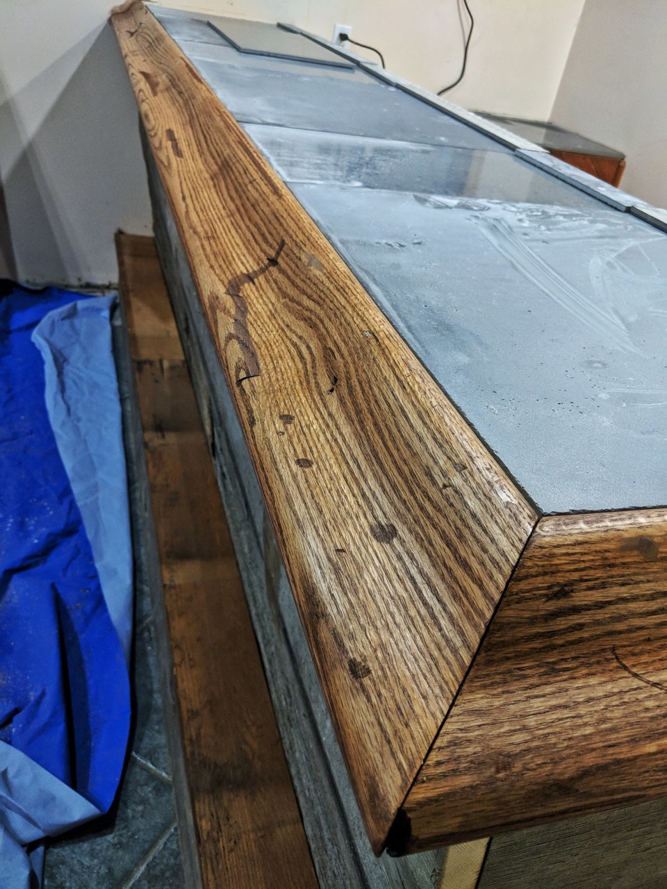

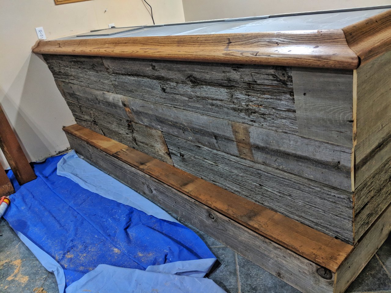

    Started redoing my bar.... IMG_20180620_184546.jpg IMG_20180620_184549.jpg IMG_20180706_211843-01.jpg IMG_20180706_211838-01.jpg IMG_20180706_235057-01.jpg IMG_20180706_235117-01.jpg IMG_20180706_235040-01.jpg I stripped sanded and cleaned the bar rail and it looked wrong.
    Too clean....too new.
    Went at it with a nail puller, pliers and a grinder to give it that rustic/beat to shit look. Tile got cut today but gets layed tomorrow. Barn board front. Alternating mat and gloss tile for the top. Foot rail is 90 year old 3/4" oak from some panelling. I'll be using some 1 1/2" steel angle to cap the corners off. Probably end up with like 12 coats of poly wipe on varathane. Love that shit. So much depth.

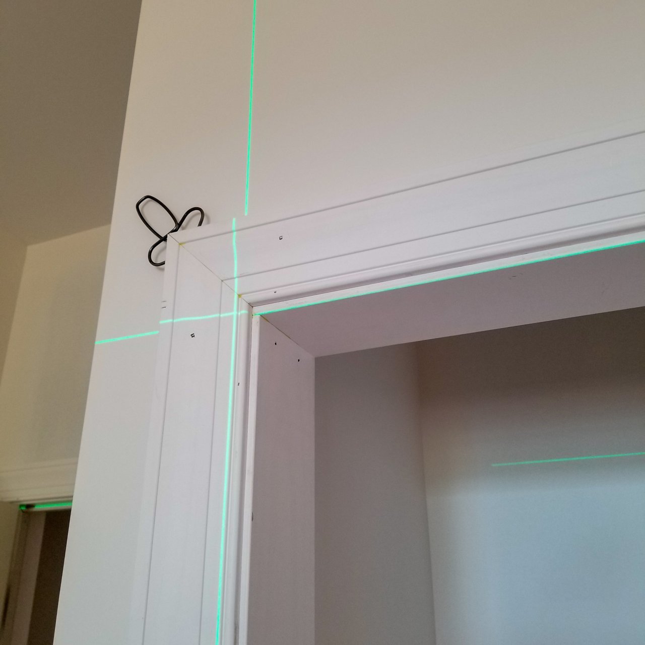

    Trim is boring

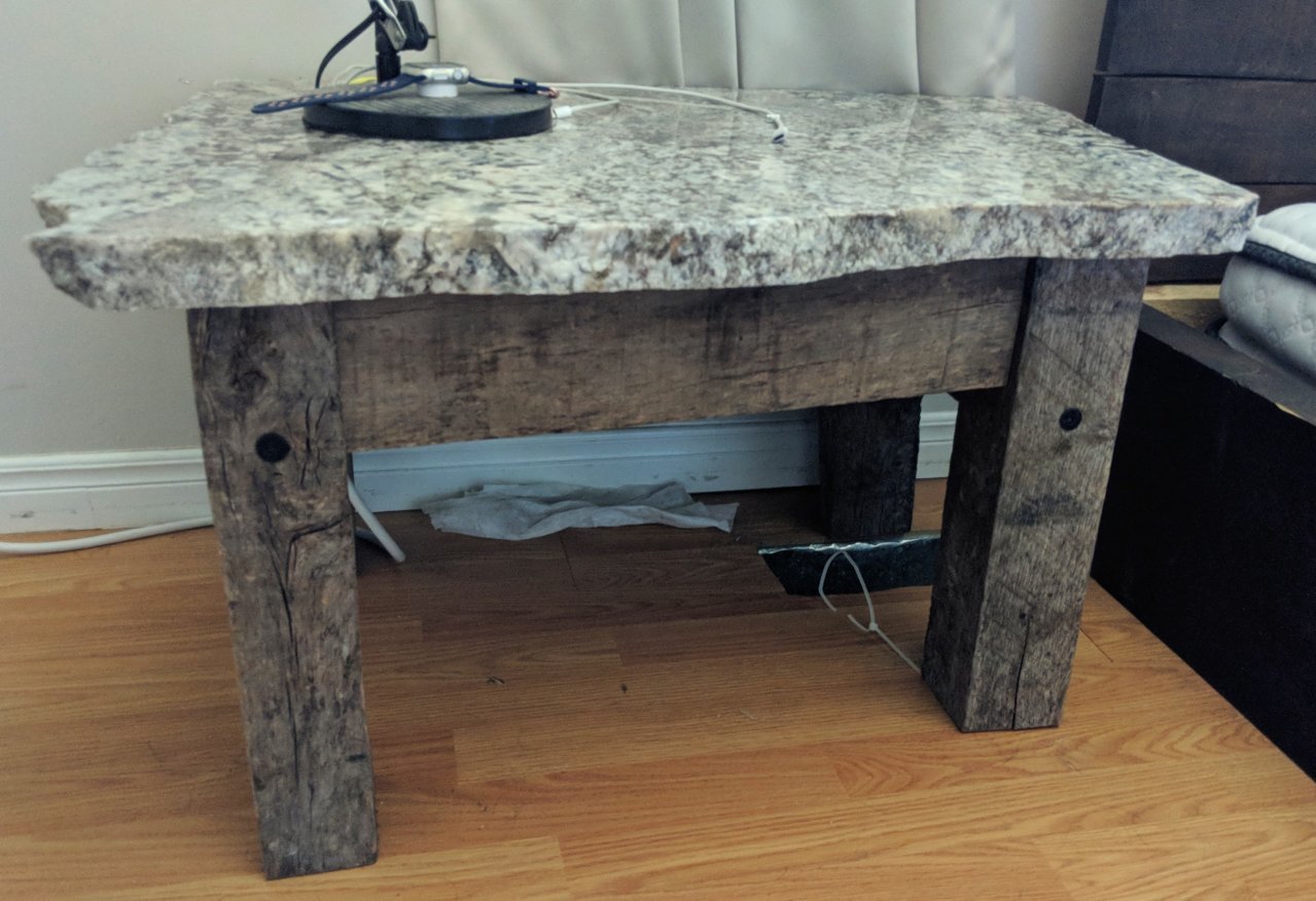

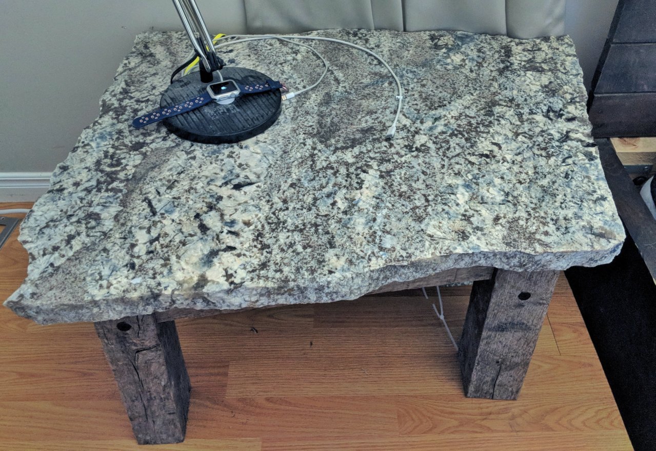

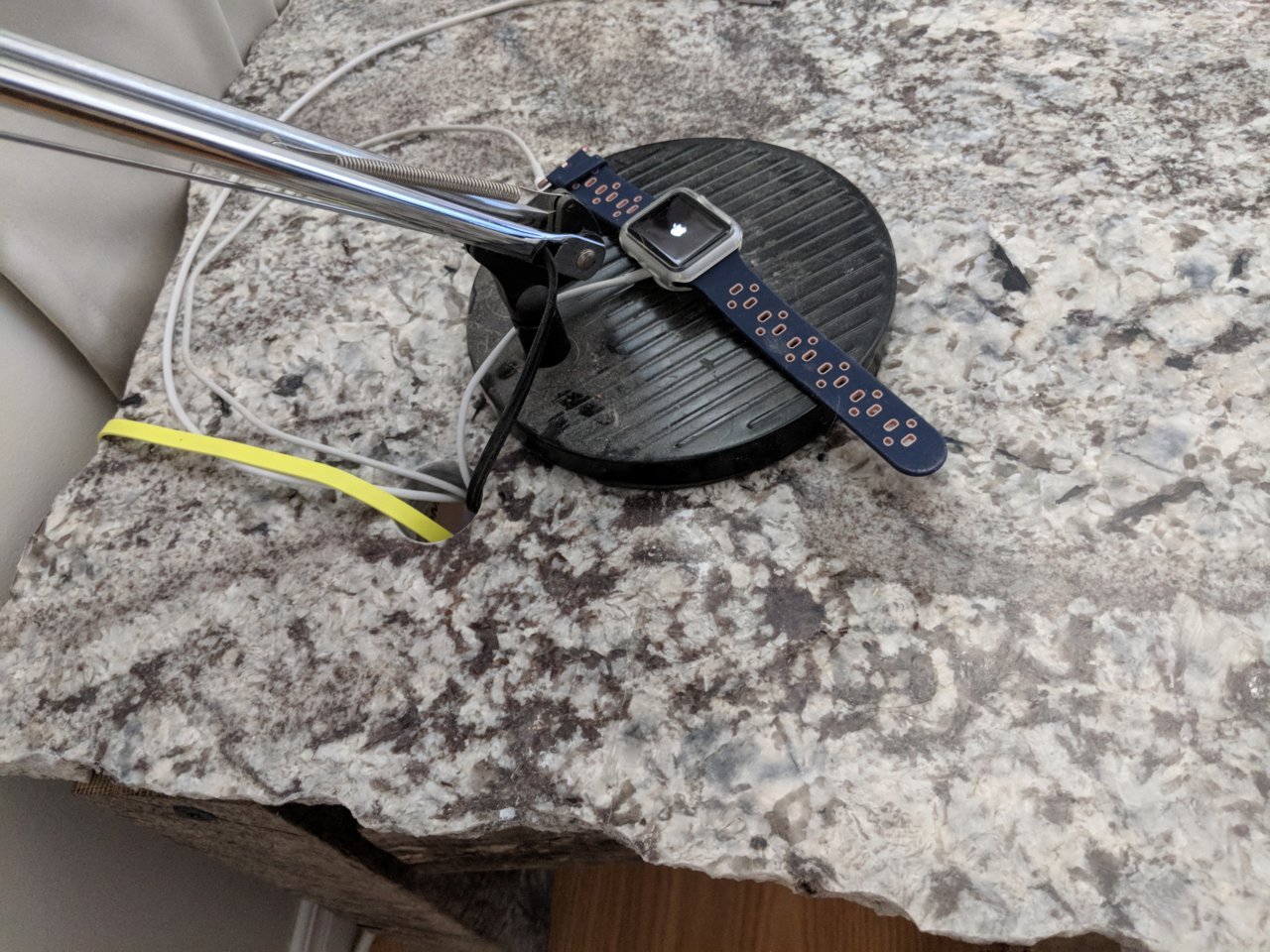

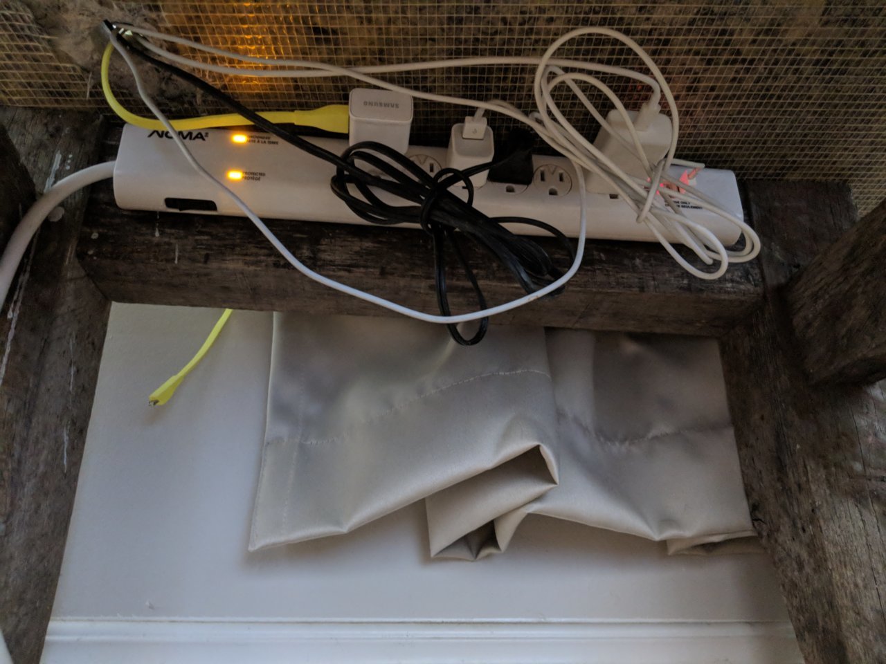

    Flintstones-esk night stand. With hidden powerbar. IMG_20180707_180347-01-01.jpg IMG_20180707_180350-01-01.jpg IMG_20180707_180400.jpg IMG_20180707_180420.jpg
    I drilled out a hole for all the charger cables to come out through.
