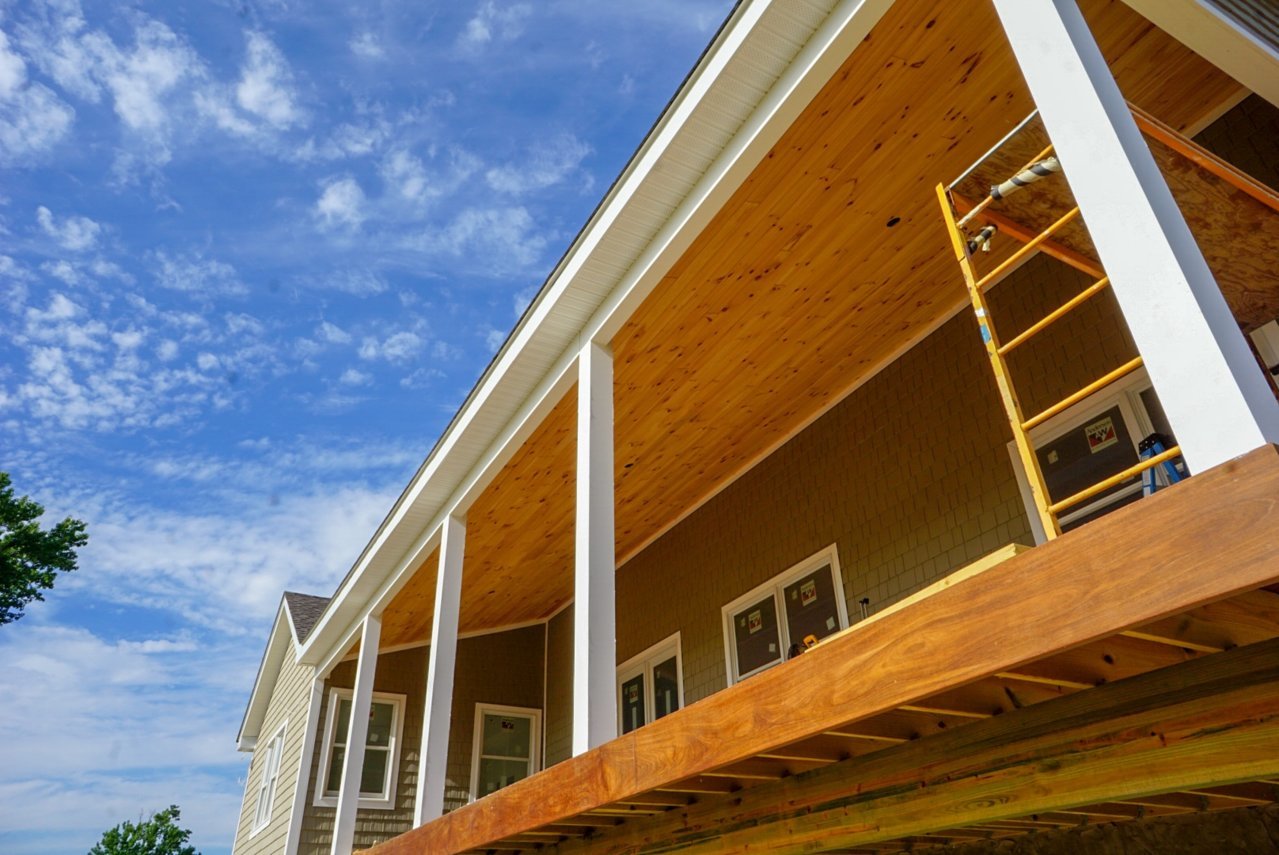

    Not too bad . I like the tool , I hate that I'm installing / working with fibre cement siding

    All the siding on current house build is fibre cement . Board and batten and shingle panels .

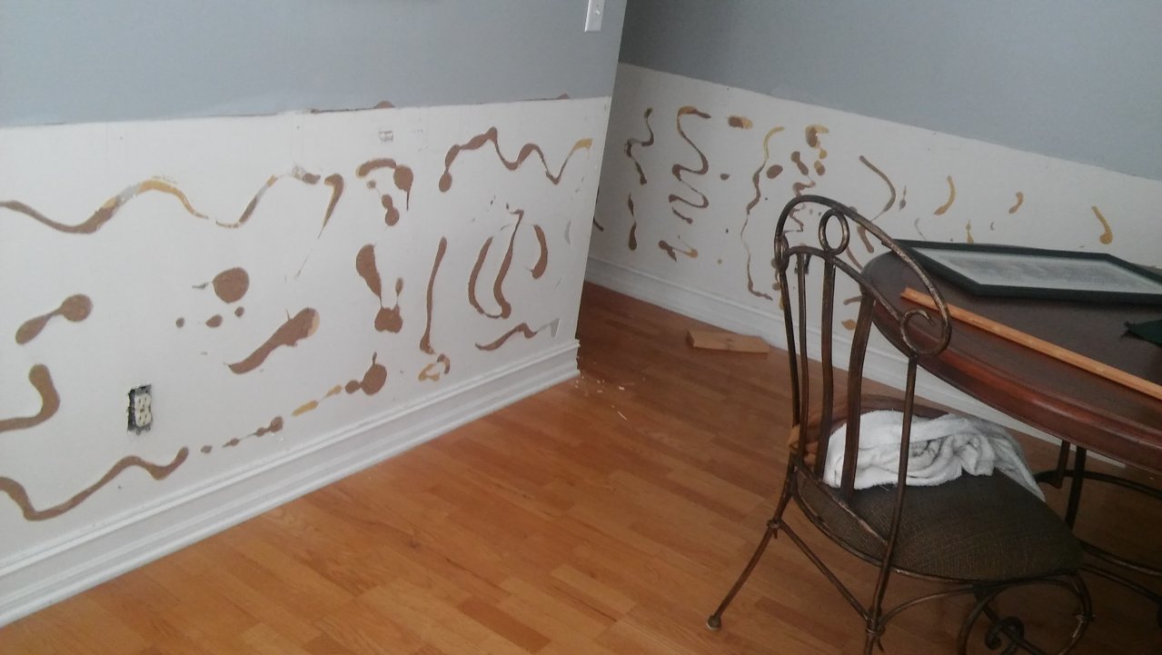

    The wife is not into the paneled/wainscoting look at all....
    I'm making some progress on the repairs this morning.

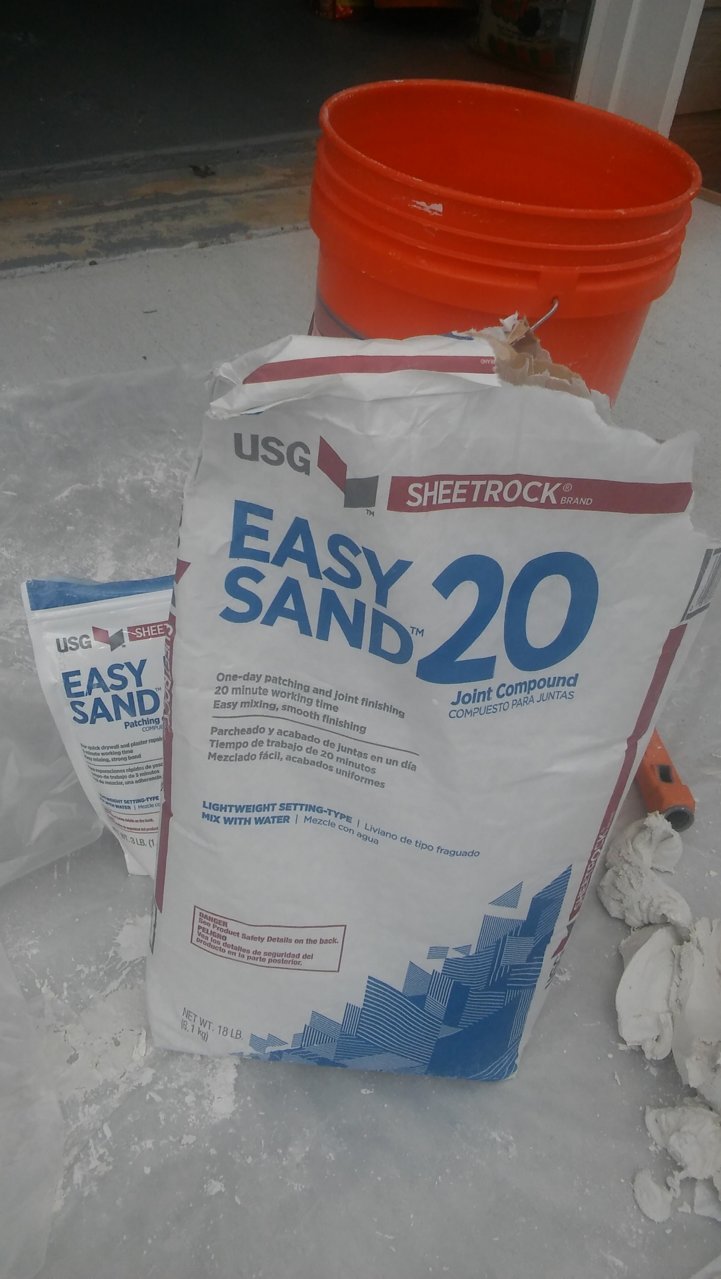

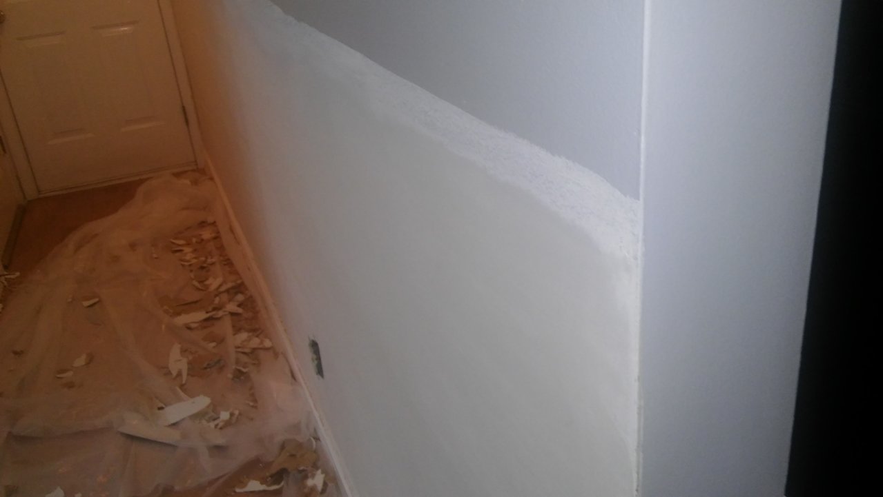

    Wall update. After pulling off all the ripped paper and getting it as smooth as possible I applied the compound using a wide knife. It's a quick drying mix so after a few minutes I was able to knock down the areas that bubbled a little. Then applied a second coat. Hard to tell in the picture but it's very smooth and almost ready for priming and painting. I'll let it sit overnight and then a final sand tomorrow.

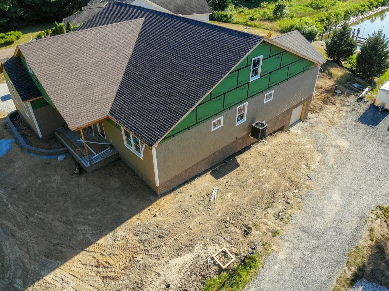

    Waterfront so everything is as little higher.

    Holy chit, I've done a lot already!!
    I live in Buffalo, a little ways from the lake and far from any hurricane inducing surges, and I've noticed that is the trend. New house around the corner has it mounted like that, and I've noticed a few others in the area. Prevents the ground settling and causing issues?? :notsure:

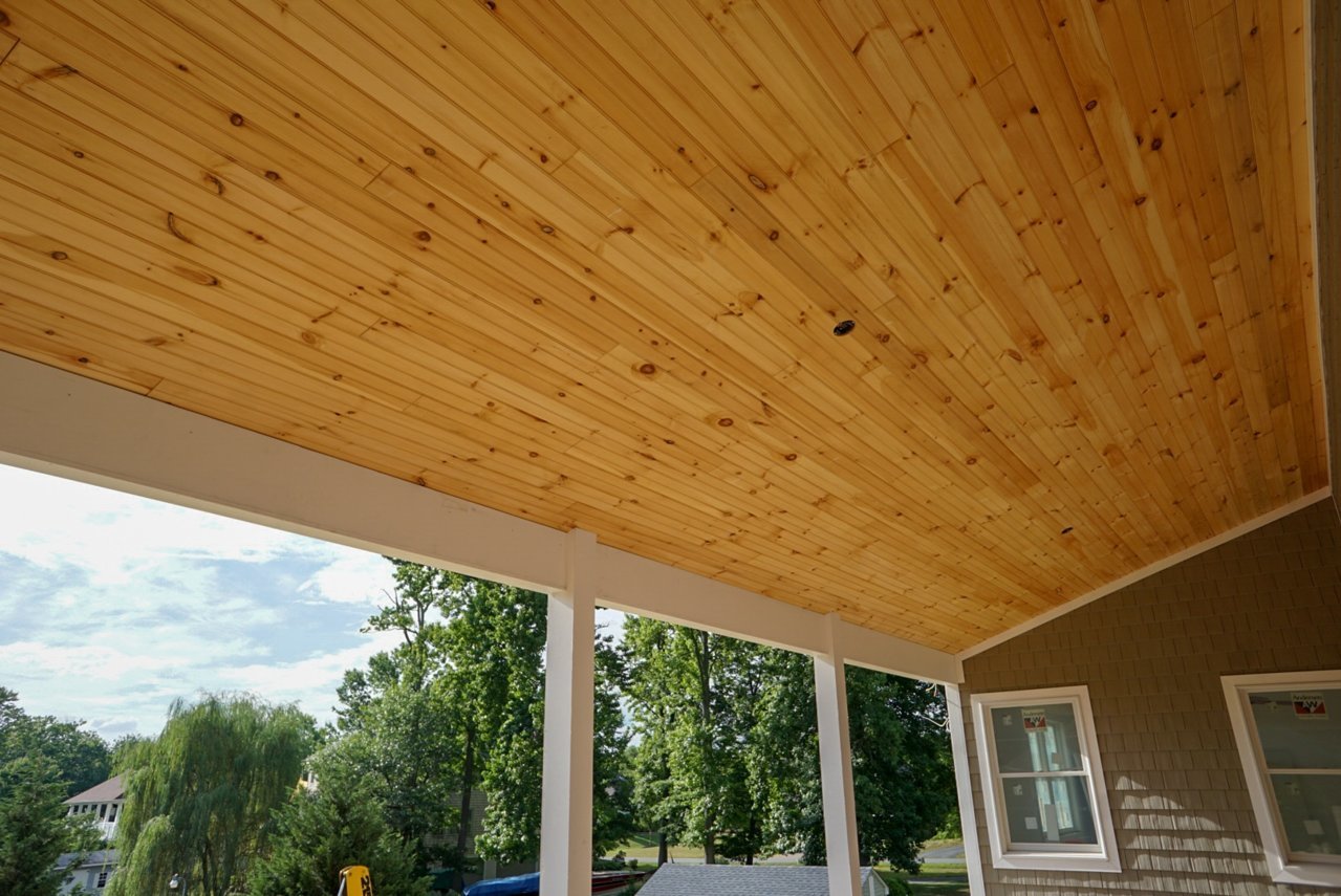

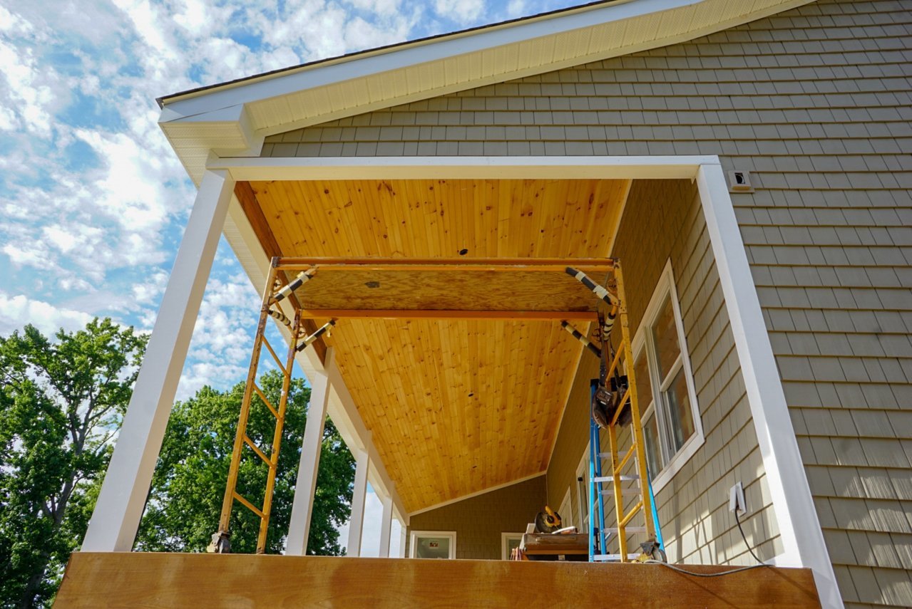

    1x8 double v joint pine ?

    I wonder if they run cooler with more airflow off the ground ?
