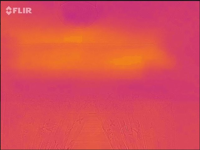

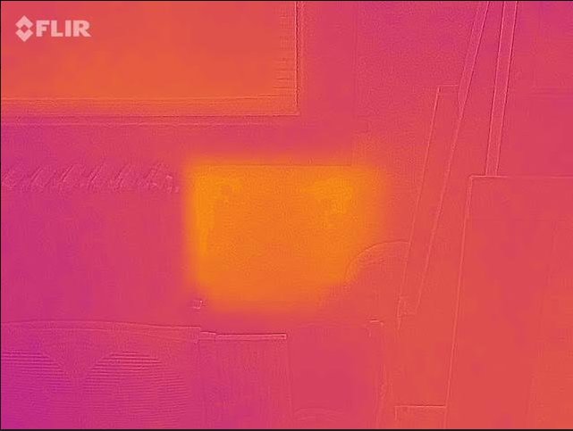

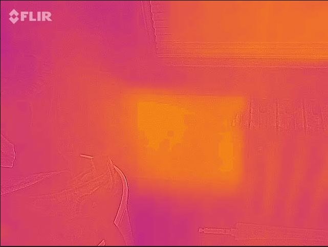

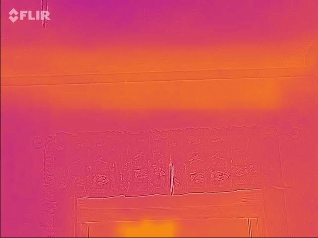

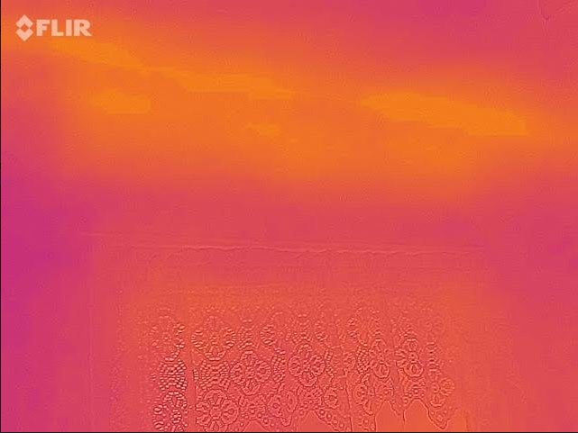

    I have an insulation question.
    Using a thermal imaging camera I discovered a few voids in the walls of my house (built in 1926).
    They are mainly above the windows and in a wall next to a radiator.
    What is the best way to add insulation in those voids?
    Thanks. :hattip:
    Bedroom #2 - above window
    Upstairs hallway - above window
    Bathroom - above window
    Bedroom #3 - wall to the left of radiator
    Bedroom #3 - wall to the right of radiator

    Is it horse hair and lathe or drywall?

    Depending on the framing style. You could do blown in small holes to patch.

    As mentioned before u could dense pack some cellulose in the wall areas by the radiators with a blower. However, for this small of an area I would go with something like this: https://sprayfoamkit.com/mobile/filling-existing-walls/
    high dollar but will save with refinishing cuz it’s a much smaller hole :)
    Those areas over the windows seem to have some air infiltration based on the focused heat source. Or maybe they just forgot to insulate above the headers and the heat is moving around the plate. In either case the foam would be a better air barrier than cellulose.
