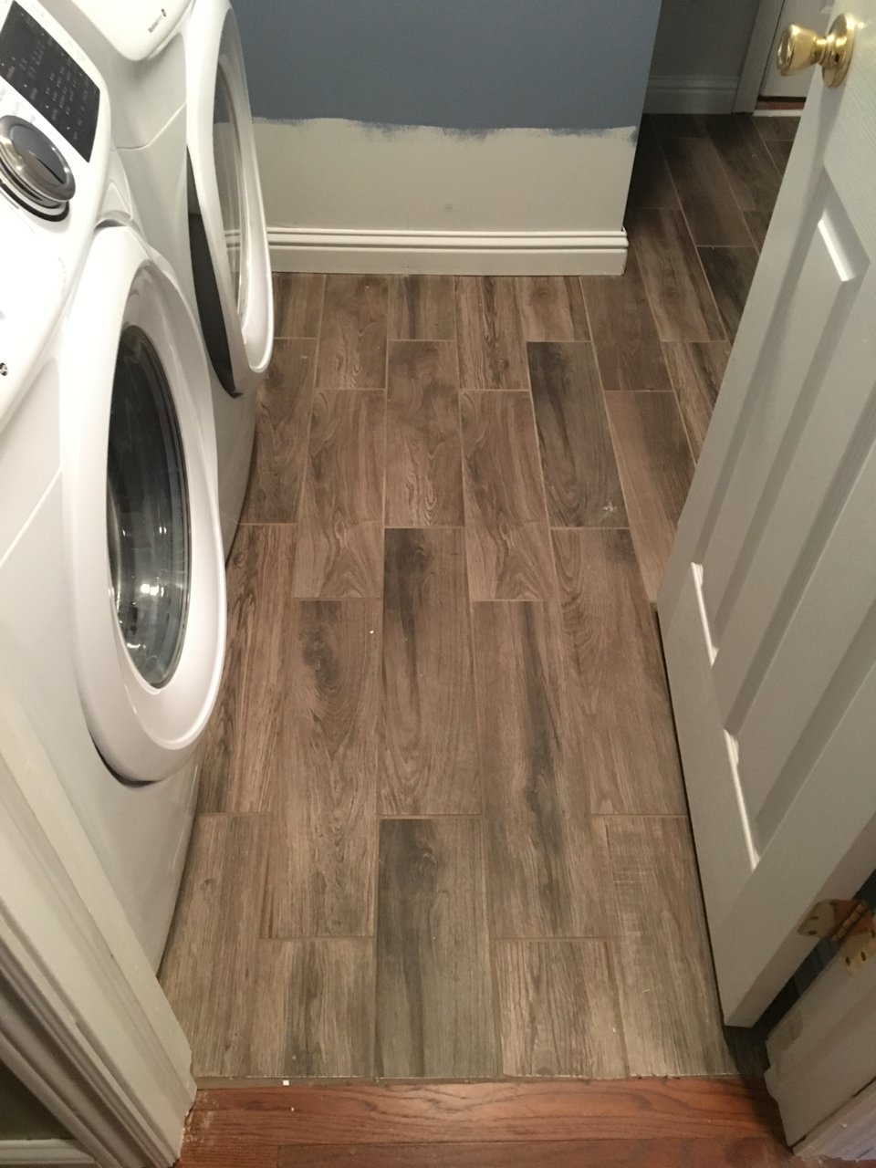

    I just installed 6x24 wood look tile this weekend
    02840603-5729-4634-A135-1E5EB6F3477C.jpg E27A3644-104C-409F-B1CC-93B58DF50AD2.jpg
    Install was on a slab, not a subfloor. One thing noticed about the tile is that because it is a long manufactured tile... the tiles tend to bow in the center.
    I noticed this as I was laying it and got a little concerned about how the tiles were lining up. Some corners were higher than others. I was really worried it was going to look a little shotty by the end but it didn’t. The grout went in well and there are very little imperfections that catch the eye.
    16”oc joists are good support. Not sure about the double layer 3/4” subfloor though. More is not necessarily better. More can equal more prenounced unlevel portions.
    I’d just see how solid and level that floor is. If its good you should be fine to lay backerboard and an uncoup membrane.
    I think as long as the floor is solid and level you will not have a problem with the woodlook tile popping or cracking.
    I’m a tile fan. I like the durability of it but if its going to be in a high traffic area with pets, pick grout color wisely. Go dark not light.

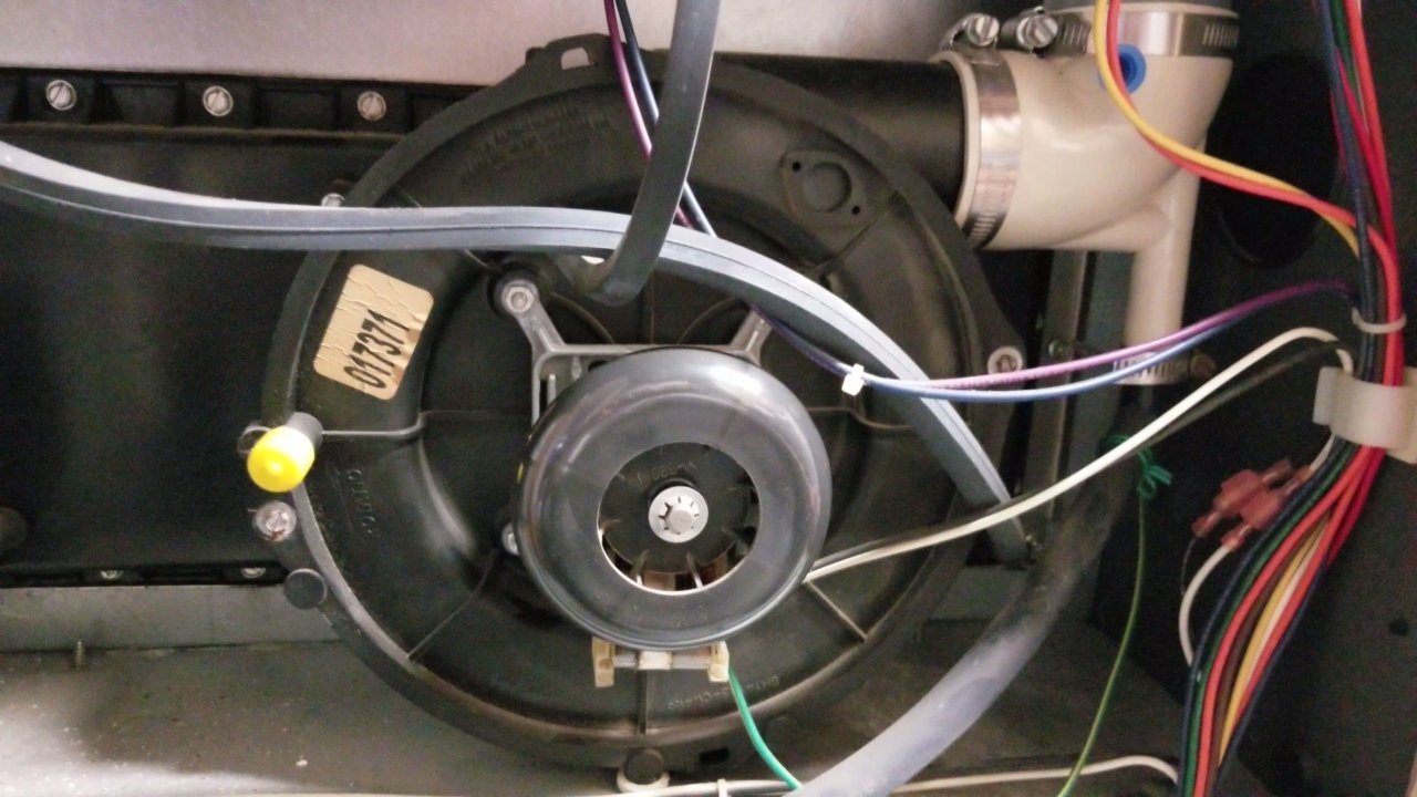

    Sort of home improvement for me. Replaced the draft inducer in my furnace . The old one's bearing was going. Loud as hell, especially at first start up. Within the last week it started squealing too. So I knew it wouldn't be long for this world. I guess I didn't realize exactly how loud it was until I put the new one in. Kind of amazing the difference.
    Old...
    New...

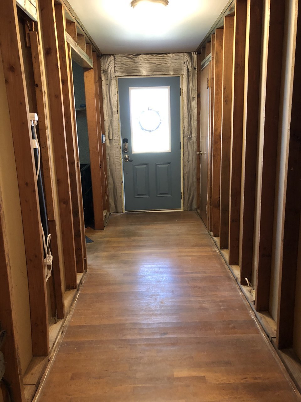

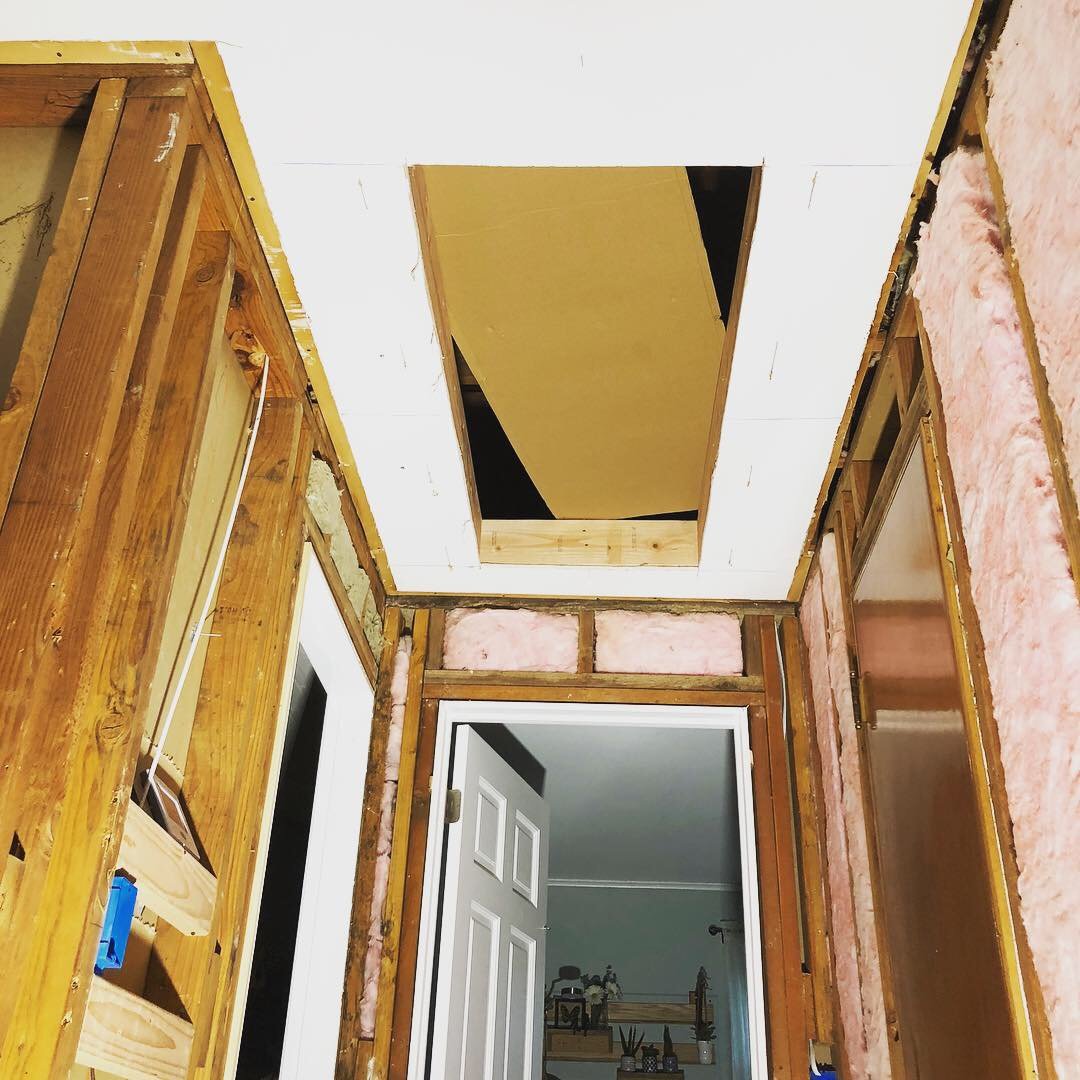

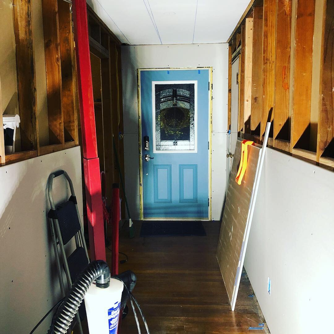

    I’ve been playing with my hallway. Replaced 2 bowed studs, new electrical, new drywall, added attic stairs.
    Finished installing the drywall last night but didn’t take any pictures yet.
    The pink insulation was used as sound deadening when I remodeled those rooms. I’ve since discovered roxul rock wool sound deadening insulation.

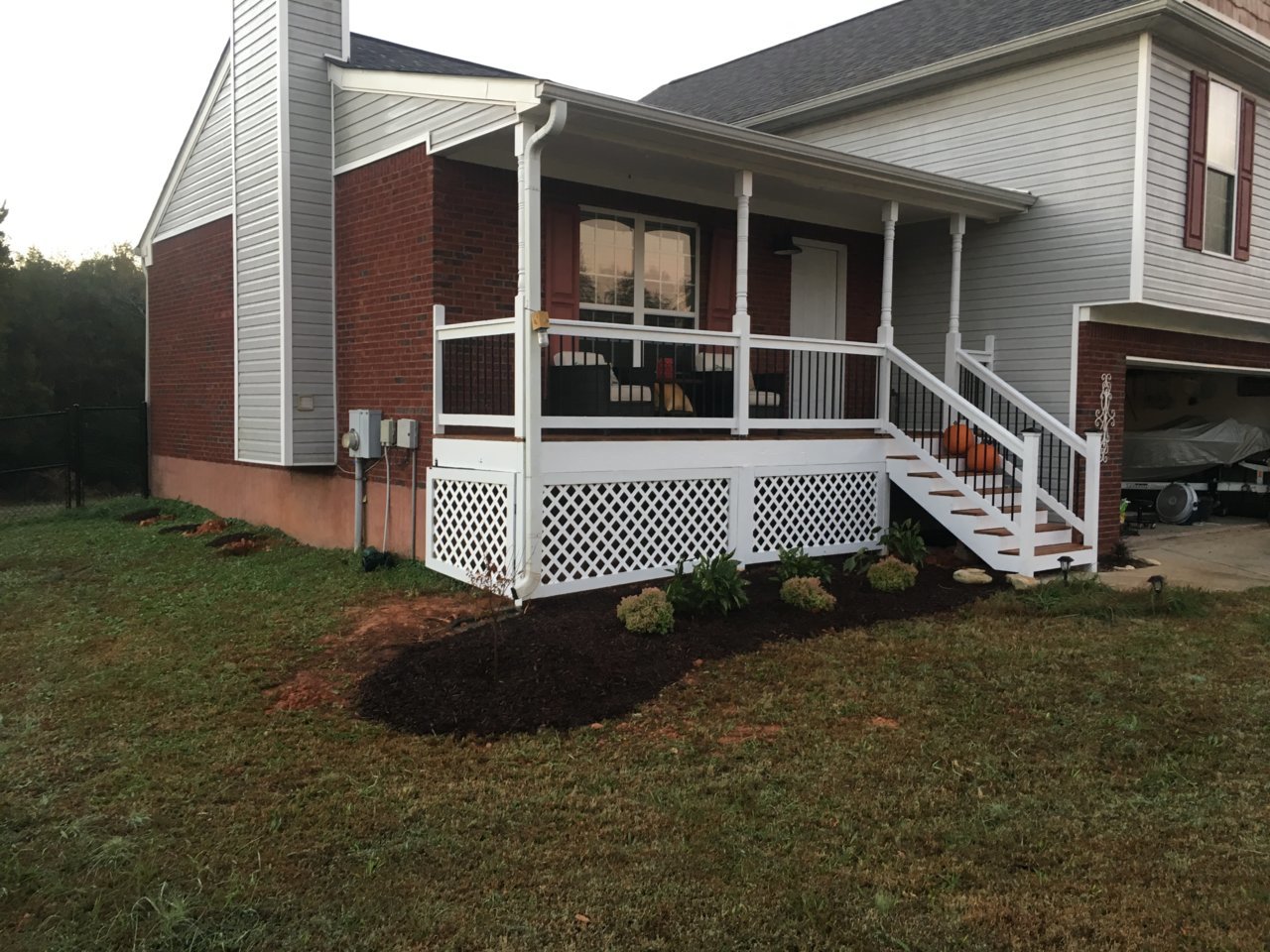

    Front porch is done. After multiple months of being put on hold I’m glad it’s complete.
    Be trap is off the porch now. Stuck out like a sore thumb.
    Next is to fix the shutter that’s falling off the brick and to figure out how a squirrel is in my wall in the inside stairwell.
