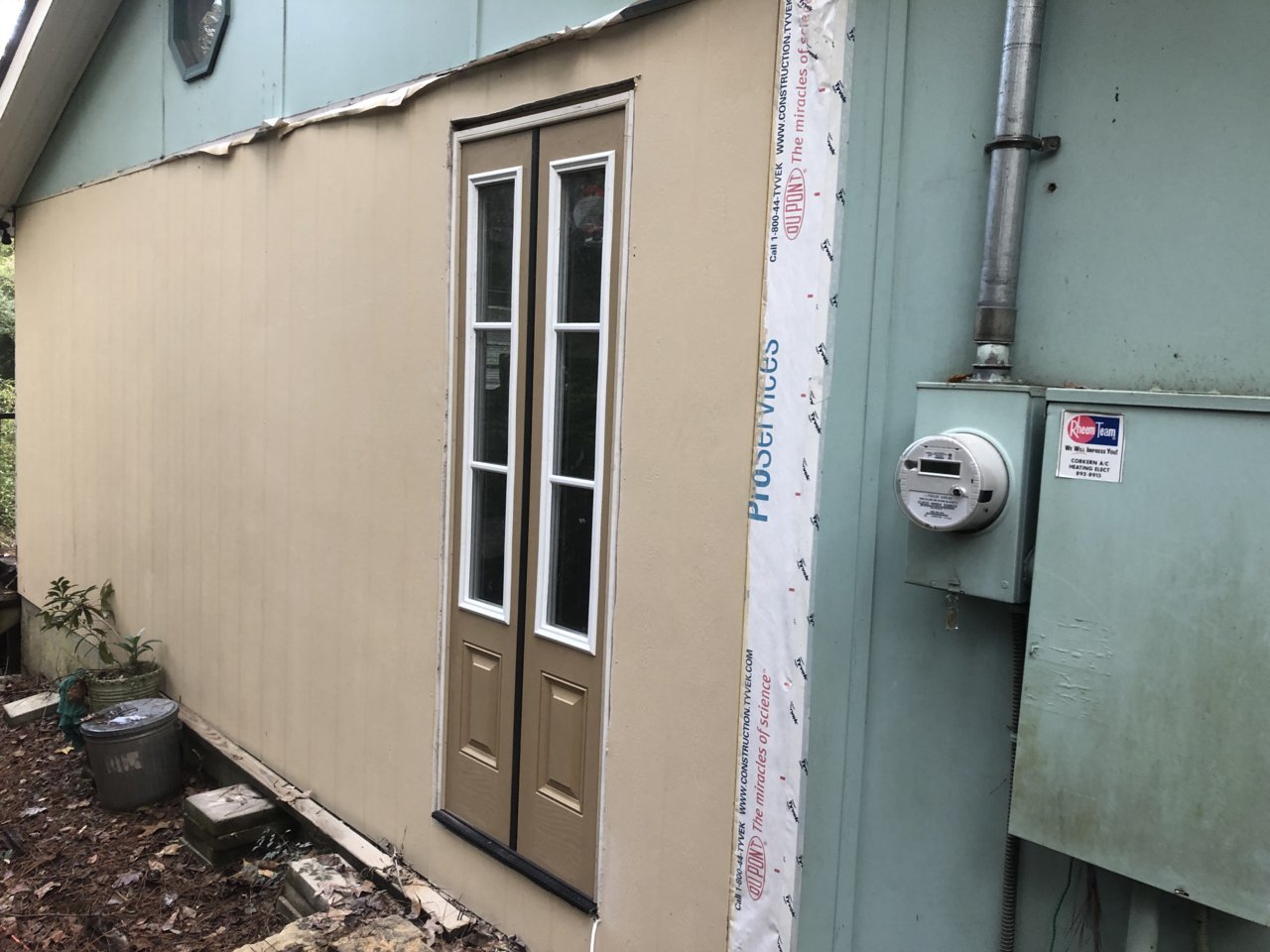

    thats just odd looking. may as well as make it operational...

    almost looks like an interior door to me

    Is that the housewrap from under the gable siding just hanging out over the lower wall siding ?

    No, it is some super thin metal flashing. I am not even sure what to do with that. The opposite side of the house is the same. You can see daylight from in the attic.
    Yeah, this "project help" is growing every time I go over there. I do feel as though our friend has been totally taken advantage of. He is a couple of months away from 80 and very activ-ish, but I think he got sold a bill of goods from his "good friends"...
    Frustrating for sure

    That whole wall is a mess

    Both end walls are the same, so I guess that is balance....
