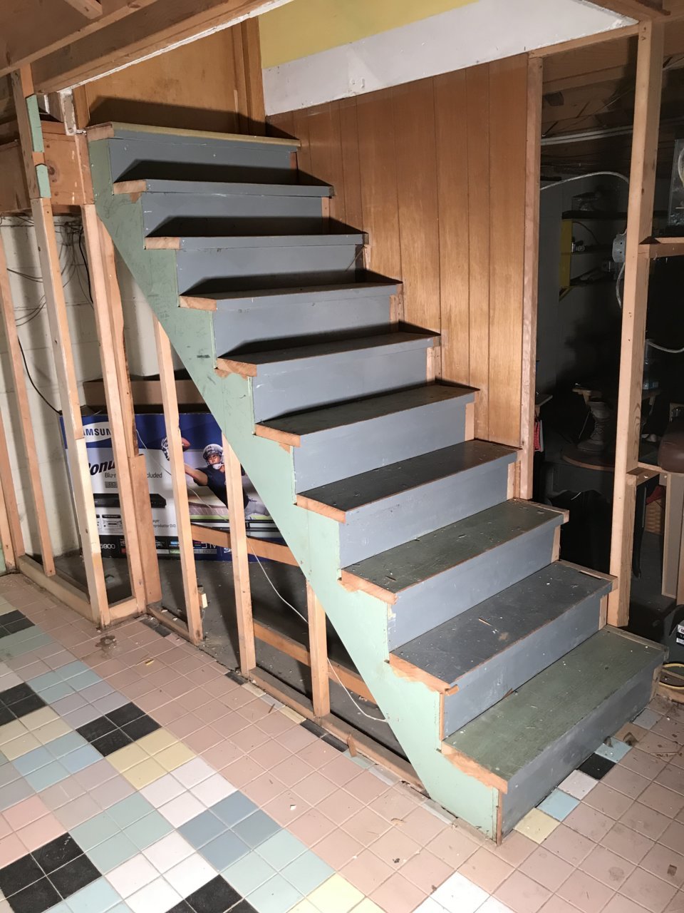

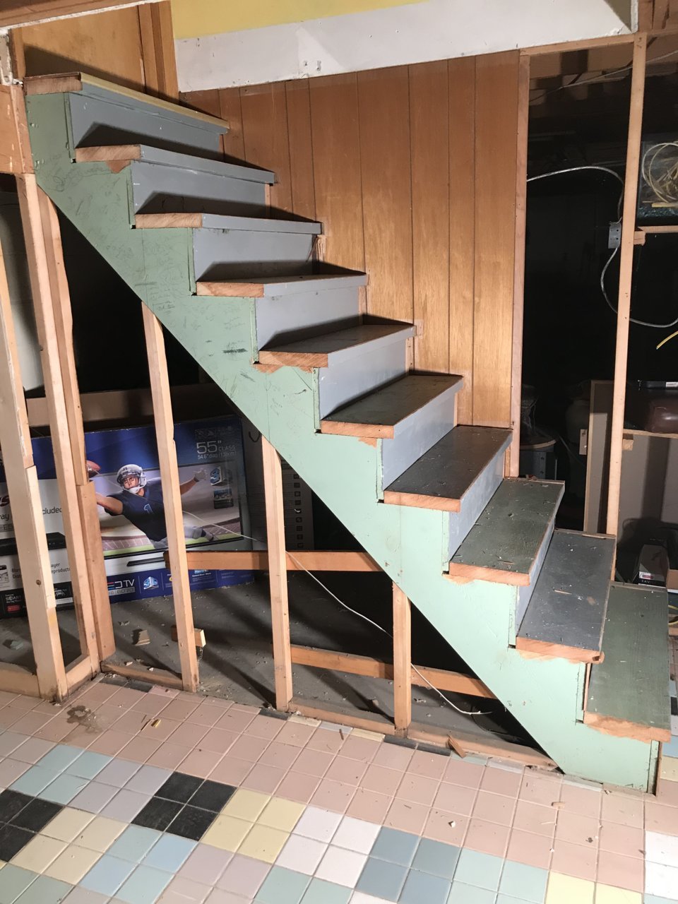

    Trying to gather some opinions on the best/easiest ways to finish the side of this staircase to not make it look like crap. Carpet will go on the stairs and drywall along the walls.

    Add on some 1” pieces to the side of the treads, have the carpet guys wrap them. That would class them up and be easy

    Add skirtboards

    Have looked into it, but I’m not steady enough and don’t trust myself to make the cuts.

    If it were me I’d cover that framing up with some drywall or t+g and just continue it up to stair treads
    Also u can do a skirt board where u don’t cut step profile out, just nail a board along pitch of stairs
