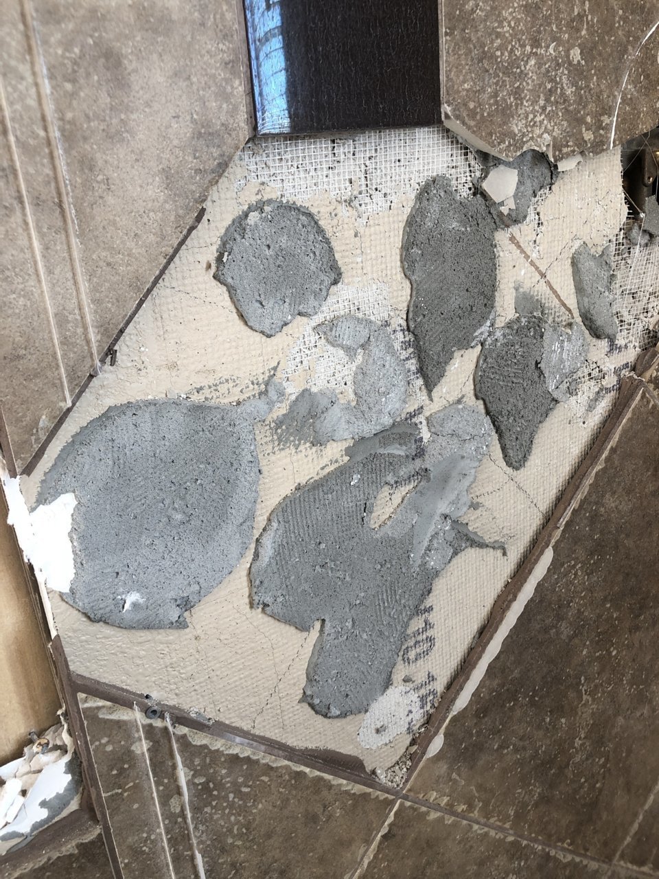

    Some of the quality craftsmanship I run into working...
