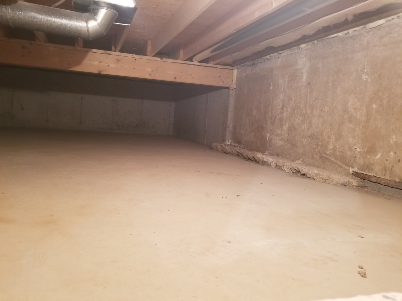

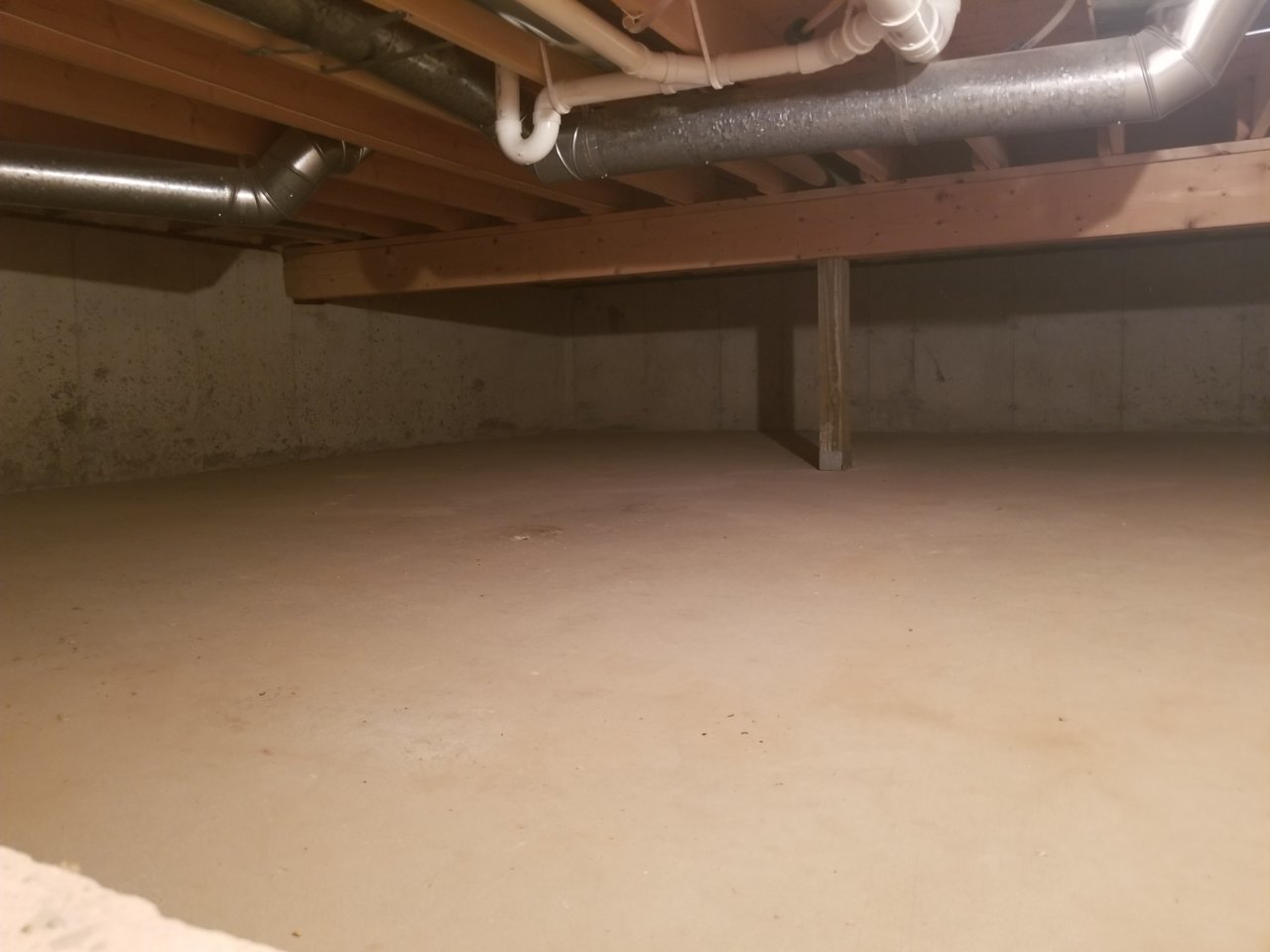

    If spray foam doesn’t float your boat for whatever reason you could definitely screw some 2” extruded foamboard on there
    Also try to seal airflow coming from crawl to basement. Spray foam wins big time here
    I would for sure insulate your water supply lines as well as your hvac supplies
    Also what is that floor in there might want to roll out a vapor barrier
    Wish my crawlspace looked that clean :)

    If you can swing it, get it spray foamed...but I'd think rigid foam would work also. I'd also insulate the flooring and cover the hvac ducts with insulation wrap. seal around where the hoses and outlets meet the ducts etc with foil tape. Support the flooring insulation with some kind of insulation holder...

    The advantage of 2lb spray foam versus rigid foam sheets is the 2lb foam will encapsulate the walls and joist ends creating an air seal and vapour barrier
    Is it a vented crawl or conditioned space?
    If its vented then air sealing doesn't matter and rigid foam is just as good

    We are near Evansville. We have a crawl space as well. Our exterior walls are insulated, batt between the joists and HVAC duct is wrapped. Floor is dirt so vapor barrier on the floor. I agree with OZ future improvement would be spray foam insulation.
