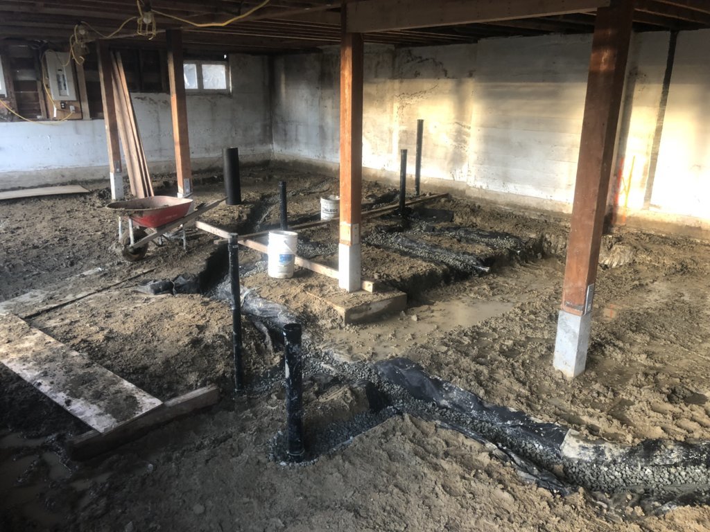

    Update on the resurrection ,
    Got our under slab plumbing installed . We lined the trenches with filter fabric and backfilled them with clean gravel so they essentially act as our low point drains . There is a section of perforated drain tile to collect the water that runs parallel to the lowest pipe and is tight piped to the exterior

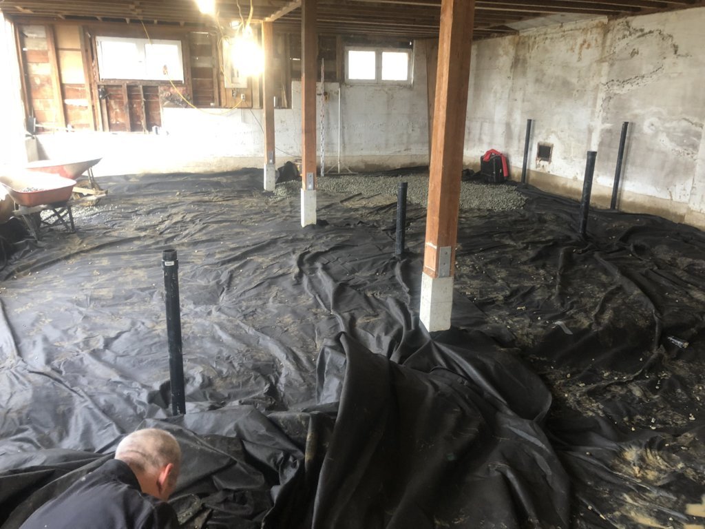

    Next up we covered all the clay subgrade with filter fabric and then a 6" layer of clean gravel was installed to act as a drainage layer

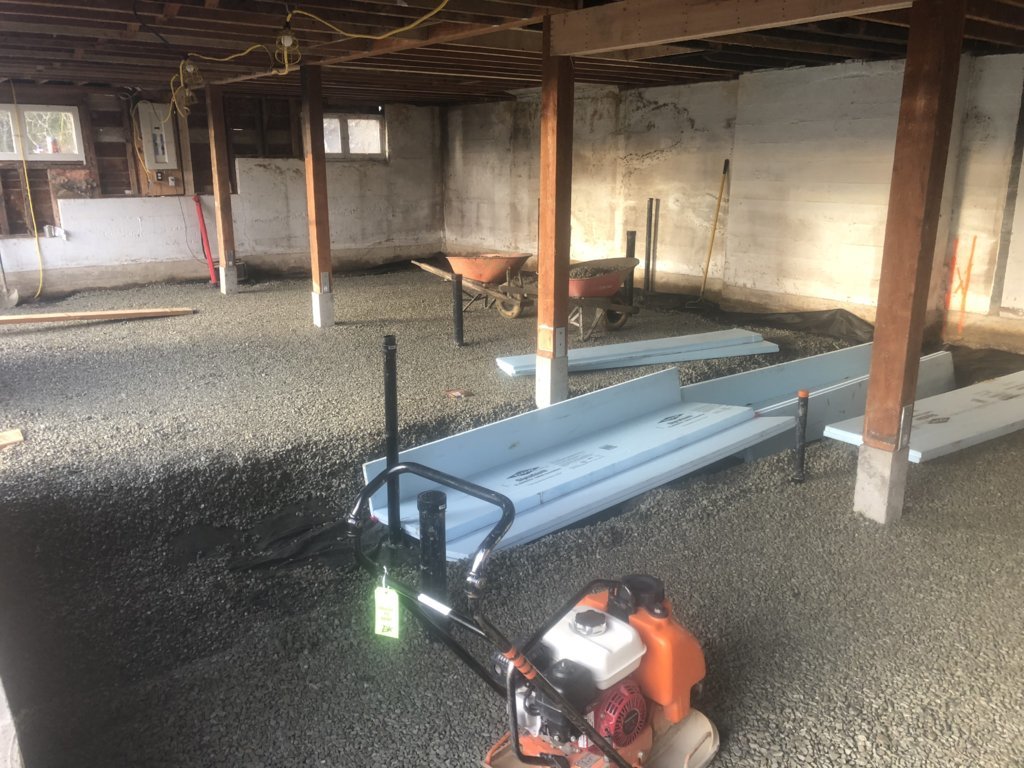

    The drainage layer fully installed and compacted

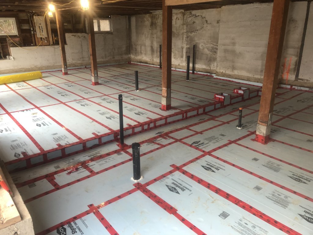

    The slab edges got a R-7.5 , 1 1/2" styrofoam thermal break and the entire interior gets a R-12 , 2.4" styrofoam layer with all edges taped

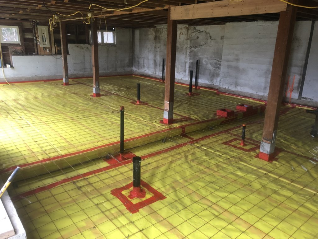

    Code here calls for a 6 mil vapour barrier under the slab and thats what we usually use but with all the water that is seeping out of the ground here I wanted to go with something heavier so we used a 15 mil Stegowrap vapour barrier .
    Finally we installed 15m rebar in the slab thickening where a shearwall will reside and 6x6 remesh throughout the rest
    We still need to chair the remesh .
    Pour set for Monday , 16 yards of 32mpa / 10 mm concrete

    I wish you had a time lapse film of your work...
